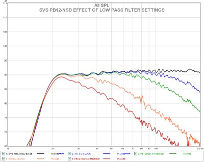

SVS PB12-NSD: Effect of Low and High Pass Filter Settings
Above is the effect of various settings of the low pass on the PB12-NSD’s response. The slope appears to be 12dB/octave and the response matched up well with the indicators on the control dial.

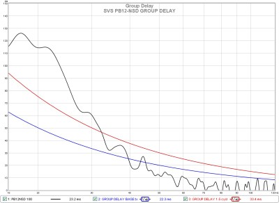

SVS PB12-NSD: Group Delay
Looking at the PB12-NSD’s response in the time domain we see that it is well behaved until below 30Hz where there is some delayed energy seen centered at the port tuning. This is typical of resonant systems with a steep high pass filter at tuning. The audibility of this at such low frequencies is debatable and the room that the subwoofer is placed in will also contribute quite a bit in this regard. I certainly never heard this in any obvious manner.

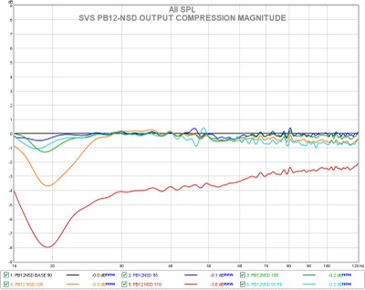

SVS PB12-NSD: Output Compression Magnitude
Above we have another way of looking at the results from the output compression test. This shows only the amount of compression of the signal that is occurring at each drive level. The PB12-NSD exhibits virtually no compression at the 100dB sweep level. At 105dB some vent compression at 20Hz can be seen but other than that the signal is largely reproduced at 100%. At the 110dB sweep level we can see that the limiting circuit has intervened and is compressing the signal heavily over the entire range so the testing was stopped at this level.
