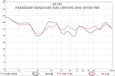

For all of the listening sessions the Paradigm Sub 2 was placed in the front right corner of the room about 4 inches from the walls. This places the subwoofer a little over 4 meters from the primary listening position. I have determined this to be the best available single subwoofer placement in the room for most units. The Sub 2 was connected to one of the 240v outlets normally occupied by a KPA2400 amplifier and this ac voltage was used for the duration of its stay. Paradigms PBK routine was run on the Sub 2 first to allow it to adapt the subwoofer response to the room. This was followed by Audyssey auto EQ being run on the system to allow it to further integrate the Sub 2 and flatten the response, which was then followed by a check and recalibration of the subwoofer and speaker levels prior to the listening sessions. Paradigm recommends running PBK prior to any other EQ or system optimization in the literature supplied with the Sub 2. For all listening the Sub 2’s internal low pass filter was bypassed in favor of a 125Hz setting inside of the Onkyo PR-SC886P.
