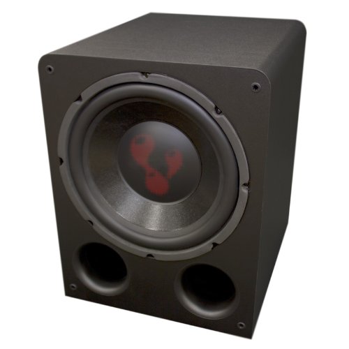

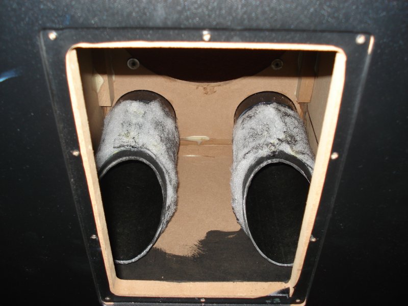

The Lava LSP12 is a bass reflex design featuring a nominal 12” driver, two 3” diameter ducts, and powered by a built-in 250W class AB power amp.  The driver is recessed into the faceplate and the two ducts, located directly beneath the driver, are part of (as opposed to bolted into) the faceplate.  All, of course, are front firing.  The power amp/control panel is bolted into the back of the cabinet. The cover comprises grill cloth stretched across an MDF frame.

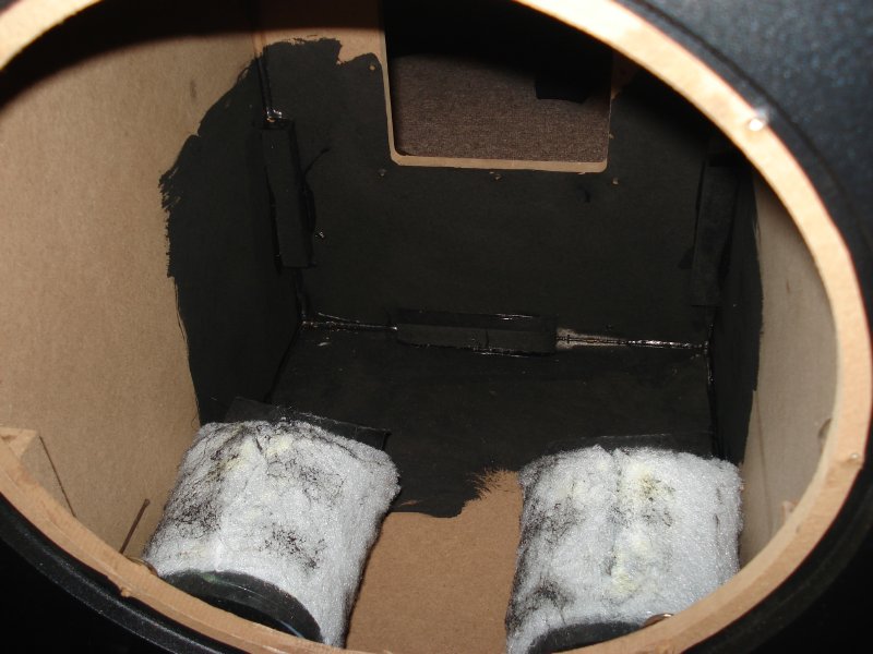

The LSP12’s cabinet is made of .75” thick MDF panels, well glued, with plenty of glue blocks in place, but no cross bracing.  The exterior of the cabinet is covered with a lightly textured black vinyl veneer. Its not a heavy -duty grade veneer, so care in handling once you’ve got the LSP12 out of its shipping cartons is in order. The interior of the cabinet is neither stuffed or lined, though the amp/driver leads and the exterior of the two ducts are wrapped. Overall, for a product in this price range, fit & finish are very good.

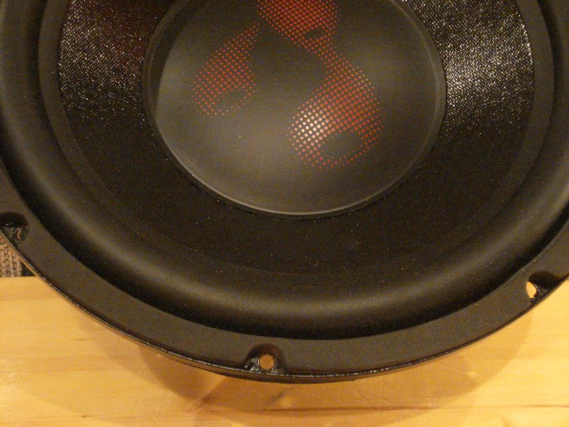

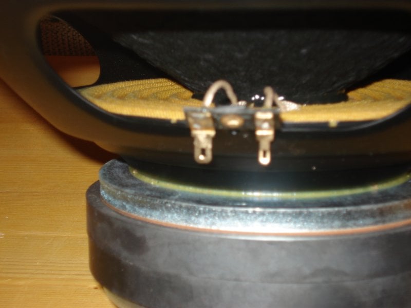

This is where Lava Subs put their money when fitting out the LSP12. The sub comes equipped with a nominal 12” driver sporting a composite cellulose diaphragm, heavy-duty butyl rubber surround, stamped frame, woven tinsel leads affixed to the spider (to minimize noise during high excursion moments) and a substantial motor structure.  The excursion capabilities of the driver were such that, the LSP12 played clean up to its respectable limits, which were substantial for a product in this price range. (See max. spl measurements below).You could push the LSP12’s gain higher and higher and eventually it would simply stop getting louder, getting progressively more distorted and annoying only at the very edge of its performance envelope.

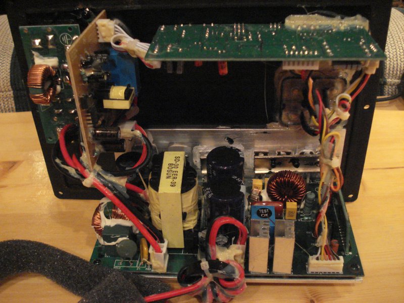

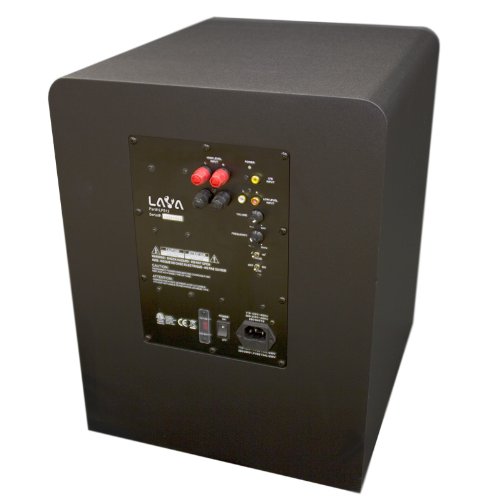

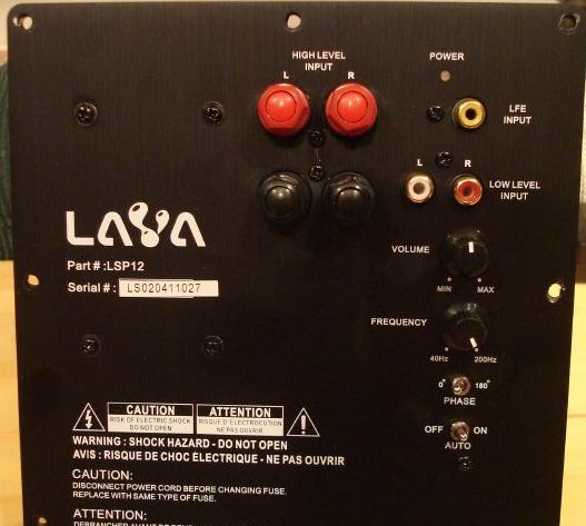

The LSP12 features a 250W rms, (500W, peak) Class AB power amp, bolted (along with all system controls) into the back of the cabinet. Control-wise, you get the bare essentials:
  • Speaker, low-level & LFE inputs;
  • continuously variable volume (gain) control;
  • continuously variable LP filter (40 – 200 Hz);
  • 0˚ - 180˚ phase control, switchable
  • Off/Auto/On control, switchable
  • Power switch, power/signal indicator light
The amp can also be switched to run on 110 – 120 Vac or 220 -240 Vac.
Noteworthy here is the care that’s been taken to seal off any air leaks around those points where wind noise could occur when the sub’s being driven hard. Also, there’s a substantial heat sink that’s bolted to the interior side of the control panel and wraps underneath the entire main circuit board. There’s also at the amp end of the amp/driver leads a ferrite placed to keep RFI/EMI noise down.
