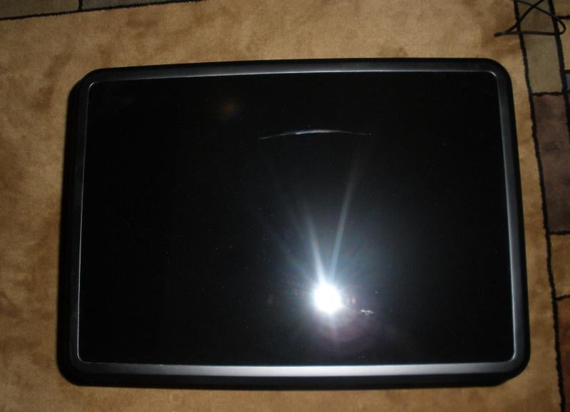

LFM-1-EXtop2.JPGOutlaw Audio has created an over achiever with the LFM-1 EX by following a proven formula. A bass reflex enclosure slightly larger than normal with a decent sized amplifier and a cost effective driver. I really don’t have a lot of negative things to comment on about it considering the total cost of the unit. The finish looked nice but did appear to be perhaps slightly uneven and had a slightly cloudy or uneven appearance to it. I thought that I detected some  panel buzz from the enclosure during the highest level sine wave sweeps but there isn’t much program material that is similar to that signal and there is also usually masking content, not to mention rattles and vibrations from the typical room or objects in it. The ports did overload and limit the low bass output some, especially in one port mode where chuffing was audible at times. Again this might be masked in a typical scenario. Perhaps if they redesign the unit they could add a few more internal braces, beef up the driver some and increase the vent area. The LFM-1 EX also does not offer a lot in the way of connectivity or user adjustment. This sort of thing does not bother me particularly but I would like to see a line out to daisy chain other subwoofers from at least.

Taken as a whole the Outlaw Audio LFM-1 EX performed very well, but when you add in the fact that it came from a subwoofer which retails for under $650 it takes on a new aspect. I have a few things that I think could be improved sure like more bracing, a little higher quality finish, more flexible amplifier connections, more substantial driver, etc, but they are understandable traits when put in perspective of the cost of the LFM-1 EX. Don’t get me wrong the Outlaw looks great and didn’t have any serious cosmetic or build flaws, but it’s not quite as buttoned up as some multi thousand dollar subwoofers, which is understandable certainly. I thoroughly enjoyed listening to the Outlaw on movie night where it really did well reproducing a very strenuous movie sound track in a large room, including some solid deep bass. It also managed to sound very natural and just plain old good with music. Not the most articulate bass ever , but quite good. I still could use more output headroom for my listening habits and room but the LFM-1 EX makes a strong case for multiples with its frugal price point. The LFM-1 EX does a lot right and makes no major mistakes all while providing huge bang for the buck value. Outlaw has knocked this one out of the park as far as I’m concerned. Budget conscious sub shoppers looking to fill a large space take note.
