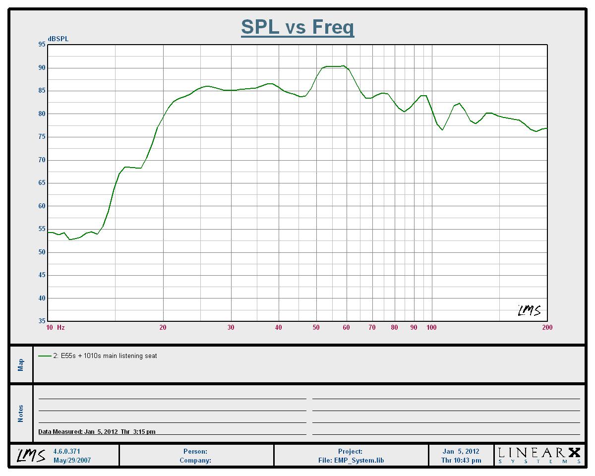

I actually put together an entire EMPtek 7.2 speaker package for my sister-in-law that consisted of 2 x E55ti towers, 1 x E56Ci center, E55Wi side surrounds, 2 x ES1010i subwoofers and 2 x RBH Sound TK-615 in-ceiling back channels. This system is powered by a Yamaha RX-A1010 A/V receiver and Oppo BDP-93 Blu-ray player. All speaker cables (14AWG x 4), HDMI and interconnects are furnished by Blue Jeans Cable. An article on this system install is forthcoming. The ES1010i's are diagonally corner-loaded (one front left corner, other right rear corner) of the room. All speakers were set to “Small” with a crossover of 80Hz, except the main E55ti towers which were run at full-range. This system was placed in a family room roughly 15’ x 20’ open to the rest of the house. So the listening space was rather large for a subwoofer of this size and output capability.
After pulling measurements at the primary listening seats, I did some quick listening tests in two-channel to make sure I achieved proper integration between the front speakers and subwoofer(s). Success. By running the E55Ti’s full-range, the system was able to produce a very full sounding bass response and seamless transition between the front towers and the subs. Although the ES1010i’s output is rather limited below 30Hz, room gain was my friend as you can see with the measurement below taken at the primary listening area.
 In-Room Frequency Response of (2) ES1010i subwoofers + E55ti Towers at the Listening Position
This measurement was pulled at the primary listening area 12ft from the front of the room. This is a very linear response achieved maintaining +-5dB from 20Hz to 100Hz. The modified ES1010i subs with longer port tubes would have produced 2-3dB more gain in the 25-30Hz region for this install, so you can expect more performance than what I was able to achieve on products shipping to actual customers.

Arguably the best of the series, Toy Story 3 delivers superb audio and video quality with a compelling storyline that just keeps you wanting to come back and watch it to reminisce about your youth. The opening scene where Woody battles the Evil Dr. Pork Chop has deep bass aplenty. From the explosion of the bridge to the rising of Rex or the soaring of the massive engines of Dr. Pork Chop’s Zeppelin, the EMP ES1010i subwoofers got a good workout and opportunity to strut their stuff. I found the bass was very meaty and at times perhaps a bit overemphasized in the 50-60Hz range which may have partly been exaggerated since I was running the E55Ti towers full-range and thus doubling up bass in this region. However this provided a lot of 'wow' effect which my sister-in-law certainly appreciated, and in her room was most definitely needed. The ES1010i did a great job of producing ample impact at sustained high output levels without mucking up the experience. Had it not been for my reference of hearing this scene on higher caliber subs, I wouldn’t think the EMP’s were missing a beat, but in reality, there wasn’t as much tactile response as I was used to hearing. This is nothing surprising given the size and price of this subwoofer. In fact, I’d say it’s pretty par for the course from other products of similar stature that I’ve reviewed in the past. If you want meaningful output below 25Hz, it’s gonna cost you in enclosure size and price and often aesthetics (unless you’re willing to pony up some extra coin for a premium finish and contoured shaped cabinet).
