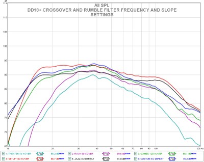

Velodyne DD18+: Effect of Low and High Pass Filter Settings
Above is the effect of various setting of the low pass and rumble filters on the DD18+’s response. There is quite a large amount of adjustment available with just these two settings.

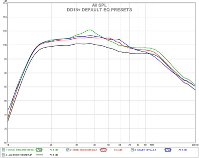

Velodyne DD18+: Effect of Movie EQ Preset
Above is the basic response of the preset EQ curves available from the factory. Most of them appear to add an overall signal boost. The theater setting adds a slight peak near 35Hz which seems to have a higher Q than one would expect. The Games preset adds a little boost to the 60Hz region.

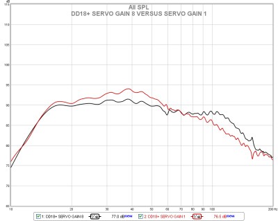

Velodyne DD18+: Basic Frequency Response as Tested
In the chart above is the basic response of the DD18+ at the two different servo gain settings. The red trace is with the servo gain at its lowest setting of 1. The black trace is with the servo at its highest setting of 8. As can be seen the maximum setting of 8 produces a flatter more extended response while the lowest setting of 1 produces a more rolled off and humped up response. The servo seems to be forcing the unit into a flatter response shape at the highest setting whereas the lowest setting is probably closer to the actual driver and enclosure response combination. Velodyne specifies the DD18+ as 14.4-120Hz +/-3dB and 8.8-300Hz overall with no tolerance given. With the servo gain setting at 1 the DD18+ only fits within a 6dB window from 14.6-70Hz. If the window is expanded to 10dB total the response fits in from 13-109Hz. With the servo gain at its maximum setting the DD18+ response fits within a 6db total window from 13.5-126Hz which is slightly better than Velodyne’s specification. Within a 10dB window the response is 12-150Hz. I suspect that this configuration is what Velodyne specs their response from. By 300Hz the response is about 20dB down and probably unusable regardless of the setting.

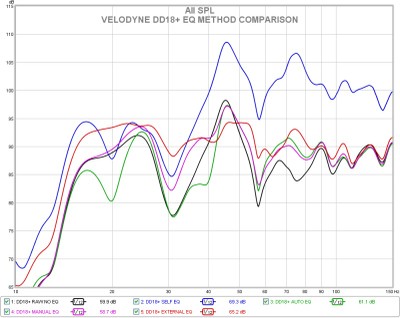

Velodyne DD18+: Internal EQ Results
In the above graph we have the results of equalizing the DD18+ in room. The black trace is the raw response in room as measured by my reference Earthworks M30 which as you can see is not very good to begin with and requires some taming being +/-10dB from 14-150Hz. The DD18+ was run through each of its equalization schemes to check the effectiveness and results with the Velodyne microphone in the same exact position as the M30 with the elements about ¾” apart. The result for the Self EQ scheme, which is the blue trace in the graph above, was very strange resulting a dramatic boosting of the upper range and an actual worsening of response to +/-12dB 14-150Hz. Next the Auto EQ routine was tried. This had better results than the Self EQ option but still wasn’t very effective. The worst response issue the 12db peak at 45Hz seemed to be ignored and some smaller cuts were made at 20Hz and 40hz. The resulting response was barely improved and fit within a +/-9.9dB window from 14-150Hz. Next the manual EQ option was attempted. This method allows you to manually adjust the EQ settings while the Velodyne on screen display shows the result on the response. This method had the best result and is represented in the pink trace on the graph. The response was improved to +/-7.5dB 14-150Hz using the manual EQ method. Finally I decided to see what equalizing with my regular unit a Behringer DCX2496 would do. This is the red trace in the graph above and is +/-3.7dB from 14-150Hz.
During the process of using the on board equalizer and display of the DD18+ in conjunction with my regular measurement system I noted that the frequency response plot shown inside of the Velodyne software looked much better than what my manual measurements did and also more curiously that some of the features appear to be shifted. I have provided an example below.

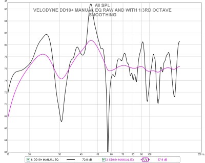

Velodyne DD18+: Software Response Shown Versus Actual Measurement
The above 2 charts show the measured response of the DD18+ with some manual equalization applied. The top graph in the bottom picture is frequency response as reported inside of the Velodyne software. It is showing a response variation of +/-2.5dB, or a 5dB total window from 15-200Hz. Any audio fanatic would be proud to have that response. The picture above the Velodyne chart is what my reference measurement system reported the DD18+ response as. I have scaled the 2 graphs as closely as possible for comparison. The black line is the raw measurement from the M30 with no smoothing and the pink trace is the same measurement with 1/3rd octave smoothing. Looks rather different eh? The black trace is +/-13.4dB from 15-150Hz. Even with 1/3rd octave smoothing the pink trace is still +/-6.4dB over that range. I had thought that adding the smoothing would better reconcile the two but it still doesn’t match up that well. Even more curious is the fact that many of the main features from the two measurements do not seem to match up. The Velodyne chart indicates a dip at 45Hz instead of the obvious peak. Again at 30Hz there is a bulge in output instead of a dip. Down below 20Hz the Velodyne software indicates a rising response, but my personal rig indicates a large drop off. Very odd indeed. I’m not really sure what to make of this. It almost seems as if the response as reported on the graph inside of the Velodyne software is offset ½ of an octave. Again both microphones were in the same position within ½” of each other. Certainly there can be differences attributable to the different test signals used and the way the data is presented but these seen here are rather large. If you do use the internal EQ of the DD+ series the manual method is by far the best option in my estimation.

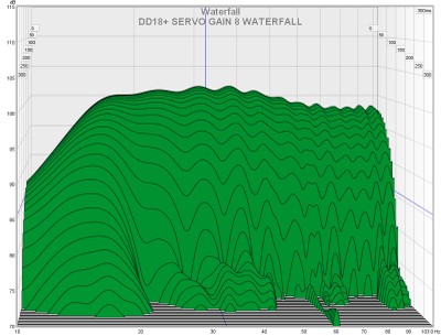

Velodyne DD18+: Waterfall Decay

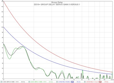

Velodyne DD18+: Group Delay
The response of the DD18+ in the time domain is rather uneventful and about as expected. There is clean decay across the full range until about 16Hz where there is a moderate increase due to the boost EQ being employed to extend the response and the corner of the high pass filter. Still it never breaks 1 cycle of delay even below 20Hz. There is negligible difference in this performance metric whether the servo gain is set to minimum or maximum.

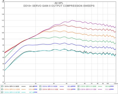

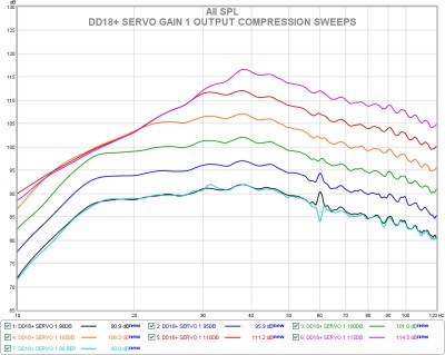

Velodyne DD18+ Servo Gain 8: Long Term Output Compression
Velodyne DD18+ Servo Gain 1: Long Term Output Compression
The maximum long term output compression test for the DD18+ with the servo gain set to minimum and maximum both are presented above. Overall despite the response shape differences there is not much difference. Compression and output limiting kicks in first at about 16Hz where the response is being boosted the most and expands progressively from there as the output is increased and the subwoofer reaches the maximum output level that it can produce as configured. The output does not start compressing notably until the 105db sweep level. By the 115dB sweep level the deep bass is being limited heavily everywhere below 30Hz.
This is by far the most demanding test conducted on the subwoofers during testing and will reveal any issues with overload, port compression, port noise, driver distress, creaks, rattles, buzzes, etc. Additionally this is outdoors with just the subwoofer operating so there are no nearby walls or objects to vibrate and no upper frequency masking content from other speakers that would cover up or mask any noises from the sub. Any sort of audible issues with the subwoofer will be readily apparent. The most offensive noise that the DD18+ produced was a very slight warming to the tone in the deepest bass indicating increased distortion from high excursion of the driver. In room with other speakers operating and actual content this would probably never be noticed. That is it. Most subwoofers do start making obvious bad noise at some point. This subwoofer is as stable and composed as I have seen. It simply quits getting louder before it ever makes objectionable noise.

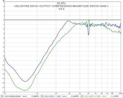

Velodyne Digital Drive Plus 18 (DD18+) Subwoofer Measurements Cont.
Velodyne DD18+: Output Compression Magnitude
Above we have another way of looking at the results from the output compression test. This shows only the amount of signal compression occurring during the nominally 115dB sweep level for both the minimum and maximum servo gain settings. The lowest servo gain setting appears to have advantage here but this is deceptive due to the flatter response of the highest servo gain setting producing higher output at the frequency extremes at the same basic sweep level. This is because the sweep level is referenced to 50Hz. In reality the difference is very small to nil.
Velodyne DD18+: Maximum Long Term Output Level
Looking at the maximum long term output achieved for both the minimum and maximum servo gain settings shows that the output headroom is virtually identical below 30Hz. There appears to be some difference above that point but this is again probably deceptive because the response shapes start out differently. The 2 curves would likely converge further if an even higher input level were used.
