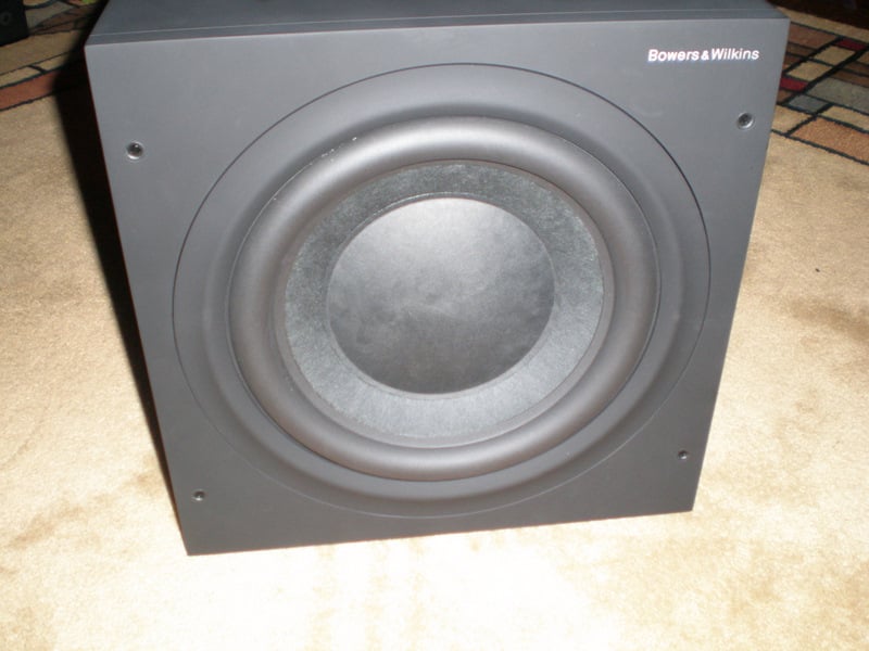

When the ASW 610XP arrived I immediately noted how small and light the box was. Opening the box and starting to unpack revealed well thought out and implemented packaging with thick protections at the top, bottom and also corners of the sub. Contained in the box is: The subwoofer, grill, owners manual, warranty card, power cord, and an accessory pack containing a choice of either spikes or white plastic feet, both of which thread into the bottom of the enclosure.
The ASW 610XP is tiny! At 12.8”x12.8”x14.8” it occupies barely 1.4 cubic feet of volume in a room and weighs a mere 34lbs. The ASW 610XP takes the title of smallest and lightest subwoofer I have ever tested away from the Klipsch SW-311 that was reviewed here a short time ago. The finish is the first of its kind that I have seen on a speaker. It is a dark gray color which is called matte black by B&W. It has an almost rubbery or tacky texture to it. Sort of like the rubber that you might encounter on some iPod or cell phone cases. It is soft to the touch and creates a lot of traction or surface friction. I really like the finish but the one thing that I noted about it is that any moisture will leave visible marks on the finish that do not just wipe off. Even having some oil on the skin of your hands when you move the sub will produce this. You might think “Why would I be touching it or moving it more than once or twice?”, or that you don’t plan to sit drinks on it and that is probably true but it was something that I noted. Either way it is a different finish from the usual. This is one sub that will be very easy to find a place for or move when needed and it easily ace’s the test for spousal acceptance factor.
Design Overview
B&W’s ASW 610Xasw610front.JPGP is a sealed design with a 10” forward firing driver and a 500 watt rated class D amplifier. There is internal EQ used to extend the deep bass response of the subwoofer and a couple of different presets available to tailor the response to suit the room or the listener preference. The plate amplifier has RCA type unbalanced connections as well as speaker level connections. There is also a 12v trigger input. There is no option to send a signal from the ASW 610XP further down the line to other equipment.

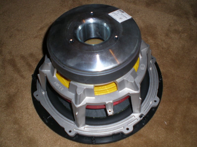

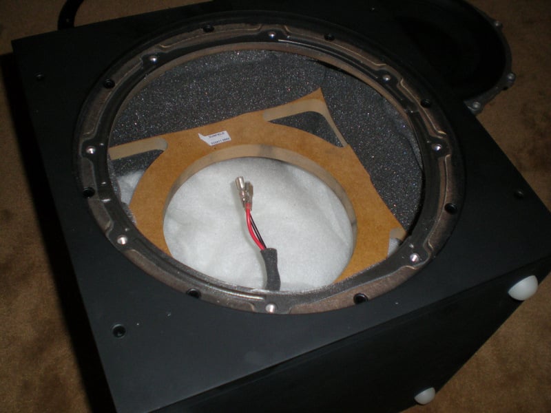

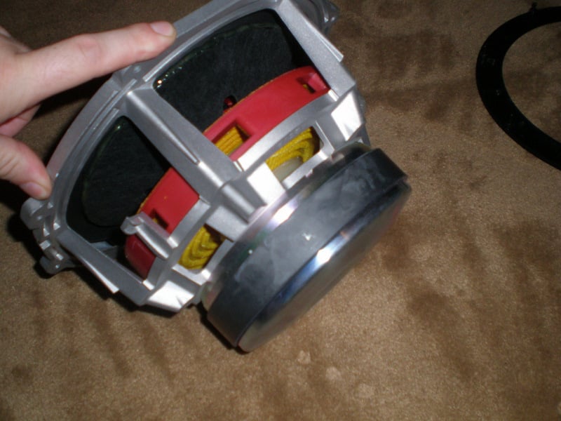

 After popping off the trim ring, which covers the frame and mounting screws for the 10” driver employed in the ASW 610XP, so that it could be removed from the cabinet, I could see that it is a rather high quality unit. B&W lists the cone as a Kevlar, paper pulp and resin mixture. The surround is a rubber half roll and the frame is a very open, six spoke, cast aluminum design with an oddly shaped mounting flange. The driver makes use of 2 generously sized spiders separated by a plastic spacer. The cone also has venting underneath of the dust cap. The motor utilizes a single roughly 6” diameter, 1” thick ferrite magnet sandwiched between the top plate and the back plate. The back plate is moderately bumped to provide voice coil clearance and features a large 2” diameter pole vent with 3 smaller vents which are probably for the gap. The voice coil appears to be a 3” nominal diameter and the leads are sewn into the top spider. This unit exhibits very nice parts quality and attention to design.

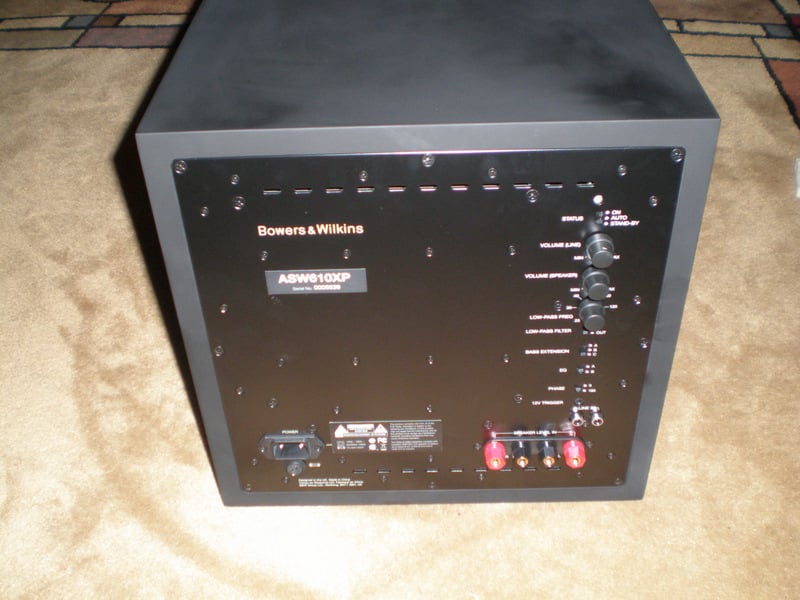

The amplifier for the ASW 610XP is rated at 500 watts and is listed as class D. It occupies virtually the entire back panel of the enclosure and has controls for most of the functions found on a typical powered subwoofer: Phase, gain, low pass, auto/on/standby, etc…Plus a few extras, namely the switches to control the EQ contour and extension settings. When I removed the amplifier from the enclosure I noted that the amplifier has a sealed chassis and also has its own sub-enclosure within the main enclosure. I did not take the extra step of removing the chassis cover from the amplifier to get internal pictures of the amplifier components and circuit layout. During the review process and measurements session I would occasionally check the amplifier to see how hot it was getting and it never seemed to get much more than warm to the touch throughout.
Construction of the ASW 610XP’s enclosure appears to be ¾” MDF. There is a large window brace in the center of the enclosure that appears to double as a brace for the motor of the driver and also a full panel further back in the cabinet to separate a chamber for the amplifier. There is dampening foam on top, bottom and both side walls internally. There is also a large chunk of poly fill directly behind the driver. All of this combined with the very small enclosure panel sizes results in a very inert and dead enclosure. The driver and amplifier are both flush mounted. The driver has a trim ring which snaps in over top of the mounting flange. Overall parts quality, build quality and attention to detail are very high.

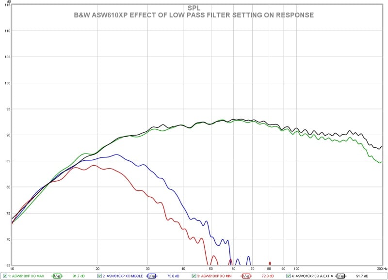

B&W ASW 610XP: Effect of Low Pass Filter Settings
A measurement was taken of the ASW 610XP with the low pass crossover bypassed using the LFE input and at maximum, middle and minimum settings to observe its effect on the response shape. This is presented in the graph above. The middle, 12 o’clock setting of the crossover resulted in a very low XO point of roughly 30Hz. The minimum setting produced what appeared to be a 25Hz XO point which is of little use. Most of the effectiveness of the control is in the top 50% of the knobs rotation. There was little difference between the response with the low pass filter bypassed and with it at maximum.

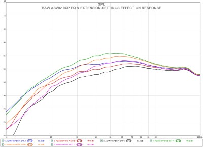

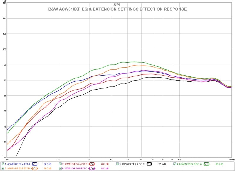

B&W ASW 610XP: Effect of Extension and EQ Settings on the Response
Above are the measurements of the effects of the ASW 610XP’s extension and EQ settings. With the 2 EQ curves and the three extension settings there are a total of 6 combinations. The results of each combination to the overall response are relatively modest and mostly consist of a slight boosting of the 30-80Hz region, or extending and boosting the low bass below 30Hz.

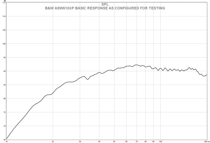

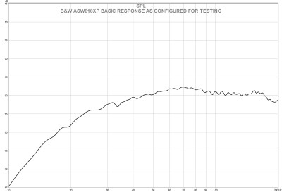

B&W ASW 610XP: Basic Frequency Response as Tested
For the rest of the measurements I settled on using the ASW 610XP with the extension on the C setting and the EQ on the A setting. This provides a response that is rolled off towards the low end but should lower the power demands on the amplifier due to less total EQ boost being applied and should allow the subwoofer to use more of its upper range headroom for some of the tests before becoming limited in the low frequencies. In this configuration the response is within +/-3dB from 27-200Hz. This is very close to B&W’s spec of 25-140Hz +/-3dB. The flattest combination was with the A EQ and A extension settings. In that configuration the ASW 610XP was within a +/-3dB window from 20-200Hz easily exceeding spec. These response shapes are at the base starting drive level used for testing which is referenced to 90dB at 2 meters from the microphone at 50Hz. At higher levels the output will compress and the response shape  deviates.

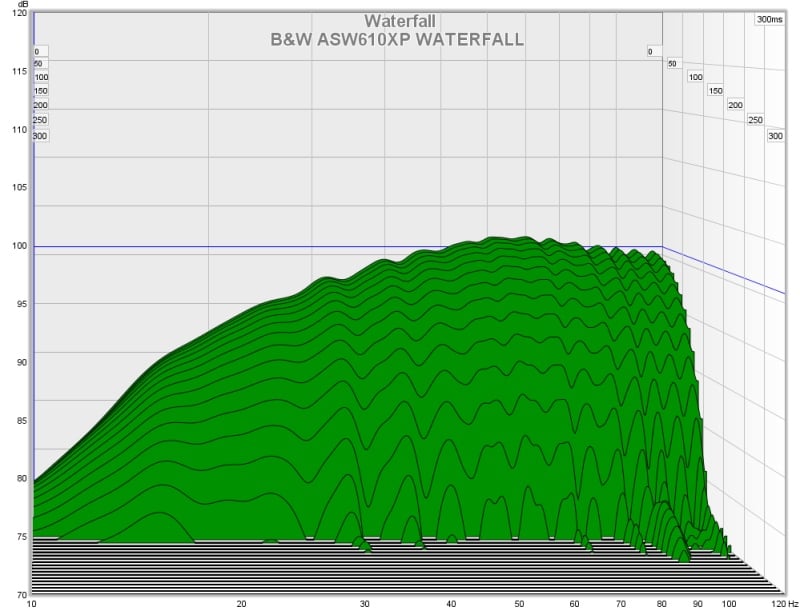

 B&W ASW 610XP: Waterfall Decay

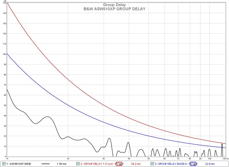

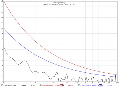

B&W ASW 610XP: Group Delay
The waterfall and group delay plots for the ASW 610XP are very good and show little to no delayed energy and certainly nothing that would be audible. The group delay never exceeds one cycle.

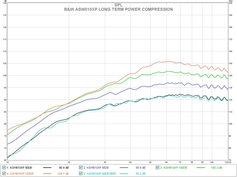

 B&W ASW 610XP: Long Term Power Compression
The results of the long term power compression sweeps show that the ASW 610XP maintains good linearity up through the 95dB nominal sweep level. During the 100dB sweep there is some compression apparent near 20Hz. During the 105dB sweep the output is being limited severely everywhere below 45Hz.

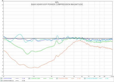

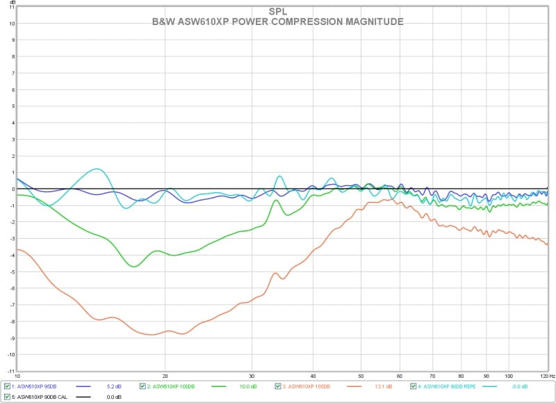

B&W ASW 610XP: Power Compression Magnitude
Looking at the amount of compression exhibited only it can be seen that the ASW 610XP does very well above 45Hz all of the way up to and through the 105db nominal sweep level. There is a large amount of compression evident on the 100 and 105dB sweeps in the deep bass. The centering of the compression at about 20Hz is an indicator that this is likely to be the center point of the built in EQ used to flatten the ASW 610XP’s response.

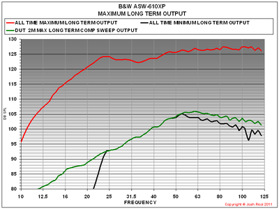

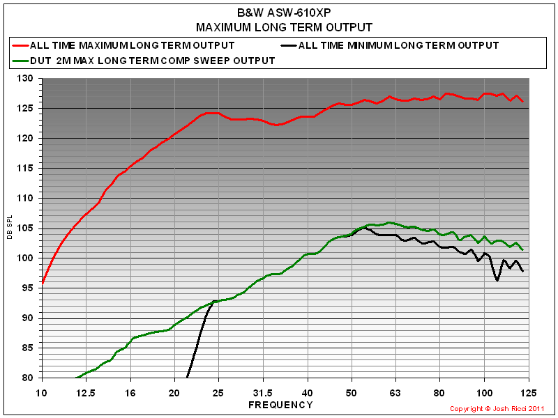

 B&W ASW 610XP: Maximum Long Term Output Level
The maximum long term output achieved by the ASW 610XP during the power compression testing is at the low end of all subwoofers that have been measured up to this point. Over a significant range from 24-53Hz it has the lowest maximum output recorded. The resulting response shape of the 105dB nominal sweep fits within a +/-5dB window from 30-120Hz.

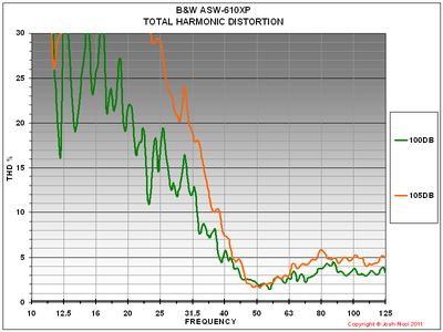

 B&W ASW 610XP: 100, 105dB Sweep THD Comparison
The ASW 610XP distortion results during the 2 highest level power compression sweeps are shown above. Overall this is not a bad showing. The behavior is best above 35Hz where it remains well below 10% THD. Below 30Hz the distortion starts to increase rapidly which is not uncommon. With a single 10” driver in a sealed alignment there won’t be enough sub 30Hz output to be of note anyway.

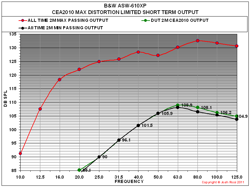

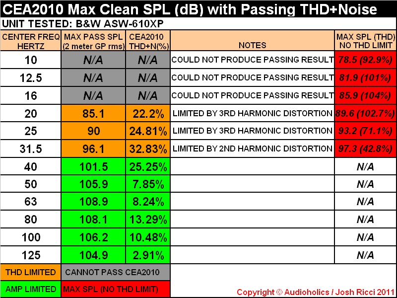

B&W ASW 610XP: CEA2010 2 meter Groundplane RMS Results
B&W ASW 610XP: CEA2010 2 Meter Groundplane RMS Comparison
CEA2010 Results
The CEA2010 maximum passing results for the ASW 610XP show that the design is amplifier limited at the 40Hz band and above. From 20-31.5Hz it is distortion limited and would produce a bit more output if distortion levels are ignored completely. At 20Hz the ASW 610XP could produce a passing result of only 85.1dB. Below 20Hz the ASW 610XP could not produce a passing result. The maximum CEA2010 passing output is the lowest of any subwoofer that I have measured yet at the 25, 31.5, 40 and 50Hz bands. It is very near the bottom at the rest of the 1/3rd octave centers as well.
