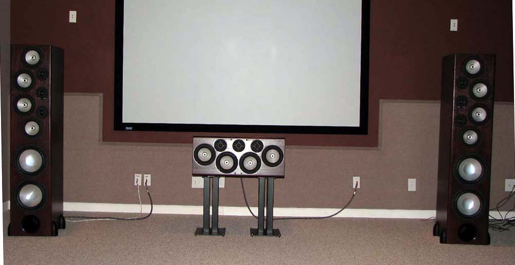

System PicMoving around nearly 200lbs of 5-foot tall speaker isn’t exactly child’s play. I suggest NOT inserting the spikes or any accessory feet until you know exactly where you want them placed. Speaker placement depends a lot on room dynamics and listening preferences. If you want a speaker to have pinpoint imaging you typically place the speakers closer together. If you prefer a larger soundstage with broader imaging across the whole listening area spreading the speakers further apart usually does the trick. Since my goal with home theater is to try to make every seat a good seat I chose the latter with a slight toe in. Though these speakers normally require little or no toe-in because the tweeter array is located on the inside edge of the baffle, I found in my room a slight toe-in did help increase midrange focus and overall improved imaging. I have found, in acoustically treated rooms such as mine, that you typically need a slightly higher degree of speaker toe-in than would normally be required in untreated rooms. Experimentation is always recommended in this regard.
I personally don’t subscribe to the “Golden Triangle rule” that dictates the speakers should be placed equidistantly apart from the diagonal distance of each speaker to the listening area. I find this usually positions the speakers too far apart, requiring drastic toe in which can cause the speakers to sound overly bright or can greatly compromise the imaging. It’s always a good idea to check with the manufacturer for speaker setup recommendations as a starting point.
After consulting with Shane Rich, Technical Director of RBH Sound, I was informed that because of the broad dispersion capability of the T-30LSE system the speakers can be placed a little further apart than a typical speaker system. For instance, if you place the speakers 10 feet apart you want the primary listening position to be about 11 feet from the plane of the speakers (not the diagonal distance of each speaker to the listening area). Of course the room will somewhat dictate what the optimal distance between the speakers will be. A good balance between the speaker’s proximity to the side walls of the listening room and the distance to the listening position should be maintained if possible. The bottom line is this - if you spend some time setting these speakers up they can disappear into the soundstage much the same way a smaller speaker will.
When I placed the speakers too closely together the imaging became pin-point at the center of the first row, but was a bit lacking and just didn’t come together well in the back row. If I placed them too far apart the soundstage lacked focus in the front row and sounded too broad in the back row. Applying too much toe-in made the speakers too lively. I found the best positioning for each speaker to be 4feet from the back wall and about 1 ½-feet from the left side wall for the left speaker. The speakers are about 12-feet apart, and the first row of seating is 15-feet from the plane of the speakers with about ½ “ of toe-in for each speaker. I used a laser pointer to help me guide the degree of toe-in for great precision. I settled on the point where each speaker’s tweeter baffle shined a point just on the outer edge of its respected seat in the back row. This allowed for a well focused and immensely large soundstage for both rows of seating.
After you have achieved the proper speaker placement for optimized sound in your seating area it’s time to apply the floor spikes or outriggers to better couple them to the flooring and increase bass impact and detail. I used the supplied spikes from RBH, which do the job nicely. If you have hardwood flooring I’d suggest inserting a coin below each spike to avoid damaging the floor’s finish. Remember from basic physics that Pressure = Force / Area, thus each spike presents about 500 psi to the flooring, which will easily puncture and ruin any hardwood flooring.
