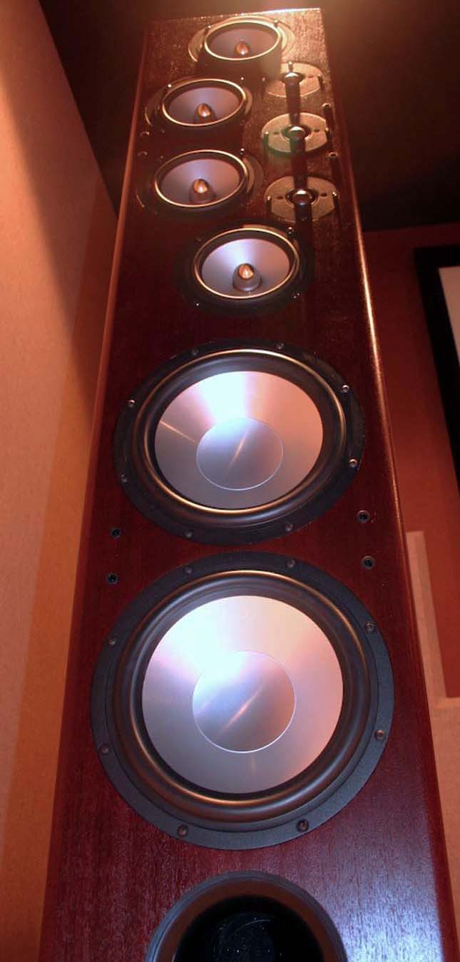

Because of the multi-tweeter driver array, off axis lobing can be heard while moving from center-seated positions to standing in acoustically controlled rooms with relatively low ceilings (8ft or less). On the plus side, this can be said about any speaker system., The effects are more pronounced on this system mostly because of the incredible detail you can hear when seated at the proper height. You need to be sitting at least 10 feet away from these speakers to minimize lobing effects and to allow for proper acoustic summation of the drivers, thus requiring a large room for optimal performance. Care and patience must be extended to find optimal positioning to achieve the best possible sonic performance.
Editorial Note About Lobing
The classic argument against line arrays or speakers with multiple tweeter arrays suffering from lobing effects is something worth addressing in this review. You cannot get around lobing issues with these designs. You must work with them in a way that minimizes the effect as much as possible. Lobing occurs when two separate sources (i.e. a midrange and tweeter) are producing the same range of frequencies at different distances from the listener. The different arrival times of those same frequencies creates a filtering effect called lobing. Every multi-way (2 way and up) speaker design, unless it is acting as a point source, is going to have off axis lobing issues to one degree or another. Speaker designs which have multiple drivers reproducing the same range of frequencies (in this case multiple midrange or tweeter drivers) are certainly susceptible to lobing issues. The effects of lobing in the midrange and high frequencies are minimized in the T-30LSE due to the unique driver alignment of the speaker. The mid/woofer drivers are aligned in a curve so the top and bottom drivers are actually closer to the ear than they would be if the drivers where in a straight line. The tweeters are spaced apart from each other at a specific distance to minimize the cancellation effects of lobing at higher frequencies. That said, once the listener moves above or below the plane of the drivers, lobbing effects become more readily apparent. For critical listening, the listener’s ear should be within the plane of the mid/woofer and tweeter drivers. One of the benefits of this particular alignment is the off axis response is tailored to reduce image compromising reflections off near boundary surfaces.
RBH Hero ShotIn my huge room I initially was able to induce mechanical noise out of the subs at extreme output levels. At first listen, I thought I was bottoming the drivers but later discovered the leads on the woofers were slapping against the cone. I pushed the leads out on the problematic woofers and this virtually eliminated this phenomenon - reducing it to a slight buzz when I stuck my head next to the woofers while playing at insanely loud SPL levels (not recommended for health reasons). RBH informed me this is something they normally do with the bass drivers of every production unit before installing them into the cabinet.
