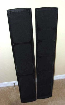

EMPtek Impression E55Ti Floorstanding Speaker System Review
  • Product Name: E55Ti Impression Floorstanding Speaker
  • Manufacturer: EMPtek
  • Review Date: October 23, 2010 17:30
  • MSRP: $ 795/pr (free shipping)
Specifications
Frequency Response:             40Hz-20kHz ±3dB
Crossover Frequencies:          120 Hz / 3,000 Hz
Sensitivity:                              88dB (2.83V@1m)
Bass:                                       Three 6-1/2 " (165mm) Poly-matrix Woofers
Midrange:                                Dual 5¼" (133mm) Aluminized Poly-matrix Woofers
Tweeter:                                 1" (25mm) Fabric Dome Tweeter
Recommended Power:            50-200 Watts
Impedance:                             6 Ohms
Dimensions:                            8-1/2" W x 47-1/2" H x 12¼" D
Weight:                                   52 lbs.
Finish Options:                        High-gloss Red Burl or High-gloss Black Ash
  • Lifelike soundstage
  • Incredibly good vocal clarity
  • Stunning appearance with high WAF
  • Lacks deep bass extension
  • Not bi-ampable
Introduction
If you want a speaker that can truly deliver a tonally accurate, dynamically lifelike reproduction of your music which also happens to look stunningly beautiful, than the EMP E55Ti's Impression  Floorstanding speakers should fit the bill nicely.  The E55Ti tower consists of six drivers, and is a vented 3-way design standing nearly 4ft tall. They produce a huge soundstage and can play exceedingly loud down to a modest 50 Hz, with little to no audible compression.  In my opinion, these speakers look as good as they sound which is something I rarely find myself saying at this price point for a tower speaker system. The EMP E55Ti's come with a 5 year warranty and a 30 day money back return policy with free shipping both ways.  This makes for a risk free trial for you to demo these speakers in the most critical and important listening room - your own home theater.  Highly recommended!
