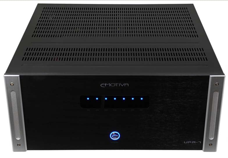

Emo-Front.jpgWhen Emotiva finally unveiled their UMC-1 A/V processor, I knew it would be a hot product to review.  But rather than mating it with their monster XPA series amplifiers, I decided to review its complementary seven channel amplifier, the UPA-7.  I glanced over the specs of the UPA-7 and thought it would be a good product for its asking price, not realizing my bias against external power amps rated at under 200 watts/channel.  When I began unpacking the UPA-7, I realized I underestimated this amplifier.  Once I ran my bench tests, I found that I had greatly underestimated this product even more than initially thought.  The Emotiva UPA-7 in my mind is an embarrassment - not to itself, mind you, but to the industry.  What I mean by this bold statement is, it's built too robustly, measures too pristinely and performs too well for a seven channel amplifier selling for even twice its price.  I know you've all heard that song and dance before from other review magazines, but unlike the fluff at those places, I back up my statements with a comprehensive evaluation of this product contained herein.  My only concern is that Emotiva doesn't put too much weight into my assessment of the UPA-7 and inflate their prices.

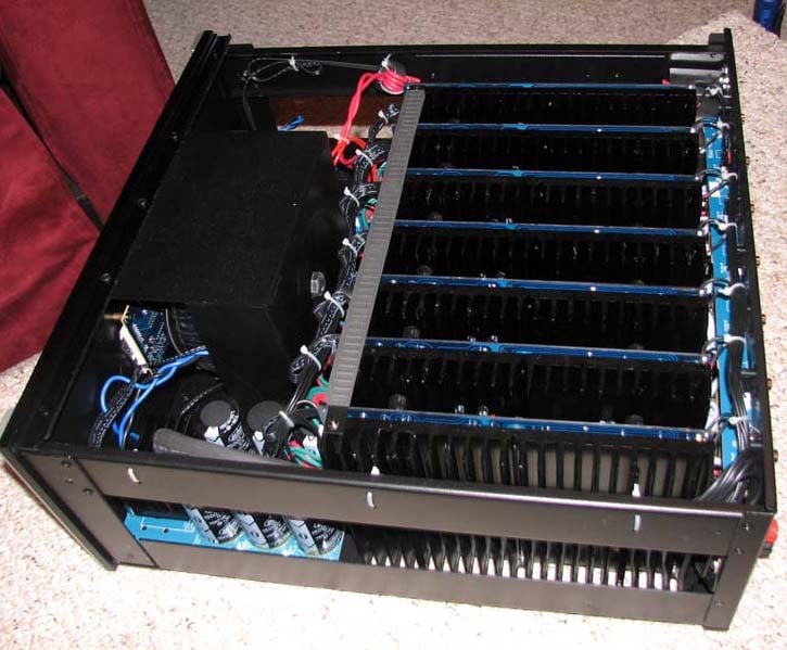

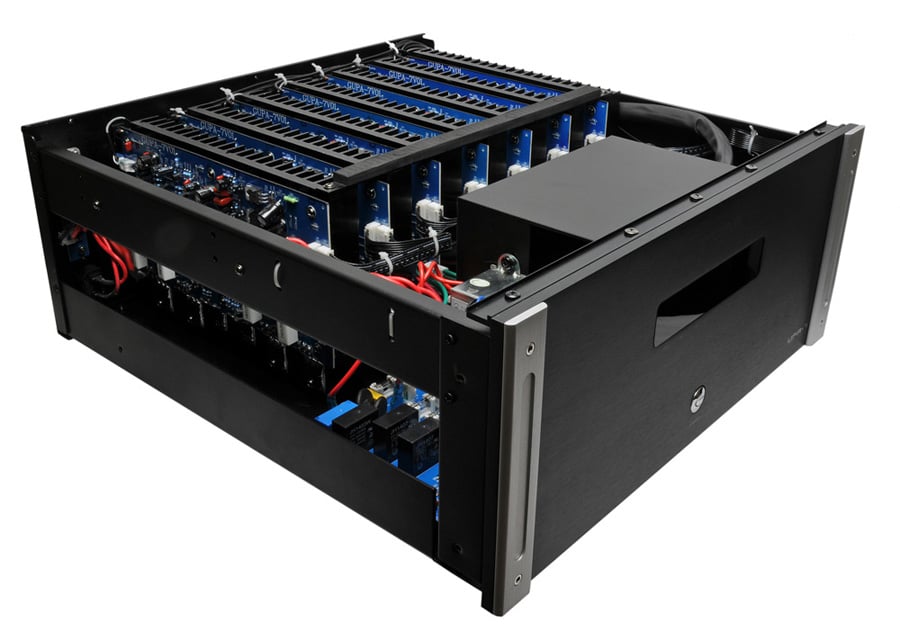

EMO-top.jpgThe UPA-7 is a traditional class A/B amplifier design utilizing a single larger toroidal power transformer and large capacitance bank for its power supply.  I much prefer this over smaller individual power supplies for each channel much like Emotiva used to do with their MPS-1 and MPS-2 amplifiers.  Having a singular larger sized power supply allows the amplifier to deliver more power to any given channel if the output devices can handle it.   This in turn provides more available headroom which is critical for effortlessly producing large dynamics and peaks in music and movies.  Emotiva claims the UPA-7 has 90,000uF total power supply capacitance.  Since the UPA-7 is only rated at 125 watts / channel (8-ohms), they could get by with using lower V rated parts which greatly reduces their profile.  Thus Emotiva employed six 15,000uF capacitors wired in parallel to yield 90,000uF. In some of their prior amplifier designs, (ie. MPS-1, XPA-2), Emotiva implemented series-parallel 50V capacitor banks which allowed them to use smaller parts while still having 100V capability to handle the higher power output levels.  The problem with this method is you now have reduced the total available capacitance to 1/4th the sum of the parts.  In the case of their XPA2, which if you added up all the power supply capacitors came out to 180,000uF, the actual real capacitance available was only 45,000uF.  In reality, the UPA-7 has more available power supply capacitance than all of their current XPA series amplifiers.  Incidentally, the UPA-7 is also Emotiva's only seven channel amplifier currently available.  What lots of capacitance does in a power supply for an amplifier is reduce ripple, and increase available reserves to allow more sustained power with less fluctuations under heavy demand.
We've established that the UPA-7 has quite a meaty capacitive power bank but what about the most critical power supply component - the power transformer?  Emotiva didn't pull any punches here.  They employed a large 850VA toroidal power transformer to ensure the UPA-7 could deliver all of its rated power and then some.  The amplifier modules utilize four output devices per channel ensuring that the UPA-7 is totally stable under 4-ohm loads.  I've never seen these type of components used in a multi-channel amplifier of such modest pricing.

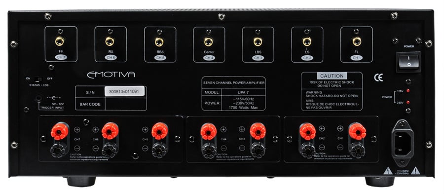

 The back view of the UPA-7 is a bit bland but the connector spacing is well laid out.  It's rare to see a seven channel amp with such ample speaker connector spacing between channels as the UPA-7 has.  The speaker 5-way binding posts and analog RCA connections are all 2" spaced apart.  It's almost as if the UPA-7 was assembled by precision clock builders.  Try tugging on any of the connectors and you will notice how firmly planted they are to the back panel.  Emotiva really knows how to build a durable amp.
I didn't realize it at the time when I did my bench testing that my review unit mistakenly came with an 18AWG cord.  Emotiva informed me that all brand new UPA-7's ship with a two-prong 14AWG detachable power cord.  The Emotiva amplifier is capable of connecting to standard 120V domestic power or 220V for those wanting to really tap out the maximum power.  It detects the line voltage and switches automatically to the correct setting.  This is a rare and cool feature I almost never see in any amplifiers regardless of price.  There is an on/off switch for the front panel status LED indicators and a 3.5mm mini-plug trigger input compatible for 5-12V systems.  The only thing that I found missing were provisions for balanced input connectors but at this price, it's hardly a real criticism especially since their mating UMC-1 A/V processor doesn't have balanced outputs.

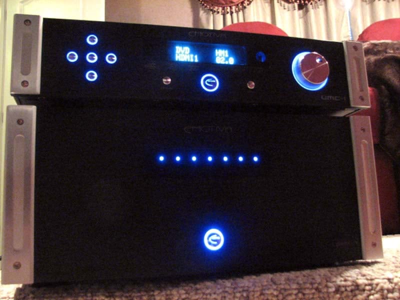

The front panel sports Emotiva's industrial look found in all of their current products with their infamous silver power switch embroidered and backlit with their logo (yellow for off state, blue for on state).  There are seven LED indicators (one for each channel) that illuminate blue when the amplifier is operating under normal conditions and flash red when all hell breaks loose.  I was unable to create such a fault condition in my testing.  In fact, Emotiva states that this amplifier is protected from all fault conditions which to me is very important, especially with high power amplifier designs that can potentially be destroyed if shorted.  I can't tell you how many times I've swapped cables during comparative listening tests where I accidentally shorted the leads.  On competently designed amplifiers such as the UPA-7, the amplifier will simply shut down and protect itself and the foolish consumer that forget to shut it off before swapping speaker connections.  On poorly designed amplifiers, they will either blow output devices or catch fire.  In the 10+ years of reviewing amplifiers, I am proud to say I've only blown up one amplifier which is a testament to all of the brands engineering their products correctly with consumer safety being of utmost importance.

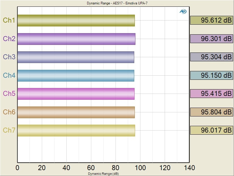

While sheer continuous output power is vital for a good amplifier, it's also important that that amplifier can convey full linearity at low listening levels which is where it spends most of the time.  To do so, a low noise floor is vital much like a properly set black level for a display is key to see all of the images detail.  Throughout all of my listening tests, the UPA-7 always maintained a deadened silence with no source material present, and very minimal added noise even during the faintest audible passages allowing all of the subtle details to be heard.

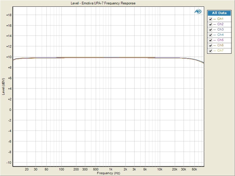

Frequency Response
Emotiva UPA-7 Frequency Response
It was no surprise to me that the Emotiva UPA-7 exhibited ruler flat bandwidth from 10Hz to 50kHz with a gradual rolloff of about -1dB at 80kHz which is the bandwidth limitation of my test equipment.  Emotiva claims the -3dB is 150kHz and I have no reason to doubt that.  What I found quite remarkable was the channel to channel frequency Response deviation of +/-0.046dB that I measured.  This indicates very tight tolerances in parts selection and excellent overall engineering.

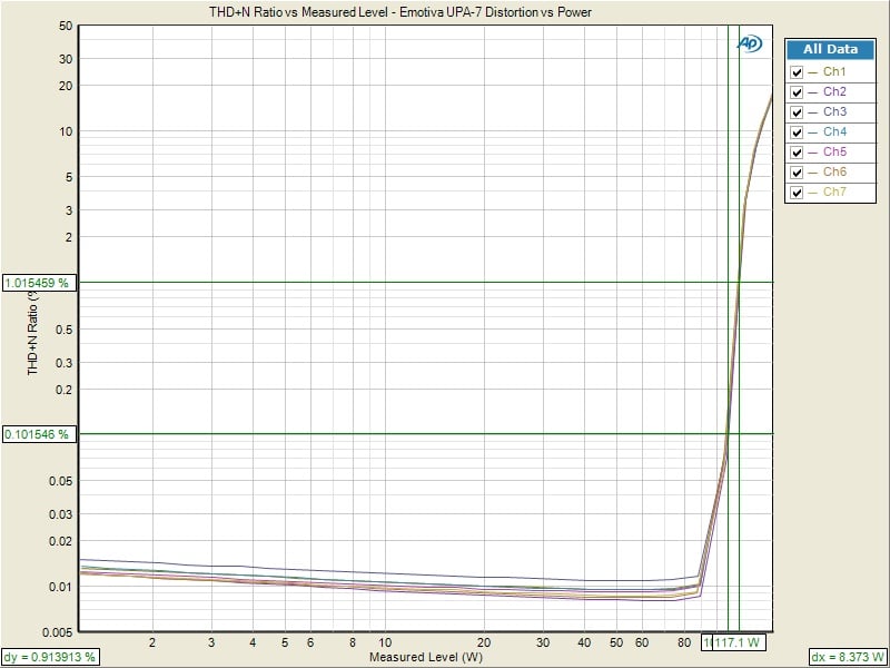

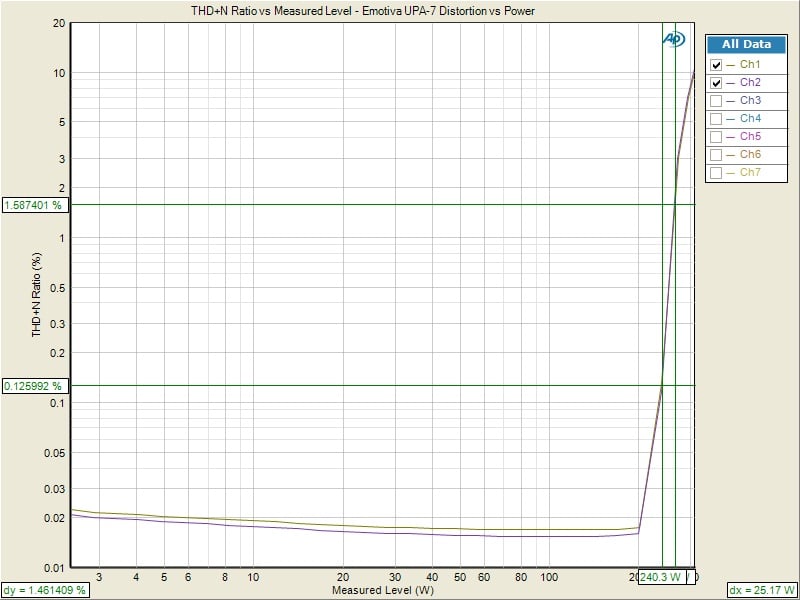

Using our Audio Precision APx585 8-channel HDMI analyzer, we conducted a full barrage of multi-channel amplifier tests on Emotiva UPA-7. We tested power using three methods all of which were taken at < 0.1% THD + N:
  • Continuous Full Power Bandwidth (CFP-BW) from 20Hz to 20Khz into 8 and 4-ohm loads (up to two-channels)
  • 1kHz Power Sweep vs Distortion (1kHz PSweep) - popularized by the print magazines, this is an instantaneous power vs distortion test at 1kHz. The problem with this test is it often masks slew related and or frequency response problems some amplifiers exhibit at the frequency extremes, and thus inflates the measured power results. It does provide an instant gratification # for consumers to argue over on the forums so we are now incorporating this test to please the masses.

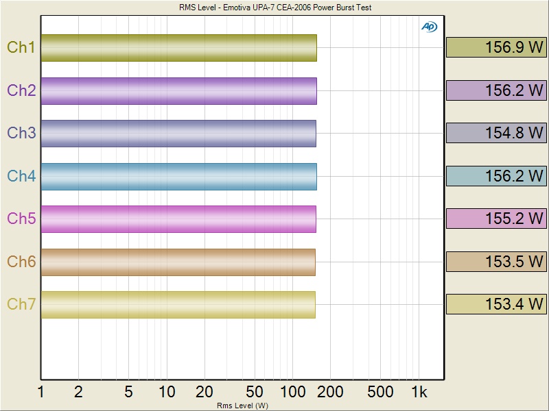

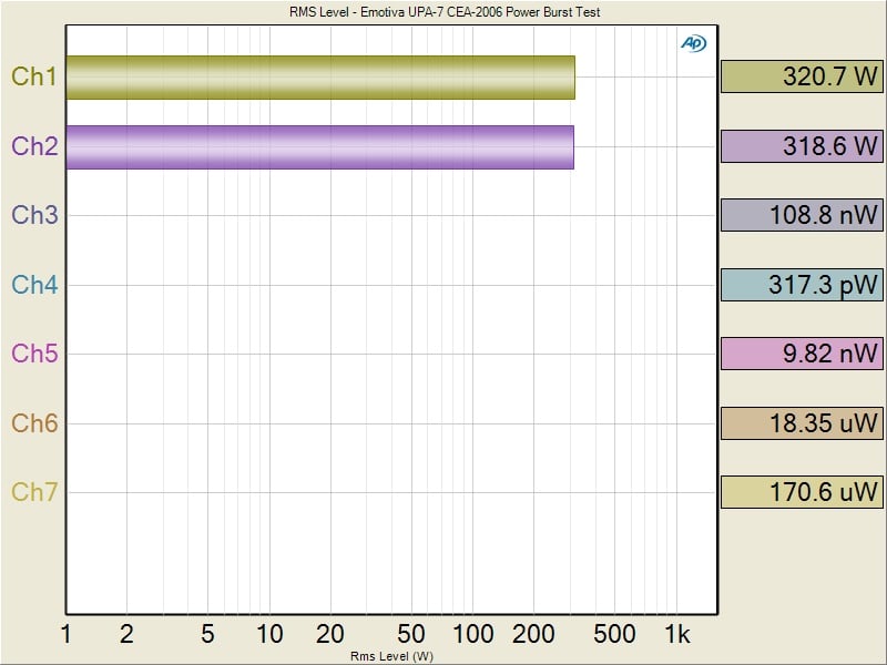

  • Dynamic PWR - 1kHz CEA-2006 Burst Method testing. This is a dynamic power measurement adopted from the car industry similar to IHF method only a bit more difficult for an amplifier and more representative of real musical content.
Keep in mind most review publications don't do continuous power measurements and they usually publish power measurements into clipping at 1% THD + N. Our measurements are very conservative as we use a dedicated 20A line with no Variac to regulate line voltage.  We constantly monitor the line to ensure it never drops more than 2Vrms from nominal which in our case was 120Vrms.

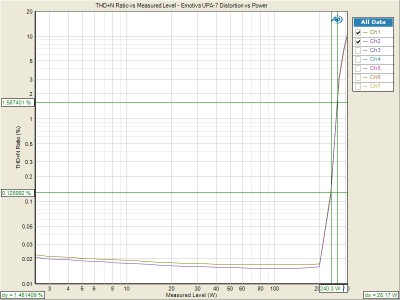

Emotiva UPA-7 1kHz Power Test
Left Pic: ACD, 8 ohms;  Right Pic: 2 Channels driven, 4 ohms
  Emotiva UPA-7 Dynamic Power Test (1kHz)
# of CH Test Type Power Load THD + N
2 CFP-BW 140 watts 8-ohms 0.1%
2 CFP-BW 238 watts 4-ohms 0.1%
7 1kHz Psweep 108 watts 8-ohms 0.1%
7 1kHz Psweep 117 watts 8-ohms 1%
2 1kHz Psweep 240 watts 4-ohms 0.1%
2 1kHz Psweep 252 watts 4-ohms 1%
7 Dynamic PWR 156 watts 8-ohms 1%
2 Dynamic PWR 320 watts 4-ohms 1%
Emotiva UPA-7 Power Measurement Table
Emotiva rates the UPA-7 as follows:
  • 125 watts RMS @ 8-ohm (0.1% THD)
  • 185 watts RMS @ 4-ohm (0.1% THD)
Emotiva doesn't specify at what frequency they rate their power output, but I assume they mean 1kHz which is how most manufacturers specify all channels driven power claims.  My measurements in this scenario came out a little short (117wpc x 7) compared to Emotiva's 125wpc x 7 claim but they informed me they do hold the line voltage constant at 120Vrms when conducting these tests.  I am willing to concede that our different test methods produced slightly different results especially as insignificant as these.  I was quite impressed with how the UPA-7 handled 4-ohm loads producing a whopping 240 watts x 2 into 4-ohms at 0.1% THD + N which was much higher than the 185 watt rating Emotiva spec'd for this amp under such load conditions.  Where this amp truly shines is in its dynamic headroom.  Again this is thanks to its large power supply capacitor bank and ample sized power transformer.  If you take my 240 watt continuous measurement into 4-ohms and calculate dynamic headroom based on my dynamic measurements above, the UPA-7 exhibits 1.25dB of headroom or 2.4dB if you use their claimed power into 4-ohms, which is quite excellent.

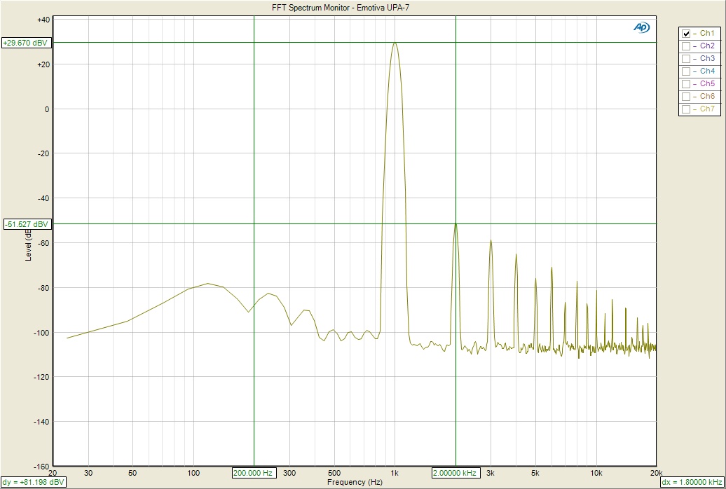

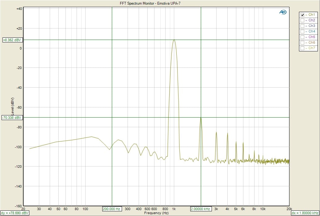

 FFT Distortion Analysis
Emotiva UPA-7 FFT Distortion Analysis
(left image @ 1 watt ; right image @ full rated power)
I ran FFT distortion plots at 1 watt (left pic) and full rated power (right pic) to determine how clean this amplifier really is.  At 1 watt, the spectral distortion was good with the second order harmonic (8.36 + 70.338)dB being 78.70dB down from the fundamental or 100*alog^-1(-78.7/20) = .012%.  At full rated power I observed (29.67 + 51.527)dBV being 81.2dB down from the fundamental or 100*alog^-1(-81.2/20) = .0087%   These are respectably good measurement but not the cleanest distortion spectra I've seen in some much higher priced well executed designs.

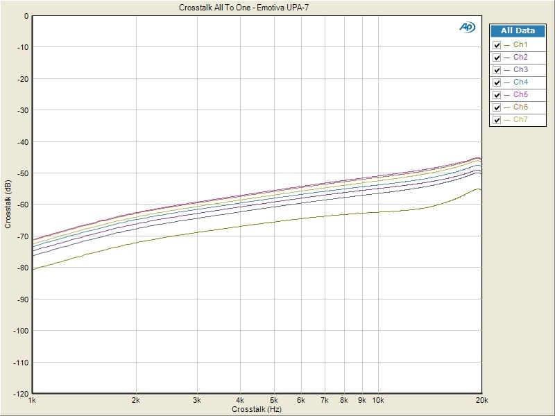

Crosstalk
UPA-7 All-to-One Crosstalk at Rated Power
If the UPA-7 had an Achilles' Heel it would be its channel to channel crosstalk performance.  With all channels acting as the noise source or disturber, I measured each idle channel one at a time to determine the worst case channel to channel crosstalk.  At 1kHz the UPA-7 yielded -70dB @ 1kHz and -50dB at 10kHz for its noisiest channel.  I consider anything less than -40dB @ 10kHz acceptable so the UPA-7 met that minimum requirement with 10dB to spare.  With only 1 channel acting as the disturber, the adjacent channel produced -85dB @ 1kHz and - 60dB @ 10kHz.  Again these are very good numbers but not the best of what we've seen from Emotiva, most notably with their XPA-2 delivering a staggeringly low -140dB at 1kHz of channel to channel crosstalk isolation.
