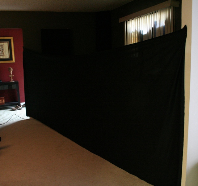

There were two different tests conducted - blind and sighted. For the blind test (which was done first) I had the entire front of the room blocked off with a large piece of speaker grill fabric. This fabric is acoustically transparent and very thin. From behind it, I could clearly see each of the participants to the point that I could tell when they were looking over each other's shoulders. Once I blocked the light coming in from the window behind the screen, the participants could neither see me nor the speakers. The screen was set up before the participants arrived on Friday and stayed up until after the blind listening tests were completed on Saturday. After each listening session, I switched the speaker cables (each marked with an A or B as were the amps), came out from behind the curtain, and let the listeners rest their ears/minds as long as they wanted. I did not answer any questions about which speakers were in the previous tests even after all the blind tests were complete. In fact, as of this writing, they still don't know. They are finding out the same time as you.

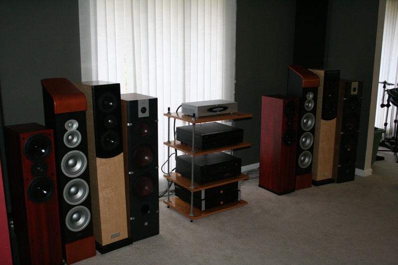

After the blind tests were done, I took down the screen. I asked the participants to examine the speakers. They inquired after the grills (which were removed for all the listening tests), they looked closely at the finishes and build quality, and even picked up the speakers. I then allowed them to switch the speakers individually and compare them as they wished. I asked for an individual writeup of each speaker for the sighted portion. They were encouraged to compare and contrast speakers in any way/order they wanted. During the sighted test, I was not in the room (for most of it I was taking a nap).

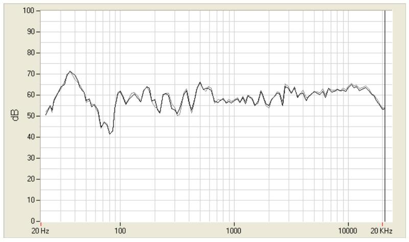

My first big concern was ensuring the signal chain didn't affect the sound. Since I was running one pair of speakers through the "main" analogue inputs and the second through the "surround," there was a concern that the sound quality would be affected. Before the participants arrived, I hooked up one of the speakers and took a measurement with the Sencore SP395A FFT Audio Analyzer. I then switched the speaker wire to the second amp and took a separate measurement.

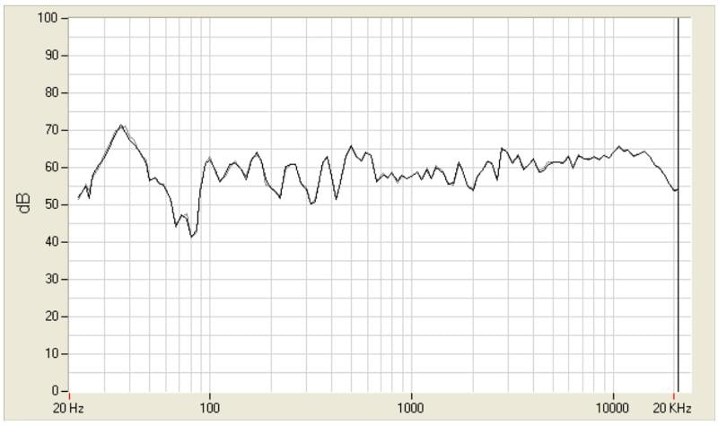

As you can see, the measurements are identical. The second big question is how the speaker grill fabric I was using for a screen would affect the sound. With the same setup, I took a measurement and then held up the fabric and took a second measurement. This second measurement probably is worse than what you'd experience in the actual room as there may have been more folds in the fabric and my proximity to the speaker/mic could have made a difference. As you can see, the measurements are both very close.

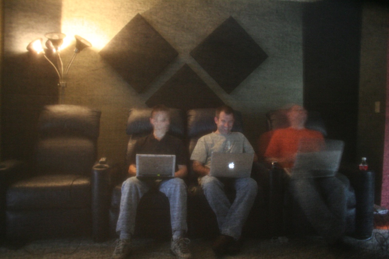

Shoot_front_left.JPGIn order to facilitate data collection, I decided to draw up two forms - one for the sighted test and one for the blind. The blind form was very specific as to what the listeners should be paying attention to - Highs, Mids, Lows, Soundstage, Imagining, etc. After they filled out the form on their laptops, I had them email them to me. This way, they couldn't go back and make changes after talking during the breaks. For the sighted form, all I listed were build quality and aesthetic concerns. At first I had drawn up a second set of listening pairs like the Blind table above but in the end I decided just to let them have at it. It had already been a long day and six more listening tests really wouldn't have proven anything. Better, I thought, to get their individual reactions to each speaker in a sighted test and let them compare and contrast as they will. The only addition I made to the sighted test was to ask them to do a listening test with the Krix Phoenix speakers without the port plug. During my review of the Phoenix speakers, I found that the bass response was extremely overbearing without the port plugs so I left them in during the blind tests. I could have included a second configuration of the Krix to the blind tests but I didn't think it would do much good (as I figured they'd just get creamed) and would add considerable time. The evaluation of the Krix without the plugs in the sighted test backed that up.
