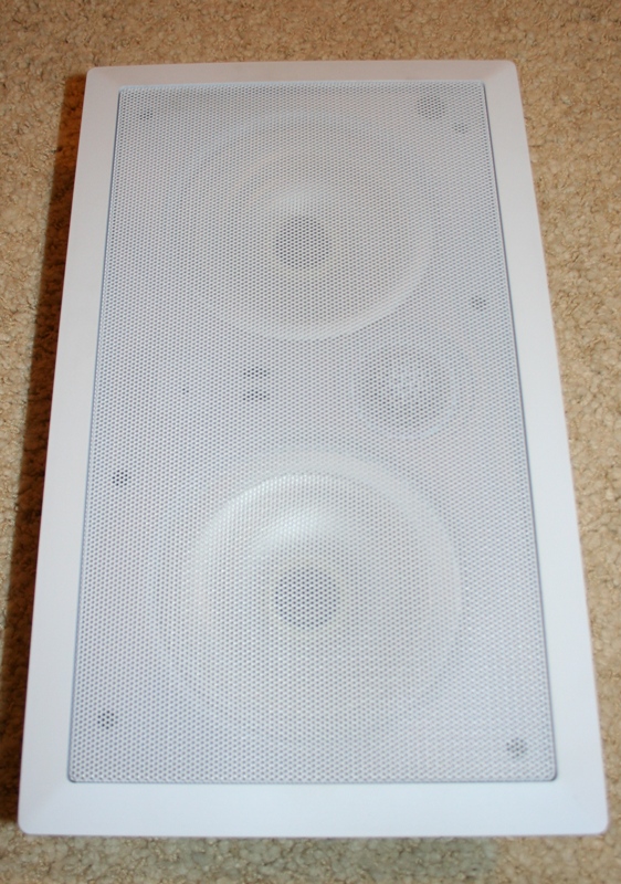

Inwall_grill.JPGThe speakers arrived double boxed (of sorts). Basically, every one of the speakers was wrapped in bubble-wrap and stuck in a box surrounded by foam packing peanuts. All four of the boxes were then boxed together in a single larger box. The problem with this packing method was that the bevels on the speakers, while rounded, are quite thin and sharp. On three of the boxes one corner of the bevel pierced the side of the box despite the bubble-wrap and peanuts. Since there were also some packing peanuts in the larger box, only one of these edges pierced all the way through. While there was no damage to the bevels of any of the speakers, it was a little disconcerting. As you can tell from many of the pictures, the speakers had no branding on the front and one was actually missing any sort of branding. These were pre-production speakers and probably the first batch of speakers they received. It's a testament to how rare in-wall speaker reviews are that they would offer up their earliest speakers.The Speaker Company (tSc) has assured me that they will pack these speakers in 5-ply brown cardboard boxes with custom molded styro inserts, a manual and mounting templates. The packaging is designed to survive a “two way” trip should someone decide to return them.

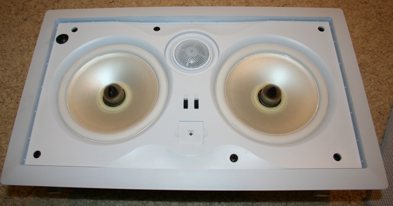

Inwall_front.JPGEach of the speakers are an MTM (Midrange-Tweeter-Midrange) design with the tweeter slightly offset to help reduce lobing effects. The speakers are all white except for a gold aluminum phase plug and a few black screws. Personally, I'd preferred if the NT speakers had all white hardware (namely the black screws and the two black adjustment switches) as they are gorgeous to look at without the grills on. Of course, being an Audioholic, I'm one of the few that would actually do that so I'm not going to hold that against them. In-wall speakers are made to disappear in the room. Also included was an acoustically transparent foam layer that is meant to be placed between the grill and the drivers. This helps the speaker blend into the room as the white baffle can be seen behind the grill under direct light. In the room in which they were installed, this wasn't an issue so we decided to leave it off. For those of you keeping score, these speakers look remarkably similar to the MB Quart Alexxa series sold in the Audioholics E-store for more than 2x the price.
Inwall_inside.JPGThe tweeters are titanium domes with the woofers being titanium wet powder coated poly cone. The tweeters swivel slightly with a firm push for fine tuning. With swiveling tweeters I rarely see any sort of mechanism to let you know when they have been reoriented straight forward. The NTs are no different. This is a feature that I believe should be standard on such speakers as it is easy to move them and not be sure that they are orientated the same direction. In addition, there are two "tuning" switches that will either boost or cut your highs or mids by 3dB. This is the sort of feature that is absolutely essential to in-wall speakers as placement options are often extremely limited and sonic distortion may very well occur based on that placement. The drivers also feature butyl rubber driver surrounds which are moisture resistant and suitable for use in bathrooms, kitchens, saunas, and even under outdoor eves. All of the speakers are magnetically shielded.

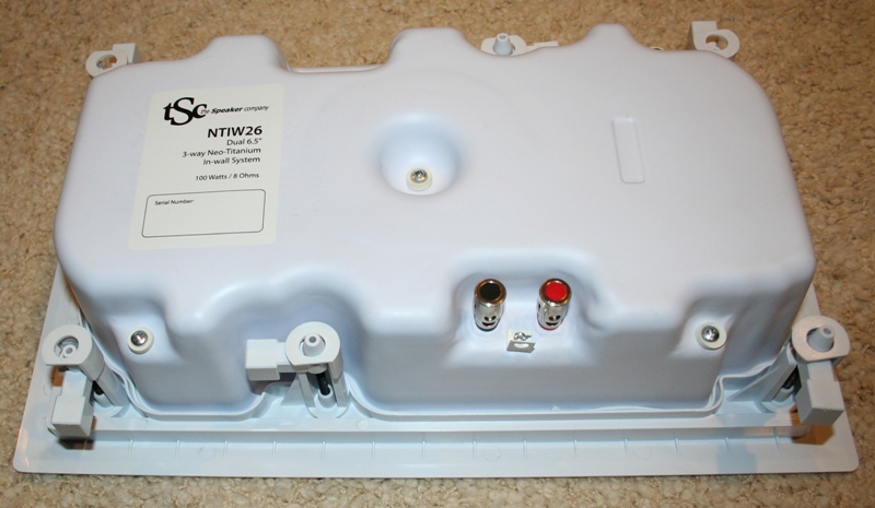

Inwall_back.JPGThe backs of the speakers sport dual spring-clip binding posts that pretty much only accept bare wire. I suppose you could use pins but that would be a waste. I generally don't like this sort of connection as they tend to be weak but these were higher quality than others I'd seen. It took a good deal of force to depress the spring and I was very confident that the wires were being held securely. I wouldn't be surprised if on the unimaginable chance that the speakers actually fell out of the wall, you'd find them dangling on the end of the speaker wires! They were that secure.
The installation method is very straightforward. There is a beveled lip (the ones that pierced the boxes) that sits on top of the drywall. Behind that there are six clips that turn and compress as you tighten a screw from the front. These are meant to grip the drywall and are similar to "old work" electrical boxes you may have installed at one time or another. You'll want to try and give yourself about an inch of clearance on either side of the speaker opening in order to give the clips enough drywall to grip. The mounting hardware does not give you enough room to grab on to a 2x4 if one is available (at least on the 4" side) so you don't want to cut either of your edges right up against a stud. In this case, a studfinder is definitely your friend. The clips run down little tracks and are held in place by a sort of ring at the top. On one of the speakers, the ring was broken and missing and the clip kept popping out of the channel. Luckily, this was a wall that I had direct access to from behind (see below) and I literally held it in place while it was installed. Honestly, six connection points is probably two to many so I don't think missing one would have been a problem. Also, it was traveling down toward the drywall, it was just really, really hard to screw. With enough elbow grease, I might have gotten in down anyhow.
