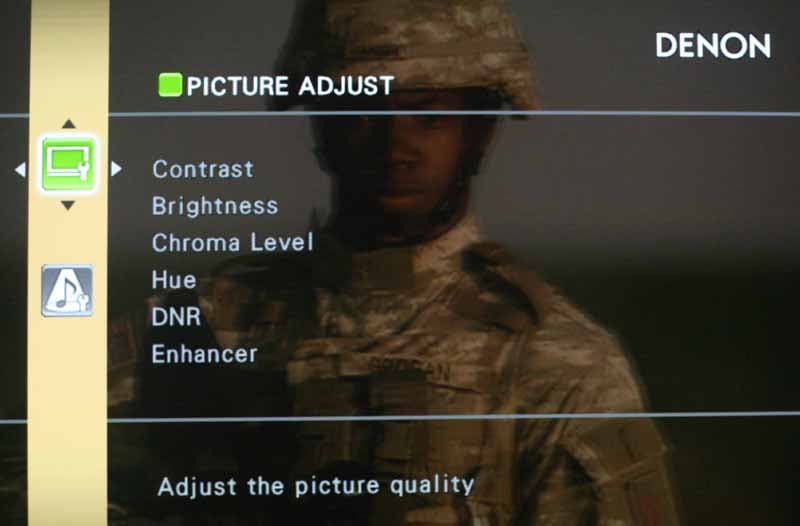

menu-pic-adjust.jpgWith these results, only those with truly exceptional sources may want to bypass the upconversion and video processing capabilities offered natively in the AVR-5308CI. The additional reason for this is that each input of the AV receiver can customize the Contrast, Brightness, Chroma Level, Noise Reduction, Detail (Enhancer) and Sharpness of the source video. This basically makes the AVR-5308CI a video processor and AV receiver all rolled into one. About the only thing missing is an anamorphic scaler for use with special cinemascope projector lenses. Hue can only be adjusted with composite or S-video sources, so let's assume (correctly, we hope) that you'll never use those.

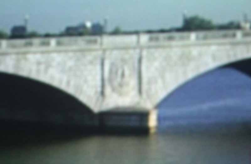

Enhancer, Sharpness and Hue were difficult for me to spot with HD sources at 1080i. After further experimentation I concluded that they have no effect on anything that doesn't originate in standard definition (480i). In taking DVD input at 480i I was finally able to see the excellent video processing quality of the AVR-5308CI. It was now that I got to really experience the DNR, Enhancer & Sharpness controls. Enhancer really brought out detail and didn't seem to affect anything negatively in the process. For example, when using the Detail video test pattern on the HQV Benchmark DVD you could clearly see an improvement in detail on the bridge. I'd recommend setting this to at least +6 and experiment on your own to see if it results in any negative issues.
Enhancer at 0 (left); Enhancer at +6 (right)

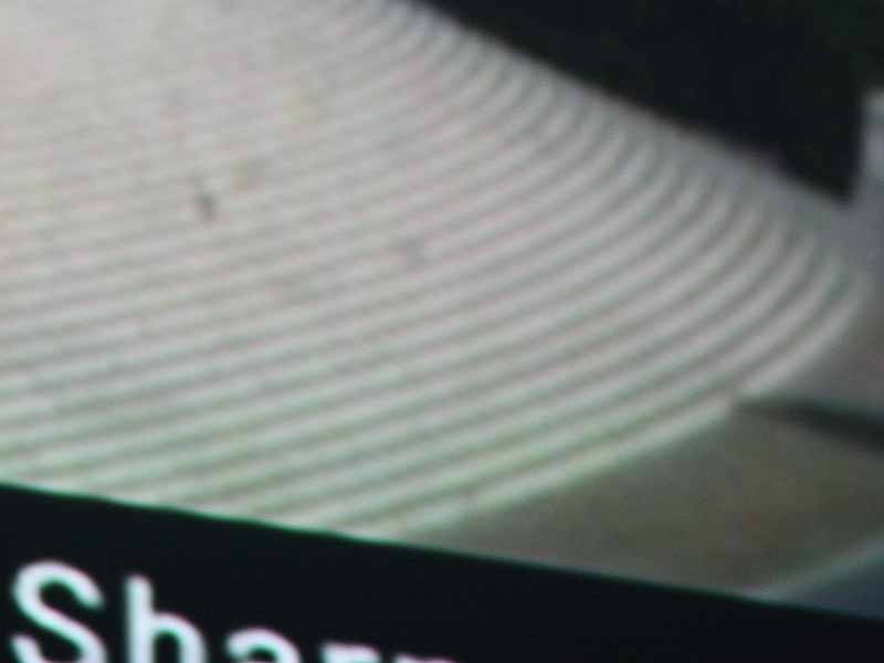

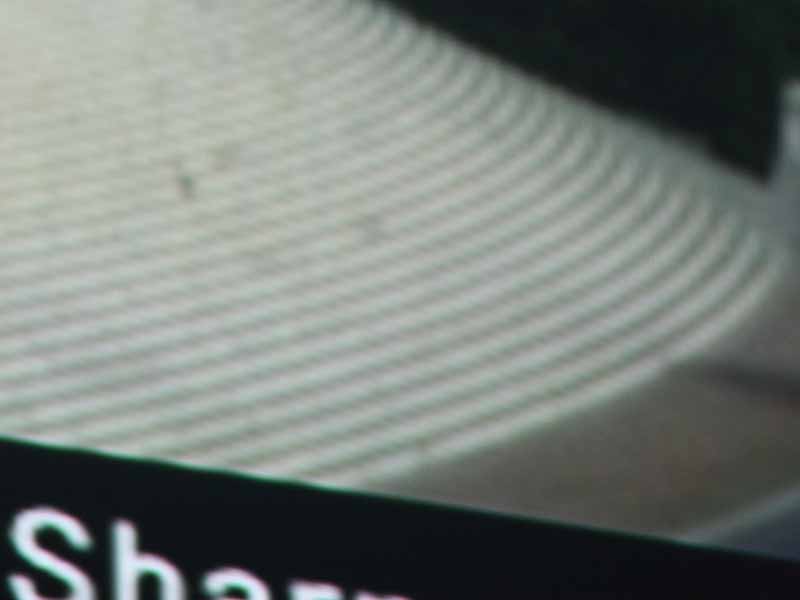

Some of the other controls, like Sharpness should be used sparingly - as is the case with most video processors. While the default setting of 0 is fine for Sharpness, if you crank it up into the positive range you're likely to encounter some artifacting on closely patterned objects (see pics below.) If you drop it below 0 the image actually blurs noticeably.
Sharpness Defaulted (left); Sharpness +3 (right) - notice the jaggies

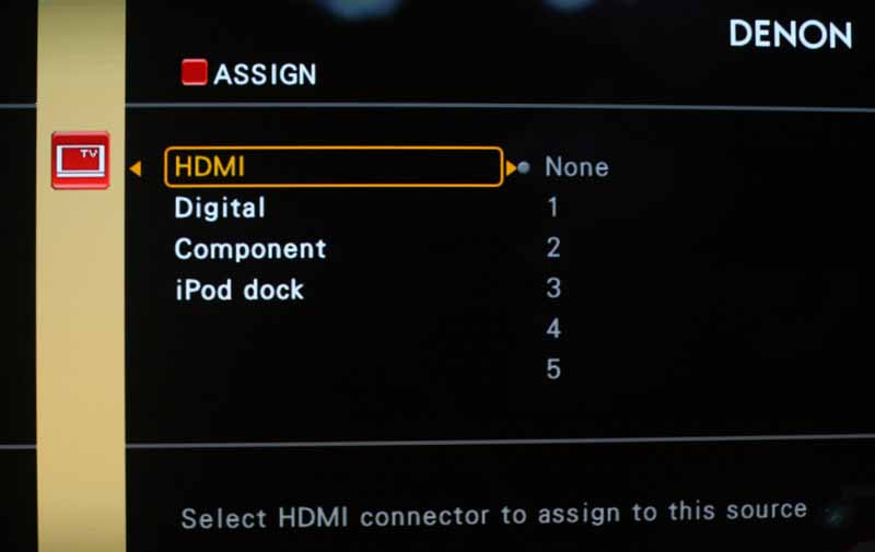

menu-HDMI-assign.jpgFor most, 6 independent and fully-routable HDMI and component inputs will be more than you'll ever need. As an aid to those using a Universal Remote Control, Inc product like the MX-3000 (which I use) or MX-950, you'll want to note that anything related to the DVR-2 source/input will need to be learned. It simply doesn't show up in the known IR codes list. Best practice might be to skip that input (#6) and use the others unless you actually need to use every HDMI and component input (we know who you are).
