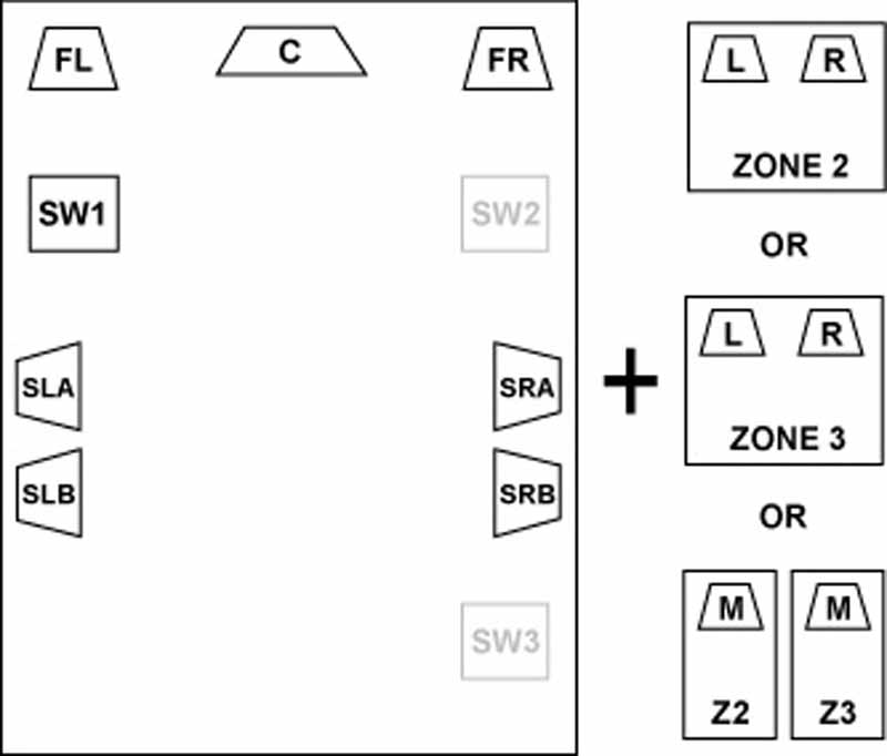

  • 5.1 surround + powered Zone 2 OR Zone 3 (or Zones 2 & 3 in mono)

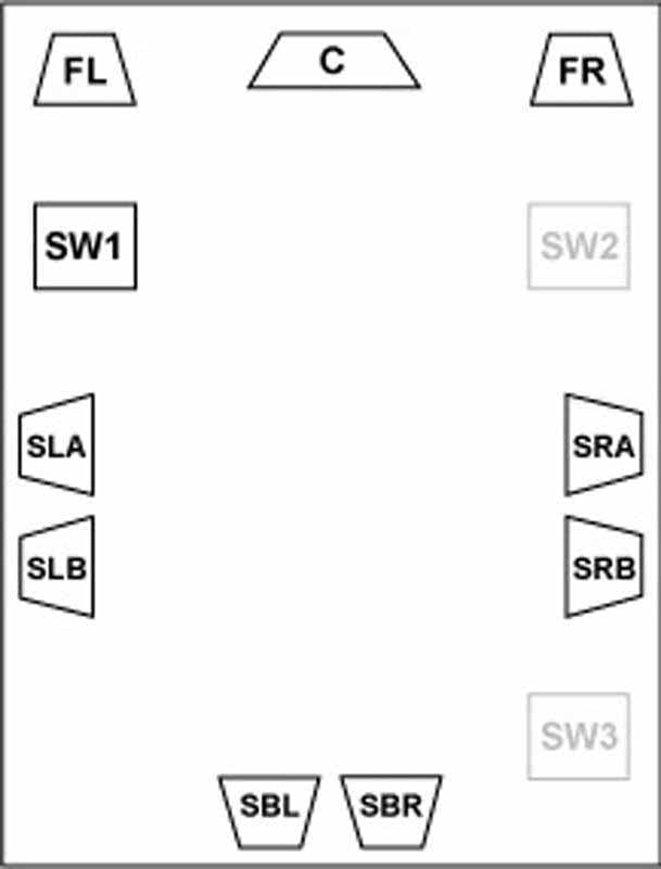

9.1 - Got a Big Room?
Starting with the biggest rooms you'll note that you can, in fact, run a sort of 9.1 surround system. Go to a movie theater and look around and you'll see that the Side Surround "channels" are made up of an array of loudspeakers. This is great for long rooms (let's say over 25 feet) with multiple rows of seats. Now let's see what other options you have in this 9.1 configuration. Without moving a single cable you can operate your system in either of these modes:
9.1 (left), "7.1" + Powered Zone 2 or 3, "7.1" + Powered Zone 2 AND 3 in mono
In the above example, Denon runs the Surround A and B speakers in parallel, so it gets it's a 9.1 designation even though the receiver only has 7 amplifiers. While the system does deliver an array, it's not discretely amplifying those channels. This should be noted for those looking to run 4-ohm surrounds, which would put a 2-ohm strain on the amplifiers (not recommended.)

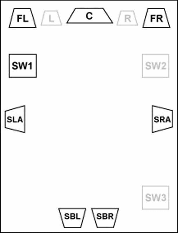

Denon can also shift the system into a 3.1 audio scenario in the main room when using powered Zone 2 and Zone 3 simultaneously in stereo mode. This allows for a powered three zone system for time that you simply want your whole house filled with sound during dinner events or parties.

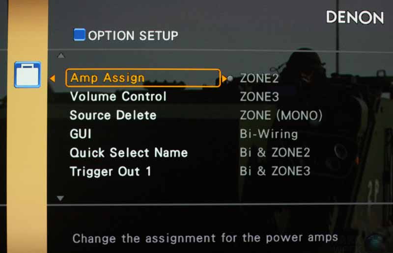

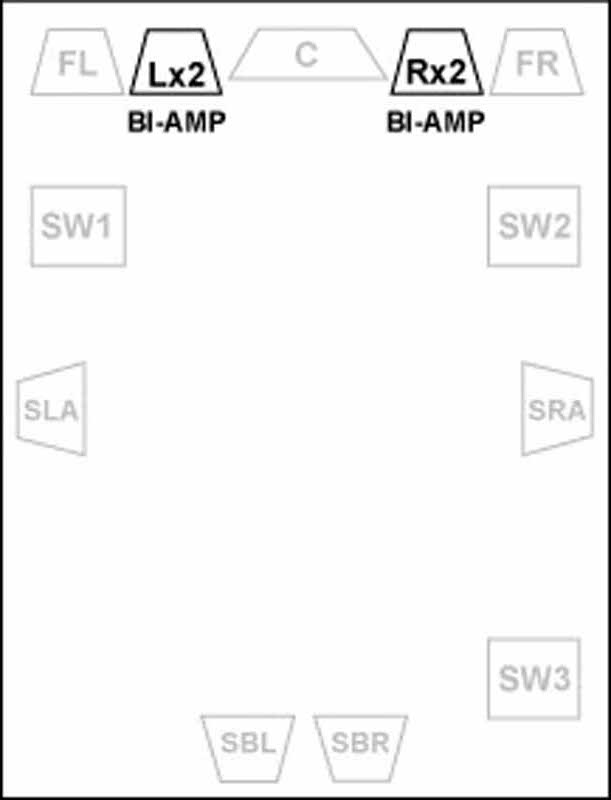

Bi-amping Made Easy
menu-amp-assign.jpgMoving on, we see that Denon is paying attention to those who wish to use the Amp Assign-2 connections to bi-amp the Front speakers. The AVR-5308CI takes the Surround Back channel amplifiers and re-routes them to biamp the mains. This leaves a 5.1 + array system with the extra channels utilized up front.
