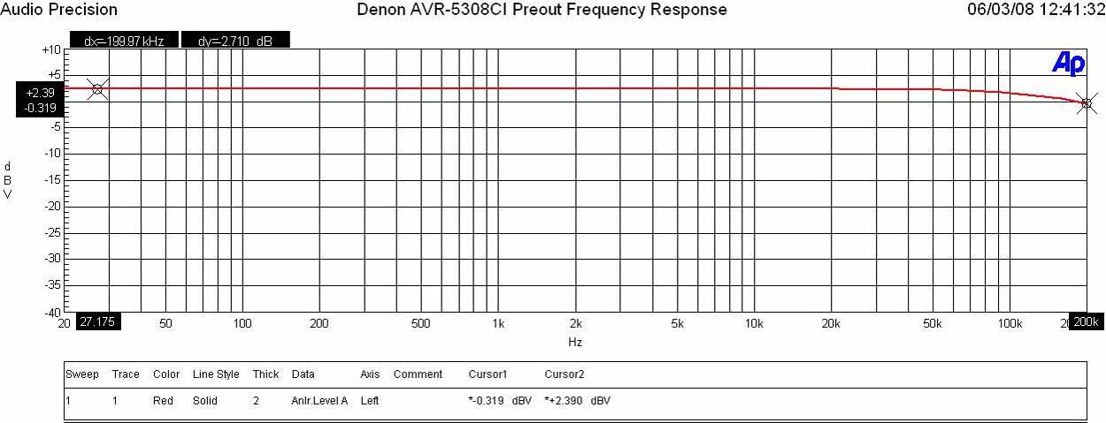

Denon AVR-5308CI Preamp Frequency Response
I measured a ruler flat frequency response with a -3dB point around 200kHz in “Pure Direct” mode. This is similarly good frequency response exhibited on the more expensive AVP-A1HDCI processor.

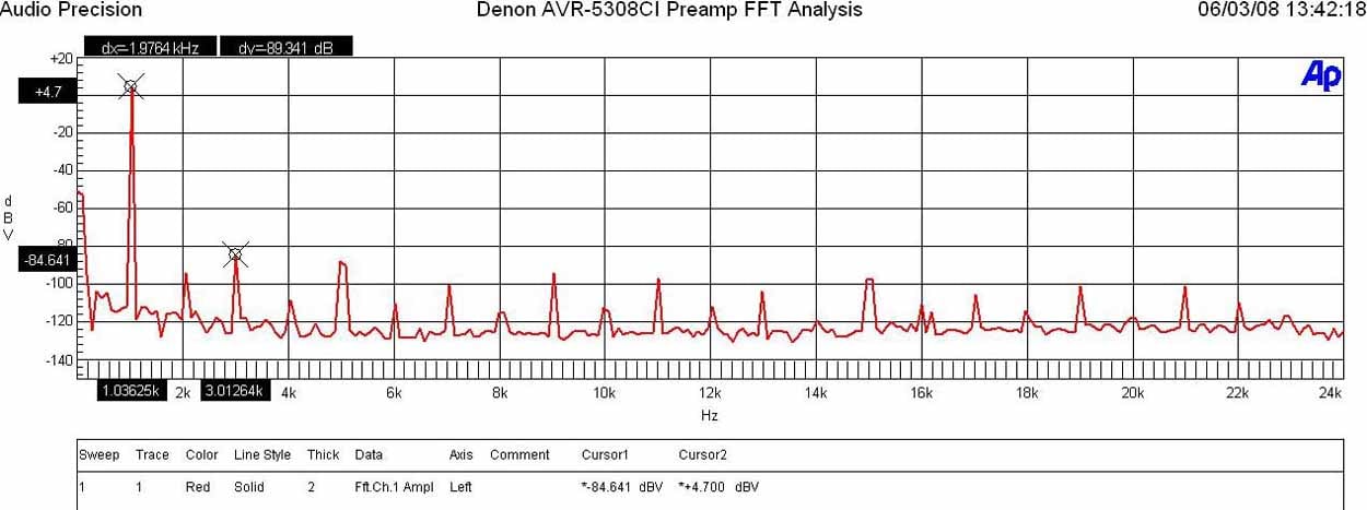

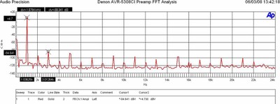

Denon AVR-5308CI Preamp FFT Distortion Analysis
With 200mVin, I set the master volume until I reached 1.7Vrms out of the preamp. The output was so pristine that I couldn’t measure any appreciable harmonics. I had to run the preamp up to 2Vrms out and 400Mv in to start measuring something appreciable but beyond the limits of audibility. Low distortion hardly qualifies for what I measured (4.7+84.641)dBv = 89.3dBv or 100*alog^-1(-89.3/20) = .003% THD + N which is very good, though not as pristine as I found on the AVP-A1HDCI processor or similarly priced Yamaha RX-Z11 receiver.
I measured a maximum of 3.8Vrms out (<0.1% THD + N) with a maximum allowable input of 8Vrms (<0.1% THD + N) though preamp gain was a bit lower than I’d expect to see which was in this case only 13dB. You may find the necessity to boast source level via the inputs should you couple this receiver with an external amp that is also low voltage gain.

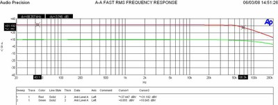

Denon AVR-5308CI Frequency Response at 1 watt & Full Power
The AVR-5308CI exhibited very good frequency response uniformity at high power levels (-3dB of 68 kHz) though not quite as steady with varying power levels as we’ve seen on the Yamaha RX-Z11.

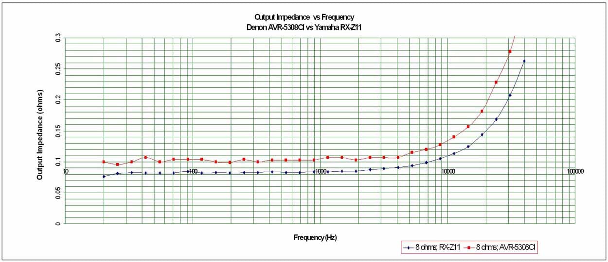

Denon AVR-5308CI Amplifier Output Impedance
The AVR-5308CI exhibited commendably low output impedance second only to the Yamaha RX-Z11 in this class of product. It floated right around our desired 100 mohm or less mark for the entire audible bandwidth up to 20kHz and maintained itself even when driving at max sustained power levels into 8 ohm and 4 ohm loads. This implies this receiver should sound consistently good no matter what loudspeaker load it is driving.

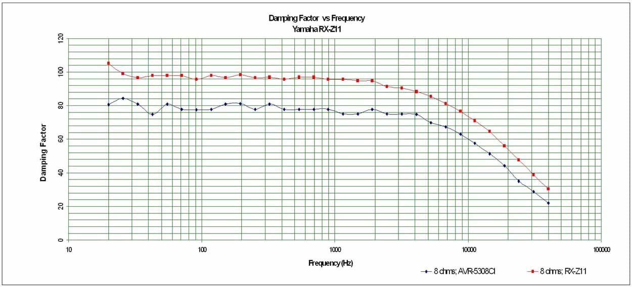

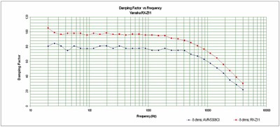

Denon AVR-5308CI Amplifier Damping Factor
The amplifier damping factor is about what I expected based on the measured output impedance. It is uniformly good across the entire audio frequency range at around the 80 mark (50 is a minimum we like to see in all amplifiers of uncompromising design) when driving an 8 ohm loads.

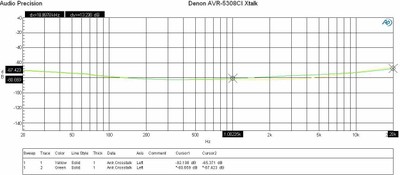

Crosstalk

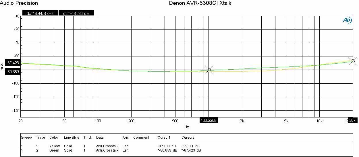

Denon AVR-5308CI Crosstalk Measurement at Full Rated Power vs Frequency
Running a full range frequency sweep from the preamp all the way through the power amp at full rated power (140wpc @ 8 ohms), I measured channel to channel crosstalk on two adjacent channels where one channel was the disturber and the other was the DUT. The Audio Precision plotted crosstalk of both channels over frequency by varying the Disturber/DUT channels. You can see the AVR-5308CI produced excellent crosstalk measurements (80dB at 1kHz) with only a slight increase up at the frequency extremes (low frequency because of magnetic coupling and high frequency because of capacitive coupling). This test really exemplifies the careful board and magnetics layout of this 7 channel receiver.
