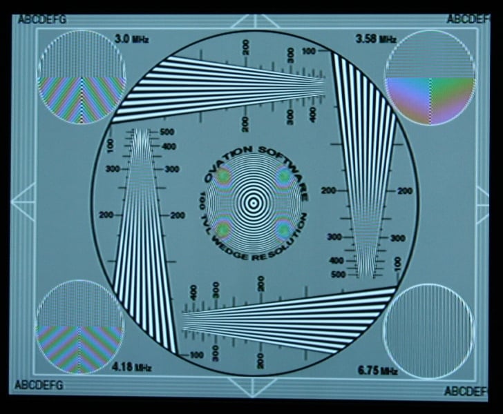

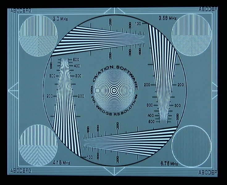

The big deal with the Video to PC Converter is that it deinterlaces the input video. This can make a huge difference in the video quality. While I hooked up the VtPC in my office at first, I wasn't really comfortable using that monitor to determine the quality of the deinterlacing. For the purposes of this test, I connected it to my Westinghouse LVM-42w2 through the VGA input. I set the Display setting to SXGA (1280x1024) and calibrated the VtPC with AVIA. Lastly, I ran the HQV tests using both the S-Video and Composite inputs from my OPPO DV-970HD.
The first thing I noticed was that the picture with the S-video appeared to be much sharper and brighter in comparison to the composite input. With the AVIA disc in, I was able to snap a couple of shots of the resolution screen:
Composite S-video
As you can see, there are a lot of visual artifacts on the composite side that just aren't there on the s-Video side (there are still a few on the s-video side though). This would necessarily lead you to believe that the s-video picture was better. And you'd be right. I found the composite picture to be much more muted and soft with many more visual artifacts than the S-video one. Consider this carefully when you are deciding which input to use for each source.
