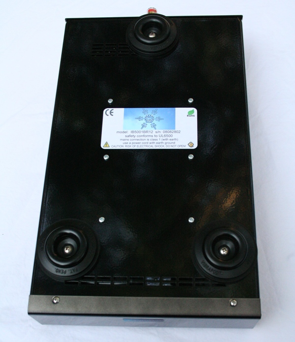

SAV_bottom.JPGAs you've noticed from the pictures, the top is rounded on the front corner. The amp is probably a bit smaller than you'd expect about 1/2 the size of a rack space (3.2" by 8.5" by 15.1"). This makes them very easy to place in your cabinet - especially in twos. They are very solid for their size with quite a bit of heft to them. Unlike some of the more esoteric offerings, they are not lead lined and nearly impossible to move, they are just as heavy as the components would indicate.

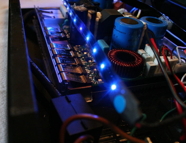

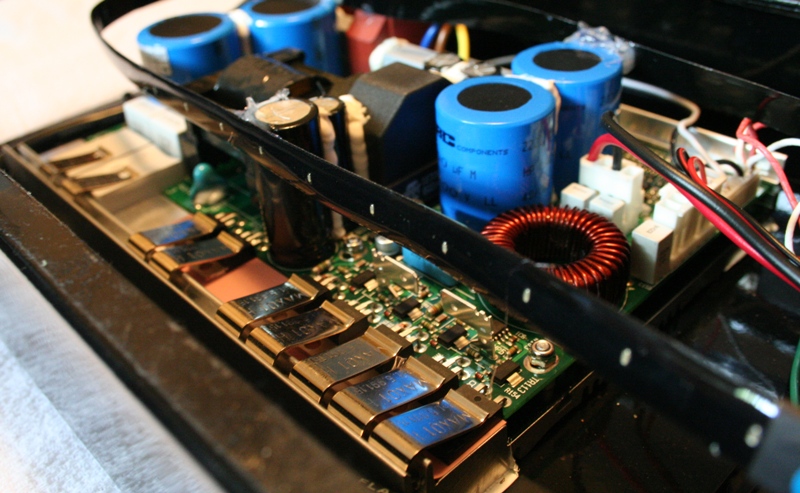

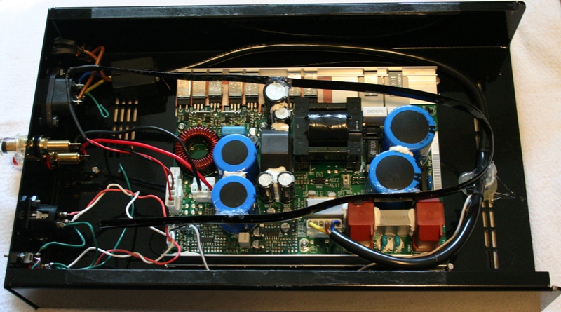

Taking apart the amp, we find the Bang & Olufsen's patented analog ICEPower amplification module mounted to a fairly substantial piece of aluminum. Around the top of the unit is a blue LED strip providing the internal lighting. I suppose if you really don't like the lighting, you could ask Seymour AV to eliminate that strip (it is plugged into the board for power and glued in several places). Between some of the components there is what looks like caulk seemingly for vibration control. I couldn't get a picture of it but there is also a sort of shock system under the aluminum plate most likely for the same reason.
