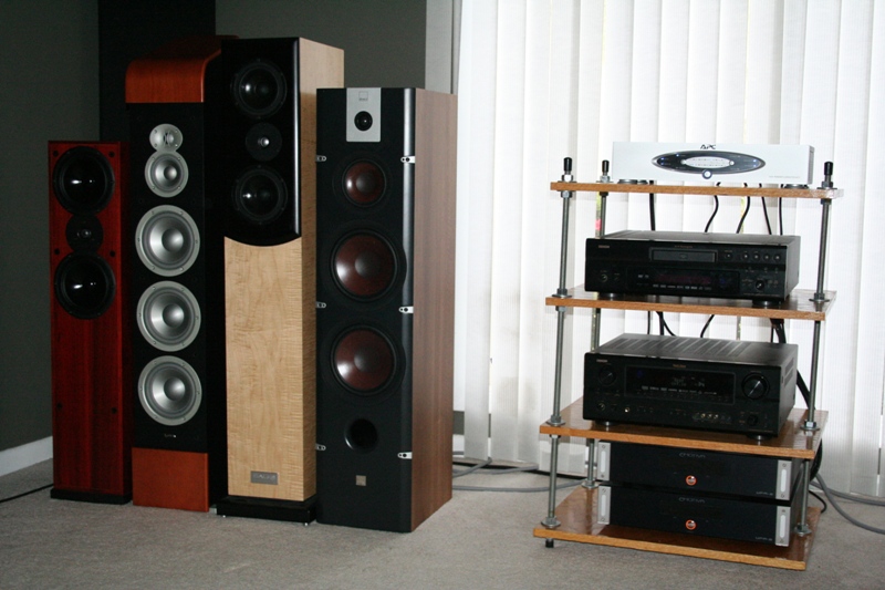

There are really only two types of participants for a shootout - professionals and enthusiasts. In this particular group, we had two professionals (Clint DeBoer, Editor-in-Chief of Audioholics and J. Walker Clarke, Audioholics Staff Reviewer and AV Rant Podcaster) and an enthusiast (a friend of J's named Jonathan - he's from Iowa not that it matters). The advantage of the professionals is that they are used to doing these sorts of evaluations and understand what to expect. They are well versed in the lingo and don't need much instruction. Jon, on the hand, needed a little hand holding at the beginning. He had questions as to what we meant by "Imaging" and "Soundstage" etc. He may not have been as confident as the other two (critical listening like this is pretty difficult especially when it is your first time), but really he jumped right in and seemed to hold his own even though I could tell he was a bit intimidated by the other two participants.
What we were looking for were floorstanding speakers in the $1500-$2000 range. This is a pretty "sweet spot" on the price spectrum for people that are serious about sound but don't have the uber-bucks required for monster speaker purchases. We were also looking for passive speakers (meaning no powered woofers) to keep everyone on a level playing field. The Floorstanding criterion, while probably not mandatory, was in place to help equalize the bass response. Theoretically, there could be a bookshelf with a low enough bass response to hang with the big boys. The problem is that no matter how it did, well or poorly, people would immediately be making attributions that were probably not fair to the other participants.
As I mentioned, getting participants for a shootout such as this is easier said than done. In retrospect, we should have lied. We should have requested speakers for a review not telling them they would be involved in a shootout. Unfortunately, we have a bit more integrity than that so we didn’t. Anticipating some problems, we devised and setup where each individual pair of speakers would get their own standalone review (by me) prior to the shootout so that they would already have press and objective measurements before the shootout even took place. We figured this would satisfy the more timid manufacturers and reassure them that even if they did poorly in the shootout, they'd still have an objective review to fall back on.

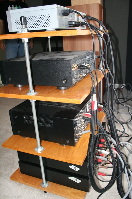

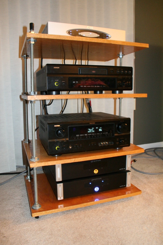

Shoot_amps.JPGWhen setting up a shootout, you'll want to make sure to follow the steps in our tech article on the subject. We made sure we had all the same lengths of cable (speaker and RCA interconnects from Blue Jeans), amplification (two UPA-2's from Emotiva Audio), all fed from a Denon DVD-3910 universal player and Denon AVR-2307CI receiver. Power was supplied by an APC H10. Switching was done manually by me.
Why?

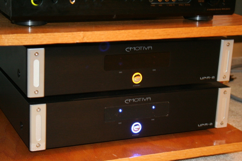

Well, when I contacted Emotiva about providing the amps, they suggested the UPA-2. It's a new low cost amp. It has plenty of power for my application (the room is smallish and none of the speakers are all that hard to drive). What I didn't know was that the UPA-2's have a volume control on the back. I knew that the Denon AVR-2307CI didn't have trim controls for its second zone. You need trim controls so that you can level match the speakers. My plan was to split the DVD output into both the front and surround analogue inputs on the receiver, send the outputs to two separate amps, level match the two sets of speakers, and manually turn the amps on and off as needed. This would give the two pairs an identical signal, identical amplification, and level matching capability. My experience with the Emotiva RPA-1 was that the amps when on and off in a fraction of a second.
The problem was that the UPA-2s don't go on and off quite that fast. Luckily with the volume control, I could turn one up and the other down very quickly. What was unfortunate was that I didn't know that the UPA-2's had the volume control. If I had known, I could have level matched using four of the amps (rather than one for each pair) and set the second pair on Zone 2. Then I wouldn't have had to do any manual switching at all and they could have done it all from the remote. But I didn't so I ended up behind the screen the entire time flipping amps whenever they asked.
