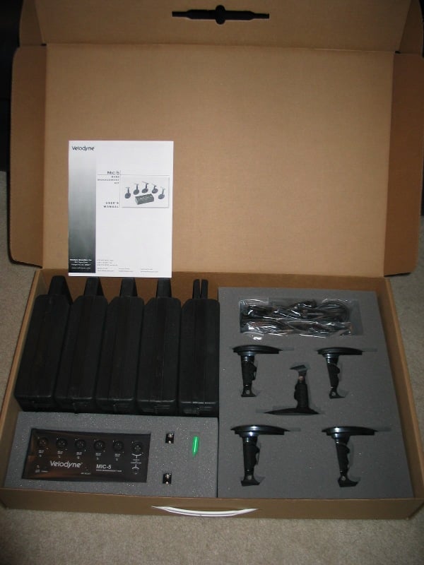

SMS_InboxThe Mic-5 really doesn’t require all that much setup except where and how to insert the battery (oddly enough, this step is not included in the user manual). For some reason, Velodyne decided that it would be neat to have the user have to disassemble the Mic-5 hub in order to insert the battery rather than providing a little door like every other product on the market. After you’ve done that, it is simply a matter of plugging the 20 foot XLR cable from the SMS-1 (or the back of your Velodyne sub) to the Mic-5 hub, and the 6 foot XLR cables to all the different microphones you plan on using. There is a power button on the top and a second “selector” button that cycles through 1 to 5 mics.
There are small stands provided for each of the mics as well as a separate threaded holder that can be attached to a telescoping mic stand (if you have a few of those lying around – I don’t). The small stands are perfect for setting on top of the back of your chair if your ears typically settle in that area. Otherwise, you’re going to need to try to get the tip of the mics near ear level.

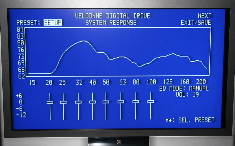

In my fairly small listening room, I first set up a mic at the PLP, two on either side creating the “expanded” sweet spot, and the final two in the outside seats (which would be considered my TLPs). With my room size, that many mics basically made it impossible to do much with the EQ as room effects were canceling most everything out. I ended up going with a mic at the PLP (center of the couch) and one on each of the TLPs (the outside seats). This gave me enough separation to actually make some changes. With a larger listening room I could have utilized all the mics.

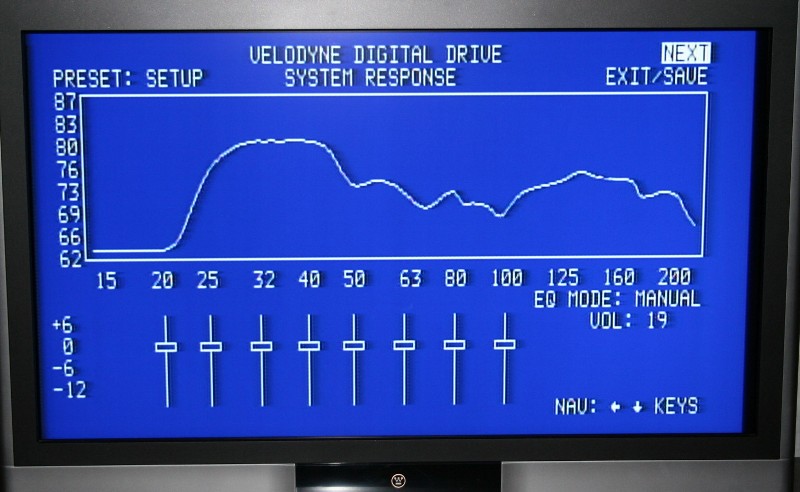

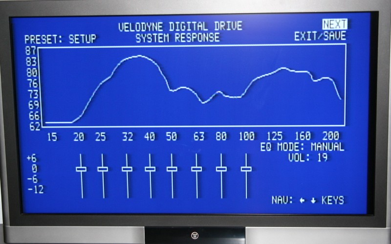

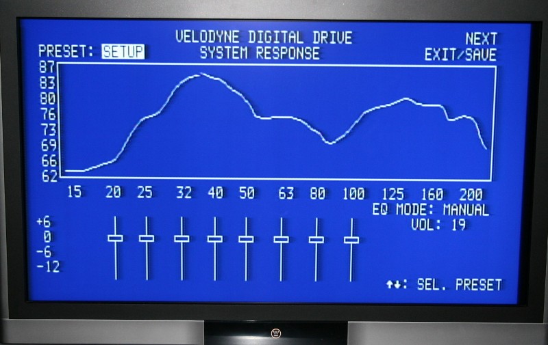

As I’ve recently started using floorstanding speakers rather than bookshelves, I want to see how things would work with the sub engaged and the speakers set to Small vs Large:
Single mic at the PLP
SMS_SM_Flat_1mic    SMS_LG_Flat_1mic
Speakers set to Small                      Speakers set to Large
Three mics
SMS_SM_Flat_3mic    SMS_LG_Flat_3mic

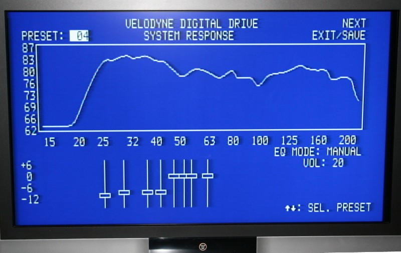

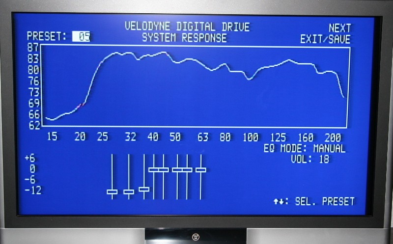

As you can clearly see, there's not really much difference in my room. The Axiom m60 v2’s aren’t truly full range so this isn’t exactly surprising. With speaker set to Large, the problems are a little bit improved as the low end extension helps to smooth out the crossover frequency. The gains, however, may not be enough for me to risk bottoming out the speakers on reference level playback of the Lord of the Rings movies. With this in mind, and for purposes of this review, I went ahead and set the speakers to Small and started my adjustments. Since my crossover is set at 80 Hz, we are really only looking at the flatness of the line below that point. Recalibrating the speaker levels after this process will bring the two halves of the graph more in line. With a few minutes of tweaks, this is what I ended up with:
SMS_adjust_1    SMS_adjust_3
Single mic                               Three mics
Much, much improved on all counts. I set both up on different presets so that I can easily switch between the two if I decide to change on the fly. The process was relatively simple and painless. With a couple of button presses I was able to switch between a single mic and tri-mic configuration. It didn’t take long to dial the system in to what you see above. See our SMS-1 review for specifics on use.
