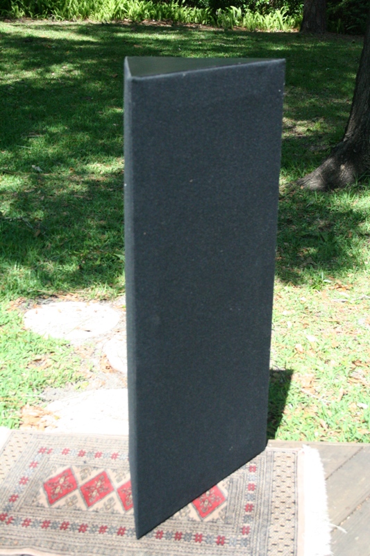

The GiK Tri-Traps are, as you might expect, triangular. They are also
shipped in large boxes of two. You must buy them in pairs so their quoted price
of $129 each is a little misleading. From a shipping standpoint, this makes a
lot of sense as there are a lot more rectangular boxes rather than there are triangular.
For all I know, the shipping companies might charge extra for an oddly shaped
box like that. Regardless, I ordered six tri-traps for my room, all in black.
They arrived in three large boxes. Each was wrapped in a thin plastic bag and was
tightly packed. There was no protection other than the box and bag though they
didn't really need it. The boxes (and traps) were quite light and arrived
without damage.

What
is a bit weird, however, is that regardless of what it says on the GiK site,
the Tri-Traps are not four feet tall.
They are about an inch and a quarter shy of that. When I spoke to them about
it, they said that it was because they wanted to take into account ceilings and
carpets just like mine. While I was relieved that I wasn't going to need custom
sizes, it did make me wonder why they don't just list the actual size on the
website. On top of that, info on the website is sometimes hard to find or
missing. You really have to look on the Tri-Trap page to find that the traps
are four feet tall and two feet wide (both incorrect as mine were 46.75" tall
and 23.5" wide). And what is wide anyhow? Well, it is the hypotenuse (the
part that faces the inside of the room for those that are having horrible
geometry class flashbacks). But what isn't on the website at all is the length
of the other two sides (the ones that would run against the walls of the
corner). Now, I could bust out my Pythagorean Theorem and assume that the squares of the
two sides added together would equal 552.25 (23.5 squared) but hey, I don't
really need to do math do I? These sides are the most important because they
will determine how far into your room the traps will go and whether they will
cover any outlets or vents. It is a serious omission from the info on the
website.
By the way, they said they were 17 inches (I measured them a hair more but close enough).

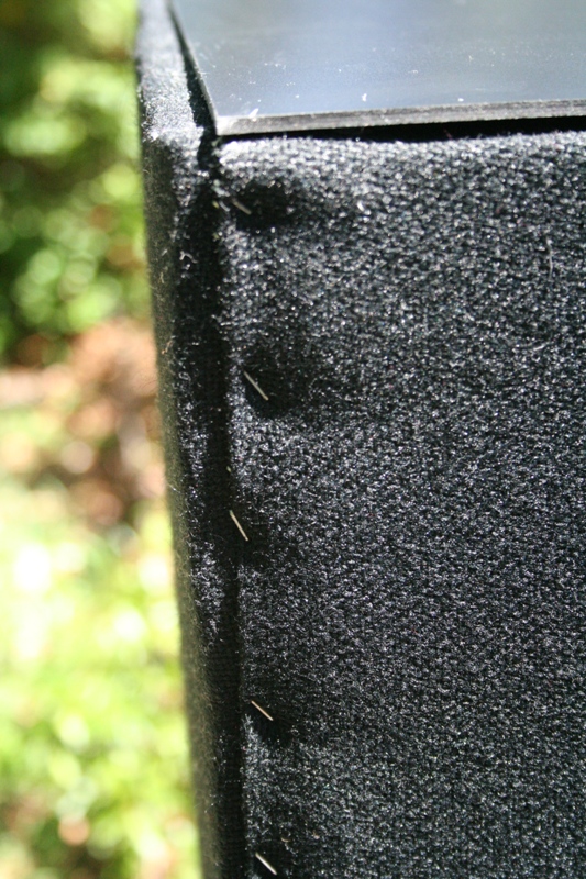

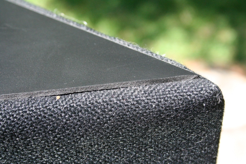

you see on the screen. The top and bottom of the Tri-Traps have a thin plastic
plate glued to them. For the white Tri-Traps it is white, for all other colors
it is black. This seems to be a vanity item to cover any staples or other
adherence methods. For probably 99% of the installations, you'll never see it.

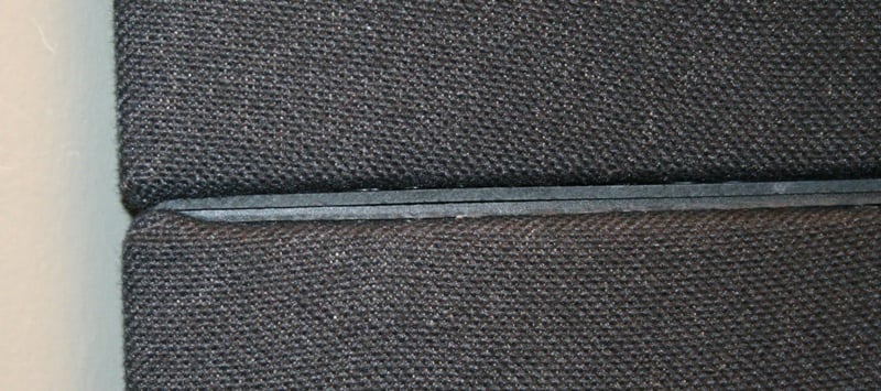

The only time you do is when you stack them. Personally, I'd prefer if the
plastic plates were removable or if there was another option so that the two
sat fabric to fabric creating a more unified look.
