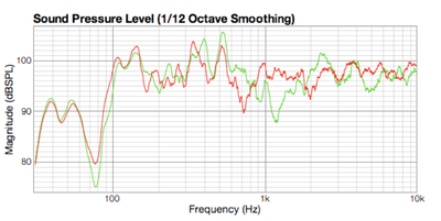

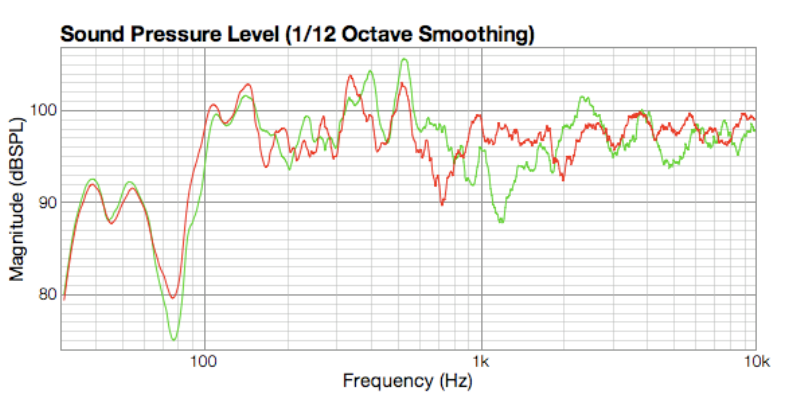

Not exactly. I've harped over and over again about a rectangular enclosed room. This is because modern modeling techniques rely on this shape in order to predict room interactions. Additional measurements were taken in the room and the results?
Green - before Auralex suggested changes, Red - after
Please remember that the "after" measurement was taken at a later date and while I tried my best to match the before speakers/mic/furniture placement, it could very well be that some of the differences are due to my placement inaccuracies. As you can clearly see, in almost all areas, the changes were positive. The peaks and dips while not eliminated are reduced in severity in almost every case. It this a flat line? Not by a long shot but this also isn't an ideal room nor has the room been professionally treated. This is more akin to a DIY project that just about anyone (with a little recording equipment) can do. That being said, I decided to take a measurement at the (subjectively) worse seat in the house. The results? No real difference between the treated and untreated versions. Sure, there were some changes, some good and some bad but overall the summary is above 200Hz things got a bit better but below, things stayed about the same.
How could this be?
Too often on the forums and with the uninitiated you'll get the impression (if not the outright assertion) that placing passive room treatments in your room will ALWAYS help. That may be partially true, but not as much as you'd think. Passive room treatments are broadband absorbers. Their function is to absorb sound from a multitude of frequencies. The problem is that you have no control over the absorption and where it is applied. In my room, there is a lot going on. There is sound bouncing around the listening space but also out into the adjacent rooms some of which is reflected back in. When broadband absorption is applied, it is affecting all those frequencies. Some of the reflected sound is causing problems by adding or canceling other sound. Other reflections are actually helping through the same process. With an odd shaped room, it is near impossible to tell what is happening and what to do about it without a more hands on trial and error approach. One thing is sure, broadband absorption is not the panacea that some make it out to be.

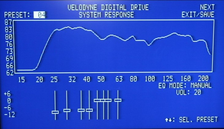

Plus_Axiom.JPGOne thing lacking from the Room Analysis Plus measurement is the sub. While I could have sent them a reading with just the sub and had them try to put them together (and this may be something that is worth spending one of your five measurements on), I didn't. Plus, you really aren't getting a picture of the whole room - it is one speaker at a time from one seated position. As a backup, I decided to bust out the mic for the Velodyne SMS-1 and recalibrate and measure my room. While my speakers have changed and so has the room treatments, the sub is the same and the basic layout hasn't changed much. In addition, Auralex sent me a SubDude HD. This is basically a 15" x 15" x 2.5" platform for your sub. The idea is to reduce vibration transmission through the floor cutting down on vibrations from other objects in the room like windows and such. While this makes my Axiom EP500 look a little like it is wearing one of those wooden shoes from samurai movies, it did seem to reduce vibrations. This was especially noticeable with a light fixture (another thing I've been meaning to replace - so many projects, so little money) in the foyer and a loose windowpane in an adjoining room. While the vibrations weren't completely suppressed, I was able to turn the sub up louder before they became noticeable. When I reviewed the Mic-5 add-on for the SMS-1, I took a lot of measurements. The best I could do at the time with a single mic at the prime listening position was this:
SMS-1 1 Mic Calibration Before Auralex
Now remember the Velodyne measures at 1/3rd octave smoothed rather than 1/12th of the Auralex graphs. The 1/3rd smoothing really hides a lot more of the problems than the 1/12th. That being said, here is the post Auralex graphs:

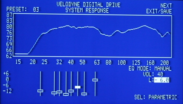

SMS-1 1 Mic Calibration After Auralex
The Velodyne really only affects sound below the crossover (which is set at 80Hz). Other than the expected (and Auralex predicted) dip around 75Hz, the line is remarkably straight.
