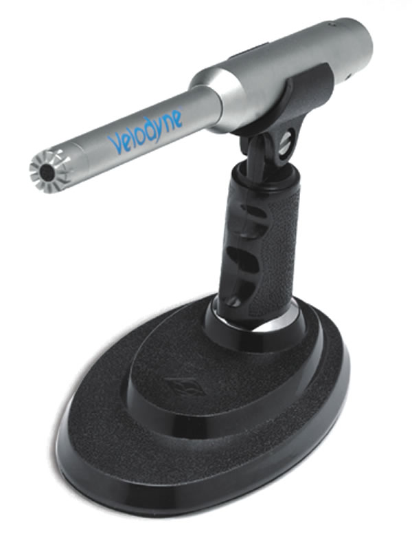

Plus_mic.jpgFor the Room Analysis, all you need is the ability to describe your room correctly. A tape measure is mandatory with a digital camera being a very helpful bonus. I'm sure you could use something like Google Sketchup if you wanted to. Any additional information would probably be welcome. After that, all you need to do is fill out the form and send it in.
For the Room Analysis Plus, you're going to need some sort of recording setup. This is where a lot of the Home Theater crowd is going to get lost. Having an omni-directional mic is not a problem for musicians who probably have them lying around but for the average consumer it is a different story. Auralex is now offering a package called the Room Analysis Plus Kit. In it you'll find a mic and a USB thumb drive with the appropriate test tones. What you'll still need at a minimum is a preamp and an XLR cable. You'll probably want a mic stand as well (though I'm sure you could rig something up). The cost of the kit is $299 and it includes a five position analysis (so you are basically getting the mic for $50).
Trying to figure out how to do this on the cheap, I can't really see how you're going to get away with a cheaper mic than $50 so I'm going to start with that. If you can (perhaps used or something), fine. Just be sure you're not buying cheap, just getting a deal on something quality. If your mic is low quality, your measurements will be affected and the analysis will be affected. Better to spend a few dollars up front on the mic than end up with an analysis with a bunch of caveats.
The preamp is the real problem with costs easily escalating. What you need is a way to transfer the XLR signal to USB to get it into your computer. With that, you can use a free program like Audacity and do the recording (that's what I used). A quick search online revealed a couple of devices like this which might work. You could possibly get a used preamp for about that as well. You'll need to look around. All in all, I estimate if you have no equipment you're going to be out about $350 to get the analysis done. That's not too bad but then again; don't forget that the standard Room Analysis is free. It just doesn't include any measurements.
