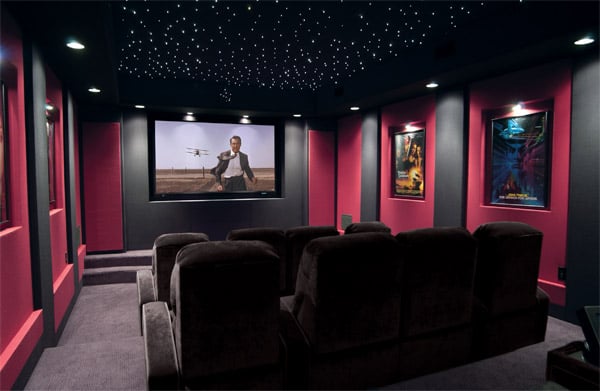

Auralex Pic lo res.jpgAuralex Acoustics is arguably the leading retail brand of acoustical products with a “full service” offering of sound isolation, source isolation, absorption and diffusion products. Servicing the pro/project studio market, residential dedicated theater/media market, house of worship and commercial markets, Auralex Acoustics offers professional product application support via their room analysis form.
Gavin Haverstick is an Acoustical Engineer at Auralex. Gavin has designed acoustical treatments for literally thousands of spaces and he offered the following:
