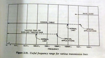

Video cables may be the most important cables in your system as the signals that are being passed through these cables (especially when dealing with HDTV) are in the Megahertz range. The higher in frequency your transport, the more critical it is to use cables that have a proper characteristic impedance (usually 75ohm for video), adequate shielding, and solid terminations.
It's even more critical to choose quality HDMI cables that are well shielded, low gauge (24AWG or lower) and are tested to resolutions up to 1080p.
Applications: TV, DVD, HDTV Decoder, Monitor Output of Receiver/Preamp.
Check out the Component Video Cable Definitive Guide for more details.
Check out the HDMI & DVI Video Connections and HDMI Considerations for more details.
2. Analog Interconnects
RCA Analog interconnects are also quite important since they interface high impedance connections, usually greater than 10kohms for amplifiers, preamps, etc. It is important to choose twisted pair cables or shielded coax which provide reasonably low capacitance, good shielding , and solid terminations. An excellent example of a cable well suited for audio applications is a shielded twister pair used for microphones such as the Belden #8422.
If we assume the output impedance of your source component (IE. CD player) is around a hundred ohms up to several kiloohms, then you can get away with an interconnect of up to a few hundred picofarads of capacitance and still yield a 3dB point well above 100kHz, or flat within the audio bandwidth 20Hz to 20kHz, based on the relationship of: frequency = 1 / [2*pi*(R*C)^1/2].
However, capacitance should be kept to a minimum on interconnects to avoid any possibilities of amplifier/driver stability compromises or premature roll-off. Older tube preamp designs tended to go unstable when driving high capacitive loads. This isn't much of a problem these days with solid state devices. In fact, most decent op-amp devices are capable of driving capacitive loads in the nanofarad range in shunt with a high input impedance without causing stability or noticeable overshoot problems.
It should be relatively easy to find low capacitance, twisted pair interconnects for a reasonable price that will provide frequency response beyond the limits of your hearing and equipment abilities.
Shielded Coax with RCA terminations, is also a great option, since they usually provide lower capacitance and sometimes better shielding than twisted pair shielded cables, but can sometimes be more costly. Additionally, coax cables with solid center core wires are less flexible making them more difficult to route in tight places. You may wish to consider shielded coax with a stranded wire center terminated with RCA plugs, much like a good quality video cable, for this application, especially if your runs are quite lengthy or subjected to many adjacent disturbers (IE. power cables, audio/video cables).

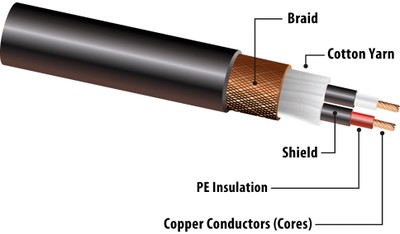

Toslink Digital cables, particularly coax, are not quite as critical as video since S/PDIF bandwidth is less than NTSC and the rise/fall times are not quite that stringent. The purpose of these cables is to pass a 44.1-48kHz sampled bitstream for PCM, DD /DTS. Should you choose to use coax type cables for your digital connections, I recommend using 75 ohm compatible shielded RCA cables, even good video cables will work just fine, to minimize coupling issues from adjacent cabling on long runs and/or potential RFI/EMI ingress, while also keeping losses to a minimum by proper impedance matching.
Toslink, or fiber optic cables, is another viable option with the advantage of not being disturbed by RFI/EMI, or ingress from adjacent cables carrying digital, analog, or power signals. The downsides are that some toslink cables may make a rather flimsy connection to the interface equipment which can be compromised when adjusting components in your rack or if the cable is weighed down by other cables in your system and for long runs compression and rarefractions can occur, especially if the cable excessively flexes or bends. I recommend selecting toslink cables that have a decent locking mechanism to avoid these mechanical issues.
What can make a difference in the sound of digital signal ?
There are two things which can cause differences between the sound of digital interfaces:
1. Jitter (clock phase noise)
This really only affects sound of the signal going directly to a DAC. Modern DACs in DVD/CD players typically have a small buffer and reclocking circuitry, so the jitter is not so big problem nowadays that it used to be.
2. Errors
This usually causes very significant changes in the sound, often loud popping noises but occasionally less offensive effects. Any data loss or errors in either are a sign of a very broken link which is probably intermittently dropping out altogether.
S/PDIF signals defined
The signal on the digital output of a CD/DVD player looks like almost perfect square-wave, with an amplitude of about 1Vpp and a frequency bandwidth of almost 3 MHz.
For each sample, two 32-bit words are transmitted, which results in a bit-rate of:
  • 2.8224 Mbit/s (44.1 kHz sampling rate, CD, DAT)
  • 3.072 Mbit/s (48 kHz sampling rate, DAT, DVD)
  • 2.048 Mbit/s (32 kHz sampling rate, for satellite purposes)
The output impedance is standard 75 ohm, so ordinary coaxial cable designed for video applications can be used. The minimal input level of S/PDIF interface is 200 mVrms which allows some cable losses. There is no real need for special quality cable as long as the cable is made of 75 ohm coaxial cable (a good video accessory cable works also as good S/PDIF cable). Newer formats such as
