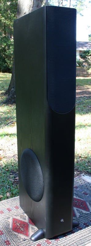

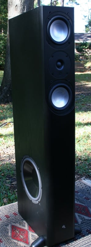

As I said, the speakers are heavy, much heavier than I expected for the price point. At 50+ pounds, they are a bit of a bear to move around. They are rear ported near the bottom, have dual binding posts for bi-amping, and are vinyl wrapped in wood grain black except for the front which has a sort of plastic finish. The front of the speaker sports an MTM driver configuration with two 5.25" aluminum drivers and a 1" closed-cell foamed polypropylene HiCell dome tweeter. There is a 10" side firing paper coated woofer. There is a single pair of plastic outriggers for the front of the speakers which need to be installed manually with two screws each. The back has a single threaded insert for a jester hat style carpet spike. The spike attachment points on the outriggers are slightly recessed so that it matches up with the rear insert. There are little rubber gloves (for lack of a better term) to cover the jester hats presumably for placement on hardwood or tile floors. I have carpet so that is not an issue.

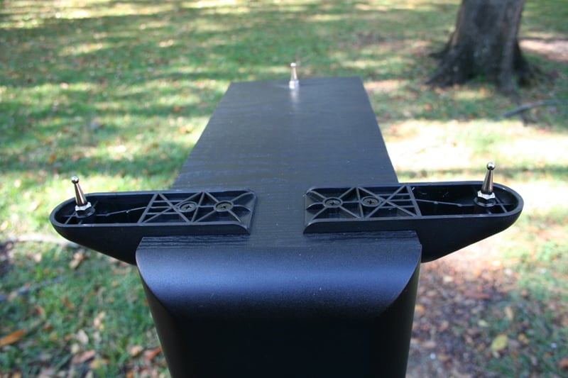

TST2_spikes.JPGI am generally not a fan of the three point contact of these speakers. I never could get the speakers to sit right on the ground. While leveling them on an uneven surface was a bit easier, they always seemed to wobble from side to side a bit. A fourth connection point would have helped this. On top of this, even through the threaded inserts seemed to be matched between the outriggers and the one on the bottom of the cabinet, they weren't. I had to grab my level and place it in top of the speaker. It seemed that the speaker was leaning back a bit. Both of them were like this but one was a little worse. This was definitely messing with the imaging and the speakers tightened up a bit when I leveled them. I would definitely suggest that all new owners take this precaution.

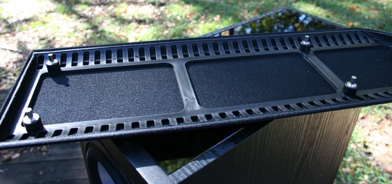

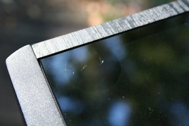

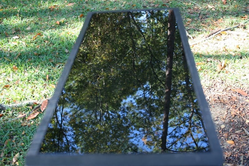

The top of the speaker has a piece of glass that is supposedly black. It may be tinted black but it is not opaque. This is obviously an attempt at a cheaper "gloss black" finish. Generally it works. In most light, at most angles, you can't see through the glass. However, at times you can. The grill is flush at the top and meets up seamlessly with a raised lip at the bottom. Personally, I think they look better with the grill off (I love me some aluminum drivers). The grill is integrated well into the design and looks good on.
The fit and finish of the speakers I would classify as acceptable. The front baffle doesn't quite line up with the rest of the cabinet and the gap between the glass top and the cabinet could be tighter but overall it is quite nice. One of the disadvantages of using a vinyl wrap is how delicate it is. It tears if you look at it wrong. The vinyl wrap (where it wasn't damaged from shipping) was very nice and the edges were perfectly aligned.

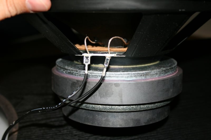

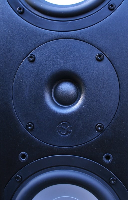

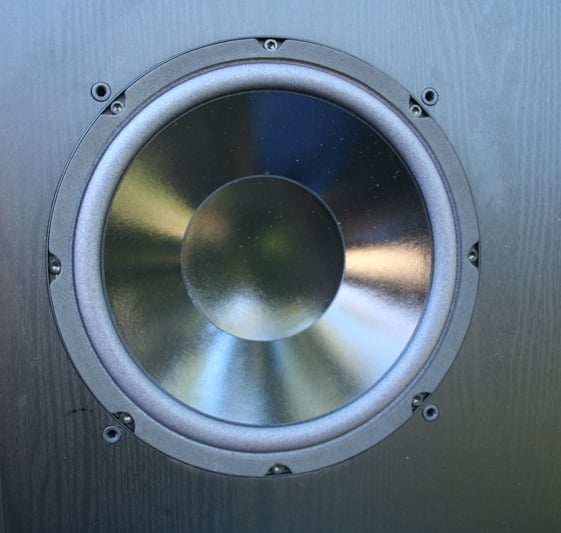

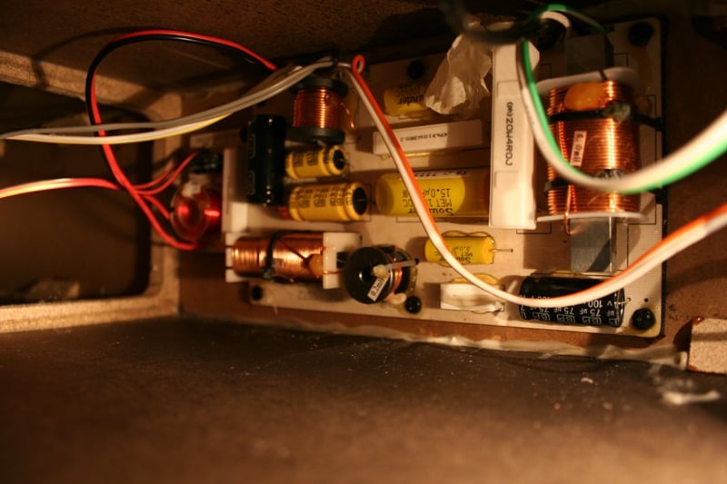

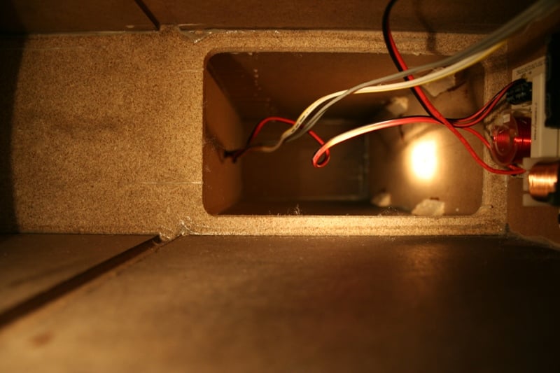

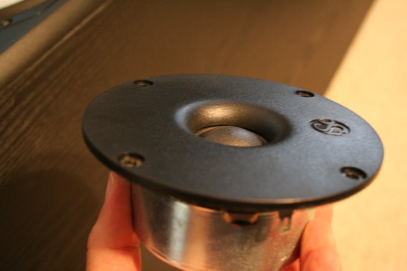

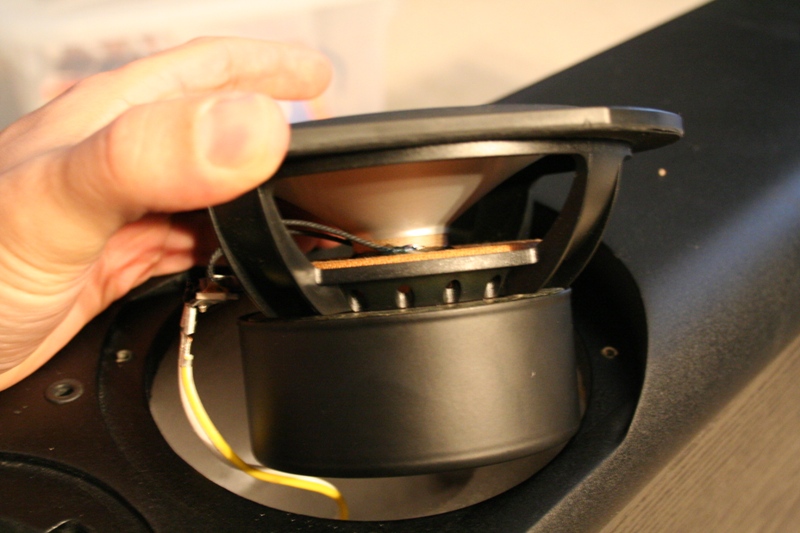

TST2_inside.JPGTaking the speakers apart, I was quite impressed with the build quality of the cabinets and the quality of the drivers and crossover. All the drivers are magnetically shielded and the 5.25" woofers feature plastic baskets which is an improvement over cheaper stamped designs typically found in speakers at this price point. The 10" woofer has a stamped basket. All the drivers have large magnet structures (the 10" woofer alone probably accounted for 1/3 of the weight of the speaker). The cabinet was constructed out of 5/8" MDF. The top drivers were encased in their own box with a generous amount of polyfill. The bottom portion formed an L utilizing the space behind the driver box to increase bass response. There was minimal polyfil in this compartment with a single piece running the length of the wall opposite the side-firing woofer. This could be a problem as air movement could cause wires to rub or vibrate against the unprotected walls of the cabinet. The crossover was a complex network consisting of over a dozen parts most of which were high quality. I did note a few iron core inductors that I’d prefer to be air core for improved sound quality via reduced saturation effects but at this price point, can one really be this picky? All of the drivers in this speaker system are magnetically shielded which is a real bonus for those placing these speakers in close proximity to a computer hard drive or an old fashion CRT tube (for those of you still living in the 1980's).

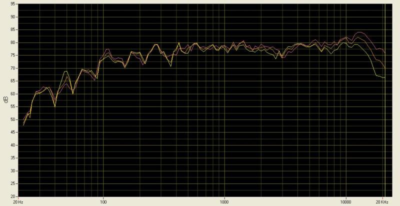

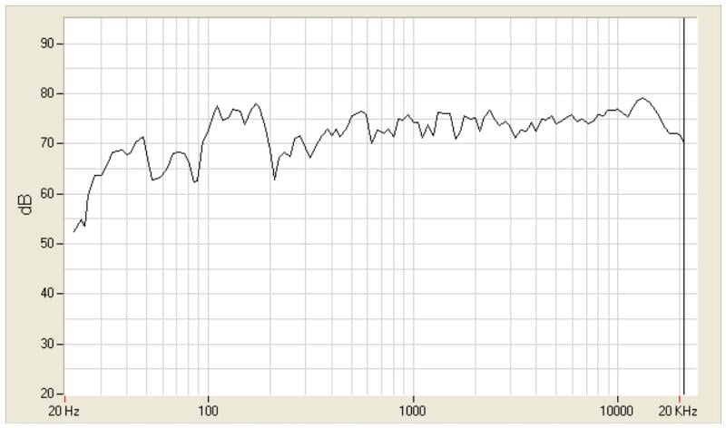

For laboratory measurements I used the Sencore SP395A FFT Audio Analyzer and a Sherbourn 2/75B amp, I measured the TST2's in-room on- and off-axis frequency response with 1/12th octave resolution
TST2 1 Meter Frequency Response (1/12th Octave) On Axis
Note - this is NOT a 1 watt measurement
TST2 1/2 Meter Frequency Response (1/12th Octave)
Pink - On axis, Orange - 15 degrees off axis, Yellow - 30 degrees off axis
Overall the frequency response of the TST2's was extremely linear especially considering the price point. Honestly, I was stunned. No obvious boosts in the upper or lower frequencies was present that so many speakers in this price range and above tend to deliberately do for that wow effect on a showroom floor.

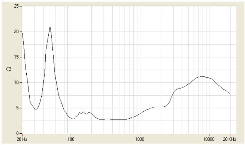

TST2 Impedance
The Sencore consistently measures impedance one ohm low. While the specs say that these speakers are 8 ohms, I measured 4 ohms at the terminals. Given the high efficiency of these speakers, I’d consider them an 8 ohm load. tSc employed a zobel network for the tweeter to pad down the response and smooth out the impedance curve. You can see by the impedance minima that these speakers are tuned around 30Hz which is what the manufacturer claims and about what we measured in our frequency sweeps.
