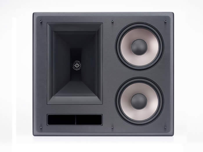

Figure 1: KL-650 THX without and with grill cover

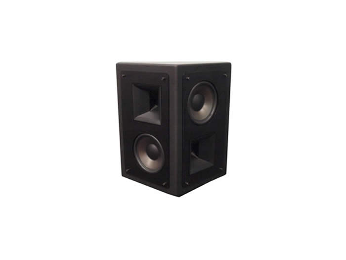

clip_image003_013.gif    KS525_largeb
Figure 2: KL-525 back surround and KS-525 side surround, grille covers off.

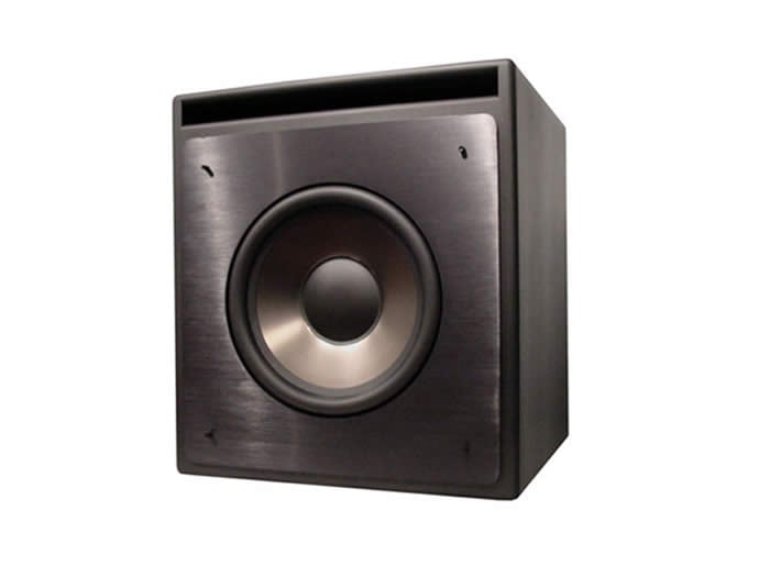

For the inside look we’ll use one of the KW-120 subs as the specimen of interest.
Peeling off the grill cloth, the sub appears pretty much as seen in Figure 3 above. The four studs to which the grill cloth is attached are actually the heads of the 4 bolts holding the aluminum fascia in place.  Removing the fascia we can then remove the driver.

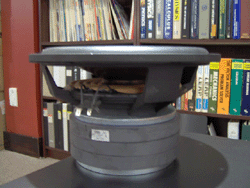

I laid the KW-120 on its back and proceeded to remove the bolts securing the driver in place. Once I had removed them all, I found the driver at first wouldn’t budge. It seemed like the thing was stuck in place. As it turns out, it wasn’t stuck at all. In actuality I had encountered a driver that was far, far heavier than I had anticipated. I haven’t weighed the driver and cabinet separately, but it wouldn’t surprise me at all if the driver turned out to weigh more than the substantial cabinet into which it is normally bolted.
Figure 7a – b: KW-120 Subwoofer Driver
Figures 7a - b are a couple images of the driver extracted from the cabinet, now sitting on top of it. Once out of the cabinet it was easy to see why the unit was so weighty. The motor assembly is an interesting structure with an interesting history. Kerry Geist, an engineer at Klipsch, wrote in response to my question regarding the possibility the motor assembly was originally designed for use in a larger drive:
Yes, the KW-120 uses essentially the same motor assembly as one of our 15" subwoofer drivers. However, the motor structure was further improved by adding a copper shorting ring to the yoke to reduce the distortion caused by variations in voice coil inductance. The advantage of using an existing motor design was simply a matter of using a design we already had experience with, and felt we didn’t need a huge engineering effort to develop into a 12” high-displacement version.  We already had plenty of engineering hours wrapped up in the original 15” design...we were just using that “developed” platform as a jumping off point to develop the 12” THX version.  The displacement and power handling requirements between the two drivers were very similar...it was an easy choice to make. Other than the shorting ring modification, I’m not aware of any other changes to the motor assembly itself.  The soft parts of the driver (cone, suspension, dust-cap, etc…) and housing were different of course.  As far as I can remember, the voice coil design is different, but they’re both based around a 3” diameter / 2” coil length format.”
Looking inside the now driverless cabinet, we get a great view of the interior. (Though not evident in any of the photos, the faceplate is double-thickness). There are a number of interesting features.
Figure 8a - b: Klipsch KW-120 Cabinet Interior
The cabinet is cross braced. The brace itself spans the top, bottom and side panels. It also serves to secure the substantial motor structure of the driver. The brace, along with the cabinets various panels, are reinforced with glue blocks placed throughout.
In the background of Figure 8a - b can be seen the interior end of the cabinets duct. The exterior end of the duct can be seen at the top of cabinet’s faceplate in Figure 3. The duct is in fact a collection of panels built into the interior of the cabinet, running parallel to the top and back panels. The interior end of the duct opens at a point just above the Neutrik input jack position on the back panel. The duct also serves as a useful handhold, which comes in handy when its time to move the cabinets around. The cabinets were not stuffed.

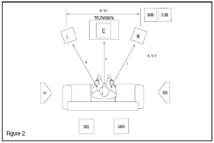

Figure 9: Speaker disposition as suggested by Klipsch Manual

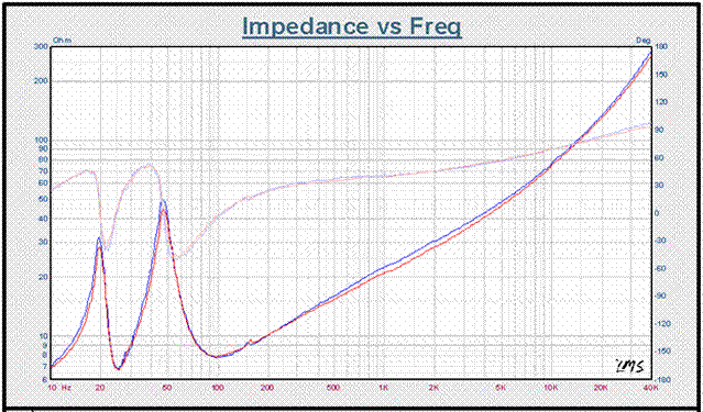

Figure 10: KL - 650 - THX Front LCR Speaker System Impedance Magnitude Curves

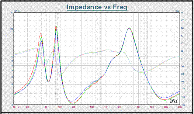

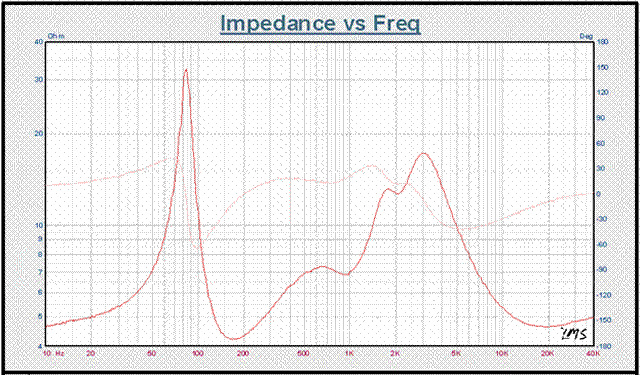

Figure 11: KL - 525 - THX Back Surround Speaker System Impedance Magnitude Curves
Figure 12: KS - 525 - THX Side Surround Speaker System Impedance Magnitude Curves

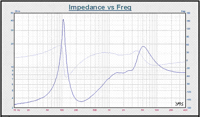

Figure 13: KW - 120 - THX Subwoofer Speaker System Impedance Magnitude Curves
Figures 10 - 13 are impedance curves for the various systems making up the Klipsch Ultra2 THX home theater system. In Figures 10 & 13 we see the typical saddle-shaped curve at the left, with the impedance minimum (5.3 Ω @ ~ 56 Hz for the KL-650 and 6.7 Ω @ ~ 25 Hz for the KW-120) in each case indicating the vented box tuning frequency. In Figures 11 & 12, the closed box tuning frequency is indicated by the impedance peak (32.6 Ω @ ~ 83 Hz for the KL-525 and 41.6 Ω @ ~ 107 Hz for the KS-525). The second peaks, seen towards the right in Figures 10 - 12 typically arise as a result the interaction of the crossover network's high- and lowpass sections, setting up a parallel resonance.
The global impedance minimum for the KL-650, KL-525, KS-525, and KW-120 are (respectively): 3.2 Ω (averaged), 4.2 Ω , 3.6 Ω , and 6.7 Ω . The respective system nominal impedance (per IEC standards) are therefore 4 Ω , 6 Ω , 4.5 Ω , and 8 Ω . Obvious from the measurements, no system ever went below 3.2 Ω , as per THX requirements.
The impedance phase swings between +40° and -60° (KL-650), +41° and -64° (KL-525), +60° and -65° (KS-525), and -46° and climbing towards 90° (KW-120). The impedance minima might give cause for concern, but keeping in mind the phase angle at the minima and the high sensitivity of the KL-650, KL-525, and KS-525 the systems shouldn't prove to be a difficult load for most AV receivers, especially THX Ultra2 certified ones.

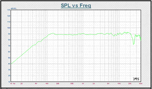

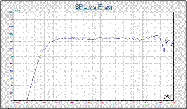

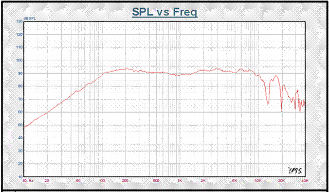

Figure 14: KL - 650 - THX system amplitude response, 1m, on-axis, 2.828 Vac drive level
Figures 14, 16, 17, and 18 show the amplitude response of the frequency response of the KL-650, KL-525, KS-525 and KW-120 systems, obtained by the application of gated, near field and ground plane measurements, as appropriate, scaled to 1m.
The relative flatness of the response curves (particularly with the KL-650 & KL-525s) underscores the tonally balanced & sonically accurate presentation of this very impressive system. It's easy to see how
the musicalness (ability to accurately render the timbre of individual instruments) of the system is as outstanding as it is.

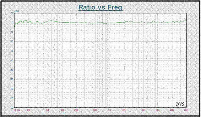

The grill cloth used by Klipsch is, acoustically substantially, substantially transparent. Figure 15 shows a comparison between dB spl measurements made with and without grill cloth in place. A perfectly transparent grill cloth would have produced a ruler-flat line, centered at 0 dBr. As it is, the curve is very flat and better than some I have seen of systems costing far more than the Klipsch Ultra THX2.
Figure 15: KL- 650 grill cloth effect on system amplitude response. Derived from measurements taken with & without grill cloth, 1m, on-axis, 2.828 Vac drive level.

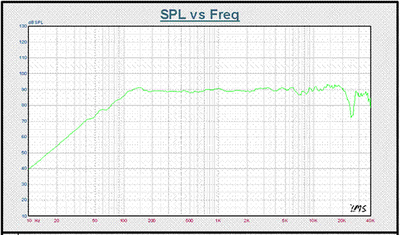

Figure 16: KL - 525 - THX system amplitude response, 1m, on-axis, 2.828 Vac drive level

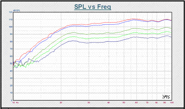

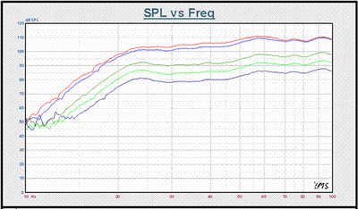

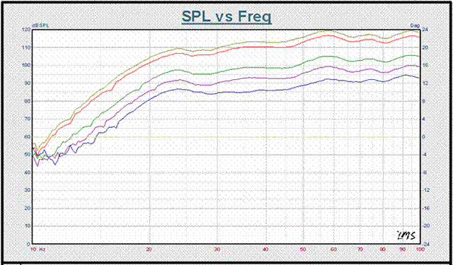

Figure 18: KW - 120 - THX single subwoofer amplitude response, scaled to 1m, on-axis, various voltage drive levels
Figure 19: KW - 120 - THX dual subwoofer amplitude response, scaled to 1m, on-axis, various voltage drive levels
The KW-120 were measured outdoors, using the ground plane technique. The initial measurement was made at 2.828 Vac drive level and increased incrementally. The dB spl curves showing in Figure 18 are for 1 sub, Figure 19, 2 subs. (Note: some of the curves look messy in the 10 - 15 Hz segment; this is due to environmental noise and should be ignored).Pairing 2 KW-120s and firing their combined acoustic output into 1/8th space (ie, 2 KW-120s placed side by side in a corner of a listening room) and the dB spl levels listed in the Klipsch spec sheet are reasonably obtainable.
