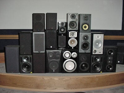

What is the point of a listening test? For the listener, the intent is easy to identify. They are (often) thinking of buying a product. They want to know if they like it enough to spend their hard-earned money. But for the salesman, the intent is not always so clear. Do they want a life-long customer? If so, they want you to be happy with your purchase and they'll make sure you buy the best product you can afford. Do they want a quick sale? Then they'll show you something that impresses at first blush, but maybe isn't something that you'll enjoy over the long term. Is the salesman working on commission or have they been instructed by their superiors to "push" a certain brand? Then who knows what product they'll try to convince you is the best for you. A tell-tale sign that you are going to be pushed is when the salesman tells you what you're going to hear before they press play.
Things get even murkier when the listening tests are run by a manufacturer. They have a vested interest in their product. They want their product to "win" or, at the very least, to not lose. They'll take a tie. Especially if it is a tie with a much more expensive speaker. But, as we'll see, a tie really isn't as great as it would seem at first.
So if you, the listener, isn't setting up the test, you have a lot to worry about. You have to worry about the potential bias and motivations of those that are setting up the test. You also have to worry about your own ability. If you aren't familiar with the room or the music/content, you're going to have a much harder time. Plus, you have to worry if the demo will test the speakers to their limits. Many speakers won't exhibit real problems until they are driven hard. If the demo doesn't drive the speaker to near its limits, you may never know of their problems until you get them home. So, many times, potential customers will have to rely on other things to help inform their buying decision. One thing that will draw a consumer is familiarity. If they've heard of a brand, they'll be predisposed to think that there is some value to them. Even more so if they've bought a brand in the past and haven't been disappointed. But this limits the pool of potential purchases to those with adequate advertising budgets or those that have drummed up enough of a following to have a vocal forum support.
