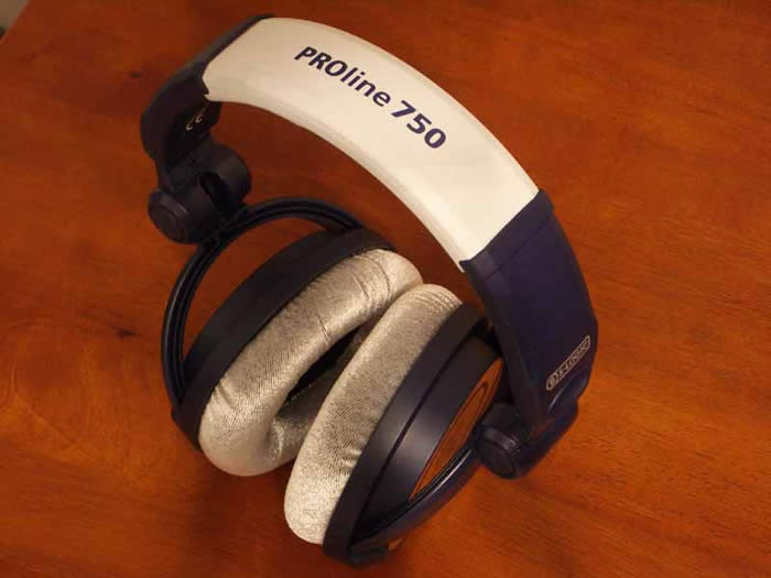

PROline-750-headphones.jpgThe Ultrasone PROline 750 headphones are a closed-back design. Closed headphones are modeled so that the music doesn't escape the headphone as with an open design, and is instead pumped directly into your ears. One advantage is that they also provide a level of noise attenuation from the outside ambience. In the case of the PROline 750's they reduce ambient noise enough to help isolate sound in loud environments (around 10dB or so). This is accomplished through having a tight seal around the entire ear with each headphone pad. The caliper pressure used was not uncomfortable, but I have to say, the experience of using closed headphones in general isn't for everyone and can be a bit disconcerting for the first few times. The velvet ear pads were easily removed with a simply twist and the inclusion of an extra set was a nice touch.

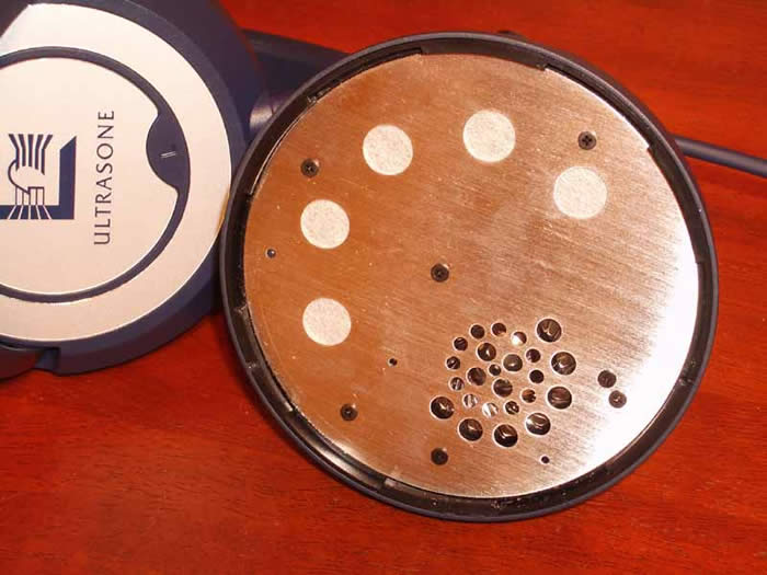

PROline-750_driver.jpgTaking a close look at the headphones with the ear pads removed reveals an off-center placement of the driver. This positioning is what, in part, makes up the S-Logic Natural Surround Sound system. The idea is that the sound will arrive at your ears in a method more consistent with external sound which interacts more with your ear's natural makeup. This is not a surround sound DSP system, mind you, but a method by which Ultrasone attempts to eliminate the "in your head" sound so often reproduced by headphones. The PROline 750s also have something called ULE technology which is comprised of MU Metal shielding in order to reduce magnetic field radiation caused when electrical signals are converted into acoustical energy. ULE is supposed to reduce 98% of that radiation compared to other headphones - something that professionals who are concerned with that sort of thing may wish to factor into their purchase.
