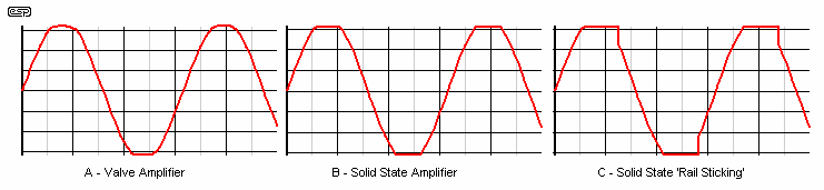

Clipping Distortion
How can one amplifier's clipping distortion sound different from that of another? Most of the hi-fi fraternity will tend to think that clipping is undesirable in any form at any time. While this is undeniably true, many of the amps used in a typical high end setup will be found to be clipping during normal programme sessions. I'm not referring to gross overload - this is quite unmistakable and invariably sounds awful - regardless of the amplifier.
There are subtle differences between the way amplifiers clip, that can make a very great impact on the sound. Valve amps are the most respectable of all, having a "soft" clipping characteristic which is comparatively unobtrusive. Low feedback Class-A amplifiers are next, with slightly more "edge", but otherwise are usually free from any really nasty additions to the overall sound.
Then there are the myriad of Class-AB discrete amps. Most of these (but by no means all) are reasonably well behaved, and while the clipping is "hard" it does not have significant overhang - this is to say that once the output signal is lower than the supply voltage again it just carries on as normal. This is the ideal case - when any amp clips, it should add no more nastiness to the sound than is absolutely necessary. Clipping refers to the fact that when the instantaneous value of output signal attempts to exceed the amplifier's power supply voltage, it simply stops, because it cannot be greater than the supply. We know it must stop, but what is of interest is how it stops, and what the amplifier does in the brief period during and immediately after the clipping has occurred.
Fig 1. Clipping
Figure 1 - Comparison of Basic Clipping Waveforms
In Figure 1, you can see the different clipping waveforms I am referring to, with "A" being representative of typical push-pull valve amps, "B" is the waveform from a conventional discrete Class-AB solid state amp, and "C" shows the overhang that is typical of some IC power amps as well as quite a few discrete designs. This is a most insidious behaviour for an amp, because while the supply is "stuck" to the power rail, any signal that might have been present in the programme material is lost, and a 100Hz (or 120Hz) component is added if the clipping + "stuck to rail" period lasts long enough. This comes from the power supply, and is only avoidable by using a regulated supply or batteries. Neither of these is cheap to implement, and they are rarely found in amplifier designs.
Although Figure 1 shows the signal as a sinewave for ease of identification, in a real music signal it will be a sharp transient that will clip, and if the amp behaves itself, this will be (or should be) more or less inaudible. Should it stick to the supply rail, the resulting description of the effect is unlikely to accurately describe the actual problem, but describe what it has done to the sound - from that listener's perspective. A simple clipped transient should not be audible in isolation, but will have an overall effect on the sound quality. Again, the description of this is unlikely to indicate that the amp was clipping, and regrettably few amps have clipping indicators so most of the time we simply don't know it is happening.

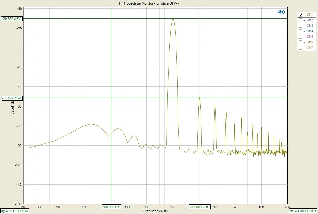

The possible reasons that amplifiers had specific sound characteristics were becoming a popular topic among audiophiles in the early 1970’s. There was a 1973 meeting of the Boston Audio Society that featured a presentation by a test equipment maker (I forget which) that could display the spectral characteristics of an amplifier’s THD. This was pretty heady stuff in the early 1970s. A very popular receiver at the time, the Marantz 2270, was well-known for sounding harsh if pushed too hard. At this BAS meeting, we found out why:
Even though its actual distortion rating was low (probably 0.3% THD @ rated output), the scope/analyzer showed that when it hit its clipping point, the Marantz exhibited large amounts of higher-order distortion products.
As we know, harmonic distortion is the unintended signal products generated by an audio device such as a speaker or amplifier that are whole number multiples of the original signal. For example, if an audio device is tasked with trying to reproduce a 40 Hz signal, and instead produces 40 Hz and a small amount of 80 Hz, the 80 Hz product is called harmonic distortion. Small amounts close in multiples (lower-order) to the original signal are barely audible; larger amounts of distortion in greater multiples away from the original signal (higher-order) are grossly objectionable to the human ear. (Remember the harmonic structure of Western music is based on octaves and 3rds, so 2nd and 3rd-order distortion is harmonically-related to the music in a way that we do not find dissonant or audibly offensive.  Lower-order THD has to be pretty significant before we notice it in a negative way.) The sum total of all harmonic distortion products is usually expressed as a percentage of the original signal, or % Total Harmonic Distortion (% THD).
Emotiva FFT
FFT Distortion Analysis of Emotiva UPA-7 Amplifier at Near Clipping - notice the higher level of harmonic distortion products (ie. 2kHz, 3kHz, etc)
On the scope, we could clearly see that the Marantz produced large amounts of 4th-, 5th- and 6th-order harmonics when it was pushed into clipping. A Pioneer receiver there for comparison was better behaved and its distortion was composed mostly of 4th-order and lower components. An AR receiver showed by far the best distortion behavior, with most of its harmonics being very benign-sounding 2nd- and 3rd-order products. Now, finally, there was a concrete, repeatable, tangible explanation for why some amplifiers sounded better than others when pushed into clipping.

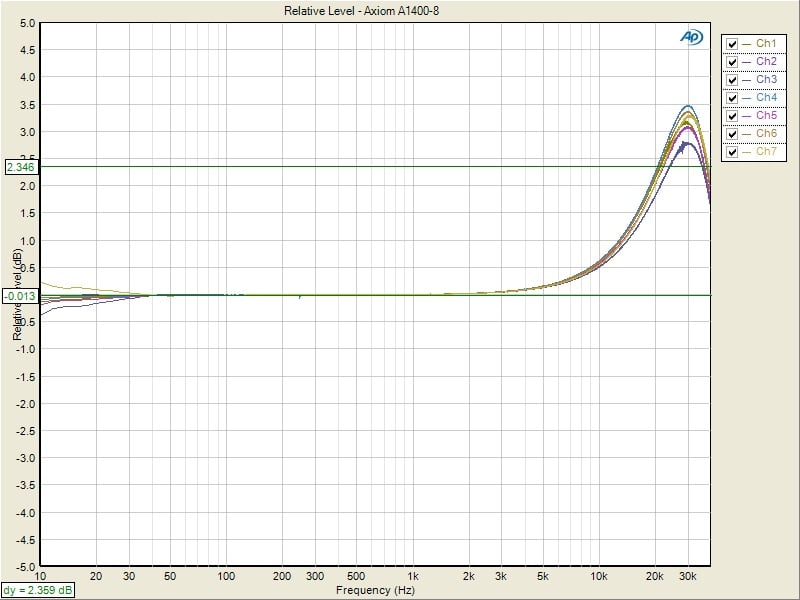

Frequency Response of Axiom Audio Class D Amplifier would change radically depending on the load impedance it was driving.

As a general observation, it’s amazing how often regular ol' frequency response turns out to be the causal factor in definitive, repeatable sound differences (assuming no gross distortion). The FR variations may have been caused by many different factors, such as interaction between components or connectors or other issues. The underlying equipment itself may not have any inherent FR errors or problems, but when used in combination with specific associated equipment, FR variations suddenly crop up.
This is one of the potential problems of assembling high fidelity component systems for which the average consumer has no solution or remedy. Pre-amp “A” from this company + power amp “B” from that company + speakers “C,” source unit “D,” interconnects “E,” and speaker wire “F” all seem on paper to add up to one terrific system.
But due to circumstances completely unforeseen and unavoidable, they combine for an ever-so-slight FR variance that leads the user to conclude that this or that component is to “blame,” especially when the variance occurs after the latest component change.
This is either a strength of so-called “closed” all-in-one systems, where every link in the system’s chain is controlled by the system designer and one can reasonably expect every part of the system to work correctly with every other part. Or…the all-in-one customer (shelf system, docking station, soundbar, etc.) is so uncritical that even if there are slight FR errors along the way, that customer never notices or cares.

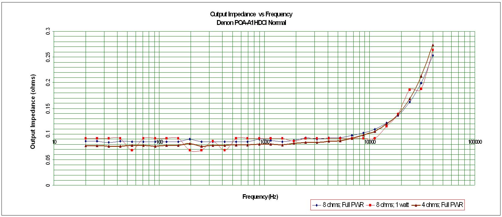

The output impedance of any amplifier is finite. There is no such thing as an amplifier with zero output impedance, so all amps are influenced to some degree by the load. An ideal load is perfectly resistive, and has no reactive elements (inductance or capacitance) at all. Just as there is no such thing as a perfect amplifier, there is also no such thing as a perfect load. Speakers are especially gruesome in this respect, having significant reactance, which varies with frequency.  A genuine zero impedance source is completely unaffected by the load, and it does not matter if it is reactive or not. If such a source were to be connected to a loudspeaker load, the influence of the load will be zero, regardless of frequency, load impedance variations, or anything else.  Since this is not the case in the real world, the goal (or at least one of them) is generally to make the amplifier have the lowest output impedance possible, in the somewhat futile hope that the amp will not be adversely affected by the variable load impedance. In essence, this is futile, since there will always be some output impedance, and therefore the load will always have some influence on the behaviour of the amp.
 Denon Amp
Denon 10CH Amplifier Output Impedance is commendably low
Another approach might be to make the output impedance infinite, and again, the load will have zero effect on the amplifier itself. Alas, this too is impossible. Given that the conventional approaches obviously cannot work, we are faced with the problem that all amplifiers are affected by the load, and therefore all amplifiers must show some degree of sensitivity to the speaker lead and speaker.
