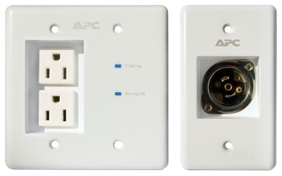

For projectors & wall mounted TVs, "power bridge" type products allow you to only buy one surge protector for all your electronics

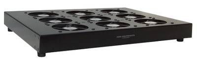

All too often gear is stacked right on top of each other, shoved in a cabinet with no ventilation, or crammed together with no room between components. Each of these situations will cause equipment to operate at higher temperatures than intended, which can lead to poorer performance and deceased lifespan. To ensure cool operation, give each component about 2 inches of space on all sides, drill holes in closed cabinets to allow airflow, and stack the hottest components (typically DVRs and AV receivers) at the top of the equipment rack. In some situations you may want to add a cabinet fan or component fan. A simple solution I often recommend is a fan from Cool Components and a TC-ALTv2 fan controller that will automatically turn on the fan when the air reaches a set temperature. Of course, there are cheaper DIY routes you could use as well.
In addition to cabinet ventilation, you can get fans designed to set directly on top of components

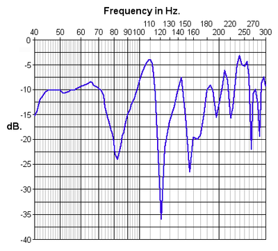

Closely related to properly applying acoustic treatments is properly positioning speakers. This is especially true when it comes to subwoofers. As low frequency soundwaves interact with a room, standing waves are created. Standing waves can boost sound at certain frequencies and cause dips at other frequencies. These boosts and dips vary based on subwoofer and listening positions locations. I often demonstrate this to clients by placing their subwoofer in a corner (corners tend to cause the most dramatic swings in frequency response), playing bass heavy music, and asking them to walk around the room and listen to how the bass changes. Invariably, at some locations the bass is extremely loud, while at others it’s so quite you would think the subwoofer is turned off.
This is an awful, but typical, frequency response plot. Notice the -35dB null at 120Hz.
If your listening position happens to be in a dip, you will likely keep turning up the subwoofer volume because it sounds like the bass is too quite. However, increasing the volume won’t help because it’s an issue with the room, and you will end up driving the subwoofer harder and harder until the point of failure. By moving the subwoofer and/or listing position to a more ideal position, you can enjoy more even bass and won’t be tempted to turn up the subwoofer volume to overcome an issue with the room.
