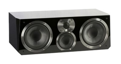

Center Channel Placement and When to Use Two Center Channels
Center channel placement is fairly straight forward. With today's processors the distance from the center channel to the listener is not terribly important. There are still a few things to be careful of. First the center channel should be centered about the TV screen, even if the screen is not centered between the two main speakers. The center channel is the dialog channel, and it should appear that the dialog is coming from the people speaking, not elsewhere. It is of course recommended that the TV screen be centered between the two main channels, but sometimes this is not possible. Second, the center channel should be located as close to the screen as possible without causing visual interference or electro-magnetic interference with the TV. Most center channels are well shielded (or have a neutral magnetic field) so the latter is not a problem.
Most center channels are limited in bass frequency so their placement relative to the rear wall is not very critical. If they do have full range capabilities, then it is recommended they are placed the same distance from the rear wall as the main speakers if possible.
Another caveat to avoid is placing the speaker too high or too low. This can cause reflections off the floor or ceiling and degrade the clarity of the center speaker. If the speaker must be close to the floor or ceiling it is best to put some sound absorbing material on either the floor or ceiling to absorb the first reflection of the center channel. If it is on the ceiling products such as sonex work well, if it is on the floor an area rug can be very effective.
Lastly, is to determine when 2 center channels are warranted. Many people like the idea of 2 center channels because there is a lot of sound coming from the center channel, and 2 channels can handle that better than one. It is estimated that the average movie soundtrack has 60% or more of the sound directed at the center channel. Also, many people with projections screen TVs do not like the notion of sound coming from above or below the screen, and therefore try a speaker above and below. All of this may seem well and good, but in most cases 2 center channels are more problematic than they are worth. Typically you wind up with interfering wave patterns between the two speakers that cause areas where certain frequencies are cancelled out and other areas where they are doubled. If this seems difficult to understand imagine dropping a pebble in a pool of still water. The ripples radiate from where the pebble entered the water. Now drop a second pebble in the water in a different location, and you can see how the two ripple effects interfere with each other. This is similar to what happens with two center channels. It is not a problem with stereo channels, because their signals are different and designed to function in a stereo mode. But with two center channels the signal is the same and thus the interference pattern. In general we recommend avoiding 2 channels, and rather than buy 2 center channels, and the necessary amplifiers, buy one better center channel.

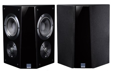

Rear speaker placement, dipole vs. direct radiating.
First is to determine which, dipole or direct radiating speakers should be used. Lucas THX recommends dipole speakers for the rear channel movie soundtracks. This is generally good advice for larger theaters where you will seat 8 or more people. The dipole has the advantage of disappearing as it is producing sound in two directions at once. It is unlikely that any one person will have it directly radiating at them, but rather it will be producing a large area of sound in the rear of the theater.
Direct radiating speakers frequently sound better for smaller theaters that seat fewer people. The advantage is that they can better define the rear soundstage. This can be very impressive when that jet flies overhead. However, they have the disadvantage of being a point source and clearly defined, particularly if someone in the theater is seated to close to the speaker. In this case the rear speaker can sound too loud for that individual and can be annoying rather than the great special effects it was meant to be.
There is also the new 6.1 sound field which uses 2 dipoles and one center rear channel. This can offer the advantages of both direct and dipole. However, it should be used with caution, as soundtracks currently are not mixed with this format and all processors are interpolating the center channel sound field. If you frequently change equipment, you should consider the possibility that this format may not be accepted in the future.
Some processors, like the Lexicon, use a combination of both. This can be very effective in very large theaters. However, the added speakers and amplifiers can be very expensive. Therefore, as it is not often used we will handle this type of theater on a case by case basis. Again, you should consider whether or not you will change equipment with a feature like this will still be available in the future, or if it will have been replaced by another format.
Once you determine what your theater will be like and which speakers you will use then you will have to figure out placement. We do not recommend placement based entirely on frequency response, but rather based on listener position. Dipoles are the easiest to place. If there is one row of seating the center of the dipole should be parallel to that row. If there are two rows, it should be between the two, approximately 2/3 back from the first row. Dipoles can either be ceiling mounted or wall mounted. Wall mounted is generally preferred and the dipole should be at approximately the listener's ear height or sometimes slightly higher. In these cases we do want the reflective surfaces near the speakers as this reinforces this channel, and it is not designed to have much in the way of clarity. It is really designed for effects. It is interesting to play the rear channels of a movie soundtrack through the main speakers with all other channels off. This way you can hear how little information and typically limited bandwidth these tracks have on them. It is also for this reason; we do not recommend spending large sums on the speakers for the rear.
If you have decided on direct radiating speakers this will improve the rear effects, but there are some things to be careful of. They can not be too close to any listener or they will be annoying. Placing them near the ceiling and far back in the room is generally a good idea. If they are full range speakers, you may want to be somewhat cautious of getting them too close to the corners as it could over re-enforce the bass on the rear channels.
Lastly, if you are building a new theater, we recommend that you wire for dipoles, rear direct radiating, and a center direct radiating speaker. The wiring is an inexpensive investment now, and it will almost insure that you are prepared for new formats.

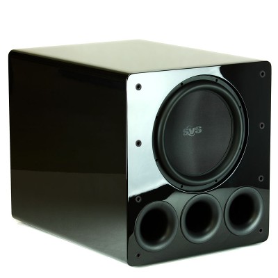

Subwoofer Placement and Number of Subwoofers
This can be the most difficult speaker to place. There are a variety of reasons for this, but in general, bass frequencies are most affected by their placement in the room. First let's examine placement with one subwoofer. This is actually the most difficult. Subwoofers can either be placed in corners, where they have the benefit of sound reinforcement from adjacent walls. This means less amplification is required and less distortion on the sound the woofer is producing. However, this comes at a price. While many subscribe to the thought that bass is omni directional, a woofer placed in one corner can usually be detected as being in THAT corner. Omni-directional does not necessarily mean it can not be detected as a sound source. The other expense is that corner placement excites room modes and generally delivers less than a flat frequency response.
When we calculate room response curves theoretically, we do it to find out how flat a response we can achieve. This usually yields a subwoofer placement that is slightly off center in the room and fairly far out into the room. This gives us a good idea of how flat we are able to achieve, but inevitably this is not the best overall sound for the subwoofer. It is for this reason that we do not even specify subwoofer placement, rather we give a location where we found the flattest frequency response.
There really are two potential locations, near center and near the rear wall (within 1/8 of a wavelength of highest frequency the subwoofer is set to produce*), or in a corner and within 1/8 of a wavelength of that corner. We recommend that you try both of these locations. If you can not distinctly detect the subwoofer when it is in the corner, then this is a good place for it. Otherwise, move it to the center.
If you have two subwoofers, corner placement behind the main speakers is almost always the best placement. These should be within 1/8 of a wavelength to the corner they are placed in. If you can afford a second matching subwoofer, this is generally preferred to a single more expensive subwoofer.
Getting the subwoofer in phase can be a little tricky for a novice. The best way is to use a test tone at the crossover frequency of the subwoofer. Play this tone and adjust the phase so that the tone is the loudest at the listening position. Using an SPL meter can be a great help here. When it is at the loudest the subwoofer is in phase.
* Note: 1/8 of a wavelength (in feet) = 1130/wavelength * 1/8 Thus for a 80 Hz wavelength = 1 foot 9 inches
