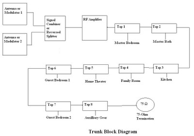

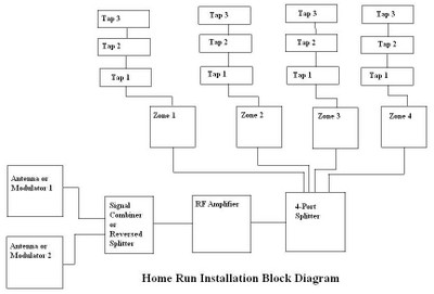

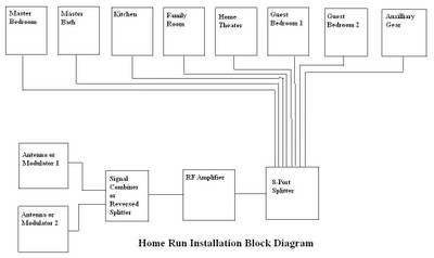

When creating an MATV system, and before getting into the specifics of the installation, you must decide on the type of distribution you want. There are two possible lay-outs. To add spice to the RF stew, it’s also possible to combine the two to make a hybridized distribution system. You must choose between a “home run” layout where the coaxial cable from each antenna locations runs directly to a single distribution point in the equipment closet, or a “trunk” layout where each antenna drop is tapped into a master trunk. Each system has its own merits and deficiencies.
A home-run system is exactly what it sounds like. Each coaxial cable runs directly from the antenna port in the remote location home to the master distribution location where it is connected to a multi-port distribution block. This configuration is sometimes known as a “star topology.” The advantage of this layout is an easy opportunity to control interference from port-to-port, easy solutions for ground-loop interference, and ease of balancing delivered signal power. Additionally a home-run system simplifies equipment selection as field measurements are predictable and system performance often mimics theoretical expectations to a great degree. The disadvantage is that you’ll end up running a lot of coaxial cable and you’ll have to deal with a large bundle of cables at the demarcation location.
A trunk-based system uses a single master “trunk” line to distribute the signal. Each drop is then set off a tap. The number of taps must be carefully analyzed to provide balanced signal levels at each drop location and the entire system must be properly terminated to maintain 75-ohm characteristic impedance. A trunk system’s greatest advantage is the ability to cover lots of space with a minimal amount of wire. A single line can be run several hundred feet and feed dozens of drops. The disadvantage is that every device connected to the trunk can affect every other device, so careful planning and equipment choice is critical.
