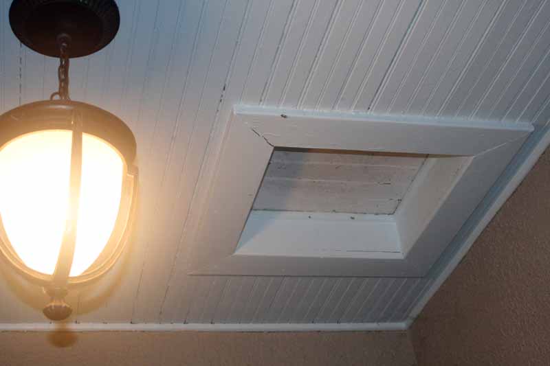

frank-attic.jpgThe attic access was at the back of the house… of course. We're "professionals" so we used a ladder that was too short. This was OK, though 'cause we put it on top of a table so it would reach. No, I'm not kidding. Don't try this at home... or if you do, don't blame any mishaps on us - we told you not to.
It was hot in the attic, but we had two things going for us: 1) Frank had some light up there thanks to his electrician, and 2) it was summer here in Florida. Wait, that second one didn't help us at all. Here in Central Florida, "hot" is a relative term. This time of year it's comfortably hellish. By the end of Sumer there will be fire and brimstone and we'd risk spontaneous combustion.
We made our way to the back of the attic where the room was. Frank came with, largely because he's not a girly man and doesn't mind a little dirt… or emphysema for that matter (wear masks if you go into an attic with Fiberglas insulation). We located the AC vent and quickly tracked down the header which was right where we expected. A couple holes later (we used a 1/2-inch spade wood bit) we were into the wall.
We brought the Impact Acoustics CL2-rated 12/2 speaker cable with us (not really, we forgot, but it makes for a good story) - and decided to run the first pair (the fronts) by using electrical tape to tie both wires to my drill bit extender. It's about 18-inches long and heavy enough that it will drop all the way down the wall. Frank went down below and we lowered it down the wall cavity. It came out perfectly.

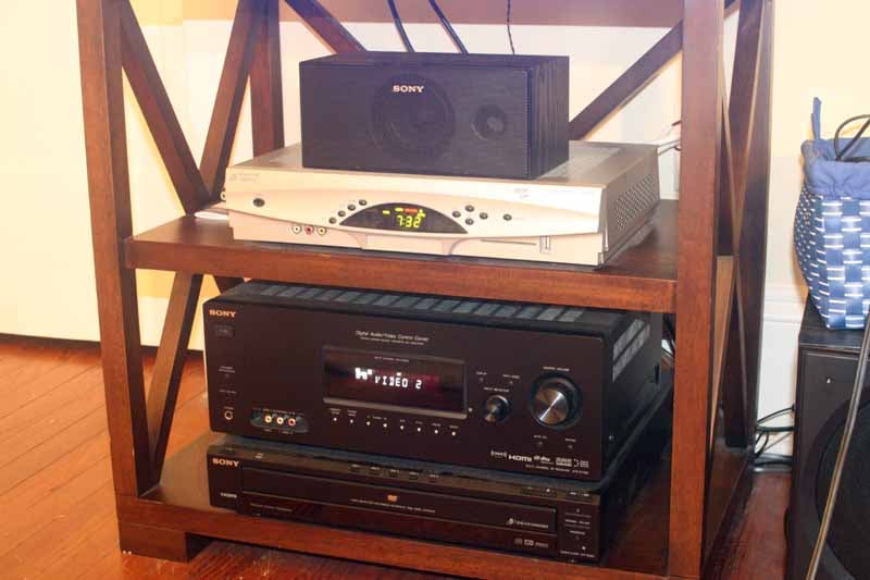

frank-rig.jpgI pulled into Frank's house and walked into the living room. He'd already installed the Sony HTiB system I recommended. While I'm not a Sony fanatic, this system was both easily accessible from the local big box store and it had HDMI switching and component video inputs. It just seemed like a really good value, especially since the room was small and didn't require lots of power. All four speakers were mounted and the center channel was placed directly underneath his LCD television. Now THAT'S what I'm talking about - enthusiasm. We might just make an Audioholic out of Frank yet. I ran the setup and tweaked the system, instantly reminded of how bad Sony's menus are and how they were made by people with no sense of either the English language or best practices of system calibration. After much weeping and gnashing of teeth I was able, through the use of the manual, to discover the means of setting levels, speaker size and changing the orientation of the speakers to be recognized as ceiling-mounted. I've literally calibrated dozens of systems - having to use the user manual to figure out how to set levels and get a test tone means that your device is most certainly NOT user friendly. Sony makes nice TVs but in my opinion their entry level receivers leave much to be desired.

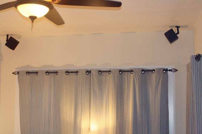

We pointed the surround speakers together rather than towards the middle of the room to create a more diffuse surround soundfield.
You can barely see the hole where the speaker wire emerges from the ceiling. Much less intrusive than a fully exposed speaker binding post wall plate.
Video was a bit messed up due to a bad HDMI cable or connection - we never did figure out exactly which it was. Thanks, HDMI. Wiggling the connection caused the HDMI video to drop out. That's about as much fun as using a screwdriver as a toothpick. I replaced the cable and rustled up another optical cable to ensure everything had surround sound (the HTiB didn't support HDMI audio and thus lacked any ability to handle high definition audio). This wasn't terribly important for now since we were using a regular DVD player (also Sony). The good thing is that the system uses standard speakers and a receiver, so upgrading is possible one component at a time.
We popped in some DVDs and cranked up the system. I pulled out Gladiator because, well, it's a great way to impress people with a new home theater. The opening scene of the Roman army's attack is impressive and it has lots of information in the surrounds, which I tweaked up in level just a tiny bit (know your audience). I next tried some multi-channel music with a DTS CD. It sounded OK, but not all that great (not surprising given the constraints of the system, so I wasn't complaining too much). I quickly realized that the "subwoofer" left much to be desired, mostly because it was too small and underpowered for the room (who am I kidding - for any room). The room itself was also not sealed off from the rest of the house, having two French doors which opened to a formal living area. All we could really do was move some of the "dead spots" around so that they didn't land on our primary seating positions. We couldn't move too much, however, since the sub ultimately had to live in the front right corner. I moved the sub out a tad from right beside the equipment rack and the mode left the back of the room - which was a pleasant change. We ran with that and called it a day.
