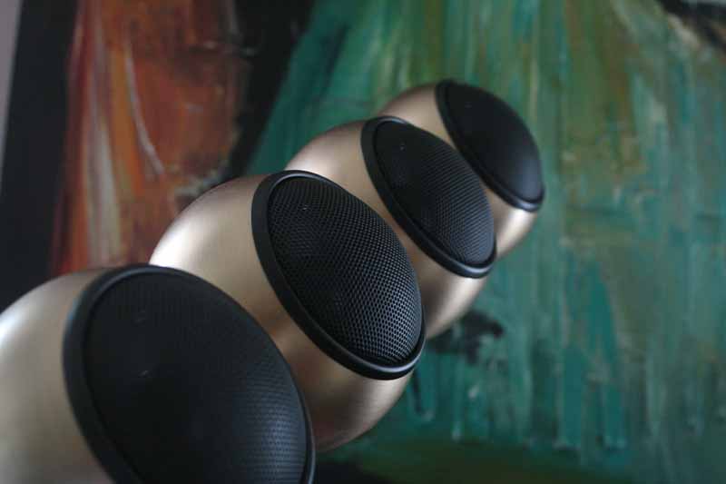

Mod4-speakers.jpgI knew that this install would involve an older home on a nicely-raised, open crawl space. As such, I wasn't anticipating much in the way of difficulty. The other nice thing was that we quickly decided on installing a beautiful set of Orb Audio Mod4 speakers on their massively overbuilt HOSS Floor Stands. This was mostly because they met with our aesthetic requirements and didn't dominate the room. That meant that we just needed to run a pair of Impact Acoustics CL2-rated 12/2 speaker cables from the front of the room to the back. None of the speakers were being mounted from the ceiling, so attic access was unnecessary and we avoided all sorts of potential hassles. I was actually tempted to think that this particular install might actually be completed in just a couple hours.

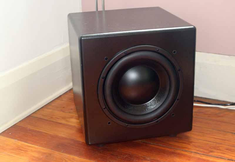

Uber-Ten-sub.jpgThe only things left to do was label and connect the speaker wire to the 2-pair Speaker Wire Binding Post Inserts on both sides of the room. This was done quickly and we proceeded to clean up and replace the baseboard across the former fireplace. Moving the television back into place we were ready to setup the speakers and subwoofer, however I had other plans and needed to push that off for our final day.

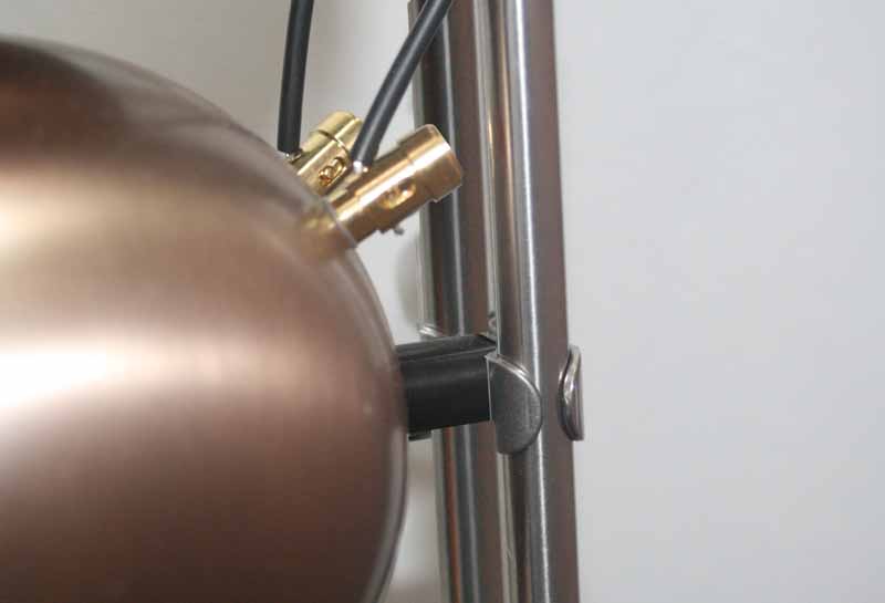

HOSS-connections.jpgMitchell was excited about his new system - so much so that I found he and a friend had connected most of the wiring themselves just to be able to crank it up and listen to it purr... I love self-motivated people. When I arrived on the scene I found everything close to correct. The subwoofer had been left unconnected and the center channel of the Orb Mod 4 system was connected in parallel instead of series - dropping the speaker impedance load a bit lower than intended or desired. I fixed this quickly and proceeded to connect the sub to the line level output of the AV receiver - a Denon AVR-3300. This receiver was actually quite good in its day and even has support for Dolby Digital and DTS - everything that this particular system would need.
