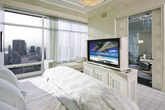

bedroom systemEach of the 11 TVs in the apartment is completely flush-mounted - going so far as to hide the bezels. And while that provides a strikingly clean appearance, it’s hardly the ideal installation. That’s because with the exception of the screens, the TVs had to be fully enclosed in the walls, making access for servicing difficult.
“In a normal world, it would be the last thing we would do, but the architect and homeowner wanted it this way,” says Montgomery. EDG had to go through a rear wall to service one TV. The TVs are ventilated into cavities in the walls above the units.
Installation of the TVs had to take place before the Sheetrock went up EDG had to make sure the wiring and all the connections were perfect as well, because servicing would require making holes or disassembling a wall.
