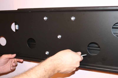

The mount itself is built like a tank. The arms are securely bolted to the frame and all of the fastening points were stamped steel, rather than welded, so there are hardly any points at which the mount suffers any weak spots. The tilting arms are also well-constructed, allowing for user adjustment of the tension amount, so that tilting can be rendered permanent, or loosened up to allow for continuous adjustment. An allen bolt is provided to secure the arms to the mount in s away that prevents the TV from sliding or tilting off of the mount itself. To aid in setting up the mount, a bubble level is integrated into the base of the mount, allowing you to get it leveled up as best as possible before mounting the TV. Once everything is marked, it's simply an issue of pre-drilling your holes and then driving the included bolts to secure the mount securely to the studs. You'll know when it's secure - it's a tight fit and you'll instantly feel confident about the mount's ability to hold even a larger-sized television.
The thing about levels is, it doesn't mean you can perfectly align the mount regardless - unless there's a method of adjusting the rotation of the TV mount once it's mounted. In this case, there is. If you look at the front plate (removing the display if necessary), you will notice 5 bolts that hold the front plate to the arm assembly. The 4 outer bolts are in slotted holes. If you loosen them, you can rotate the front plate till it is level and then tighten the bolts back down to hold the plate securely in place.

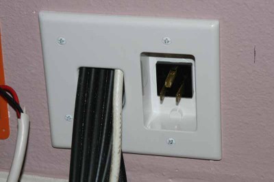

Once we had the mount in place, it was time to turn our attention to the Recessed Pro Power Kit. This would provide the real magic. It's the way we'd be able to hide all of the cabling and allow the mounting of the TV in a way that would cause it to appear to be "floating" on the wall. Because of our TV size and the location of the existing power outlets at the bottom of the wall, we decided to mount the Recessed Pro Power Kit just to the right of the mount. For some, the best choice may be to mount it over top of the display mount. Be sure to measure your display and anticipate where the physical dimensions of the TV will be as well as the cabling. Since we planned our install, we were able to keep everything within the same stud cavity - the preferred method of running the cabling since it involves a direct run.

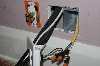

After cutting our holes, we ran the 12/2 power cable through the included remodel box and the low voltage HDMI and component video cables (as well as our RF cableTV line) through the remaining opening. The source end of the Recessed Pro Power Kit comes with cable leads, rather than screw-down termination connections, so you'll need to use the included wire nuts to make your final connections. As for the low voltage runs, don’t forget to pull the cables through the opening before you run them up (or down) the wall to or from the TV.
Editor's Note: When using wire nuts, be sure to use electrical tape to secure the nuts to the wire and prevent an eventual short in the event that they would work themselves loose over time.
The finished wiring job presents itself as a very neat and tidy arrangement:
