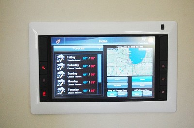

The g! system accomplishes these and other feats by seamlessly integrating a variety of electronic systems under one main control processor. Tied together in this home are a whole-house audio and video system, lighting, heating and cooling, security, surveillance cameras, motorized window treatments, irrigation and pool and spa controls. All of these systems can be monitored and managed via the homeowners’ three iPhones, two iPads, 12 Elan remotes, nine in-wall Elan touchpanels and a wireless Elan tablet.

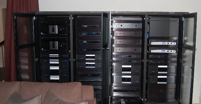

racks and racks
The house is packed with gear, including 11 flat-panel high-def TVs, two of which are 3D TVs with LG 3D Blu-ray players and another that’s a 46-inch weatherproof SunBrite TV. Every TV can access four DirecTV boxes, two Sony 400-disc Blu-ray changers and eight surveillance cameras. A total of 54 speakers and seven subwoofers, as well as 12 outdoor speakers and two subwoofers throughout the house complement the video. Each listening space can receive music from a rack of centrally located equipment including a dual AM/FM tuner, a three-terabyte hard drive (enough space for 600,000 songs), two iPort tabletop iPod docking stations, Pandora Internet radio, XM Satellite Radio and feeds from the intercom system.
Elan control screen
