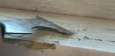

First off, this is a big deal and the federal government is serious about how lead paint gets handled. With the Lead-Based Paint, Renovation, Repair and Painting (RRP) rule, pretty much anyone that disturbs painted surfaces that might contain lead must follow certain prescribed procedures, classes, certifications and safety measures to contain the work area, minimize dust and completely clean up when they are finished. This rule applies to any and all contractors. This means that if you work in electrical field,  mechanical, renovations, plumbing, painting, maintenance and, yes, even custom electronics installation; you probably will come into a situation where you will need to be certified. Also, if you ever have to replace windows and interior or exterior doors, then you also have to be certified. The rule says that if you disturb more then six square feet of lead paint on the interior or twenty square feet on the exterior of a building that was built before 1978 and the building is a home, school, day care center or anywhere children under the age of six spend time, or if there are pregnant women present, then you need to take notice and comply with the rule. There are no longer any exemptions possible.

lead paint renovationThis was the fun day; I had to get up at 3am so I could drive 4 hours to my nearest learning center for the hands-on class that was to last from 8AM to 12PM. Upon arriving at the learning center we all sat down for some helpful presentations and some great question and answer time with the instructors that were there. The hands-on class really just reinforced all the critical aspects of the on-line class to make sure that it was drilled into our heads what we are supposed to do once we became Certified Renovators. There was a lot of discussion on the health problems associated with disturbing LBP (Lead-Based Paint) and how it really affects young children with often life-long problems, hence the rules that have to do with schools and day-care facilities. A portion of the hands-on class was devoted to testing methods to detect if lead is present the paint.   Also there was discussions on how to properly set up a work site, how to contain the work area and how to minimize dust. Since I am in the renovation business, some of the topics in this area were pretty much best practice for us much in the same way we try to minimize the spread and inhalation of demolition and  drywall dust when we are working on a project. The biggest things to take from this is to minimize dust and to use a HEPA dust collection system as much as possible when using power tools. There was also the clean up procedures that are designed to minimize contamination to other parts of the building and other people that might be nearby.
