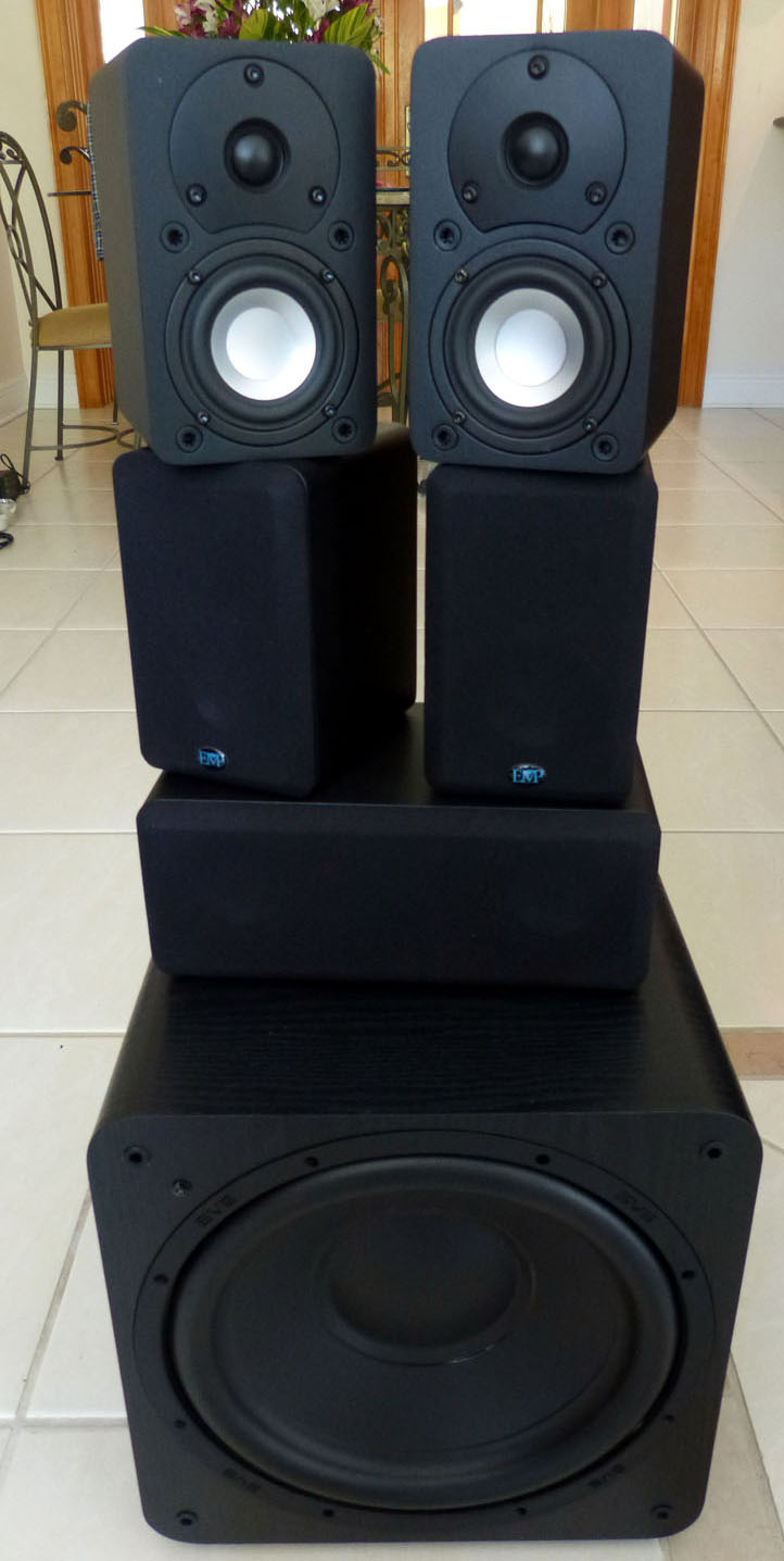

The Speaker Selection: EMP Cinema Compact System & SVS SB-1000 Subwoofers
EMP-SVSI proposed a few speaker options to our friend and he was  insistent upon having the smallest speakers possible. This led me to recommend the new Cinema Compact 5 Home Theater system from EMPtek. The E3b mini-monitor is roughly the same size as the Bose Acoustimass satellite speaker and the E3c center channel is a bit deeper and wider than the Bose counterpart, but the height is the same. Considering the center channel was to be placed on top of the wall unit which had tons of horizontal and vertical space, this worked out nicely. Our dentist friend wanted the sub to be placed inside of the cabinet, which was roughly a 14” enclosure. This meant the matching EMP e10S subwoofer wasn’t an option, nor ironically was the Bose bass module they wanted to use from the very beginning. The new SVS SB-1000 fit the bill nicely being a 13” cube and also being a very affordable $500/ea shipped!
I explained to our dentist friend that a small speaker system like this doesn’t produce much bass and needs dual subs to compensate. In addition, having dual subs would produce a more consistent and even bass response throughout the room. He understood this very well, especially considering the subs wouldn’t be obtrusive sitting inside of the on-wall cabinet. I did ask him to leave the two subwoofer locations completely open at the front and sidewalls for performance reasons and he obliged. Success so far.

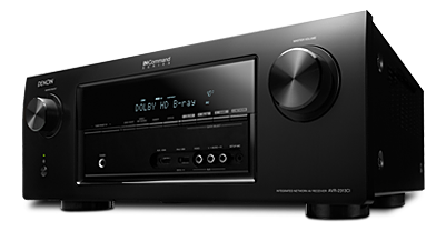

Denon 2312CIDenon AVR-2313CI A/V Receiver
MSRP: $899
I’m a big fan of Denon A/V receivers. They have solid amplification, great bass management, high reliability and they’re jam packed with features. The AVR-2313CI is rated at 105wpc x 7, supports all the latest HD audio and video formats with 4k video pass-thru for the future.  It has dual subwoofer output connections so you don’t need a y-splitter when installing dual subs. The inclusion of Air Play allows you to stream audio to the receiver from your Apple device. The Denon Remote App also allows you to control the receiver from your Apple or Android device.

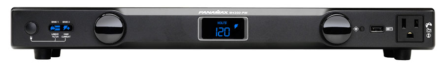

The Panamax MR4300 Power Center
MSRP: $299
This is a neat, affordable power conditioner/surge suppressor that boasts 8 outlets and 1 USB charger.  It also has front panel rotary lights for easy viewing and is designed to meet UL safety and regulatory tests, which is often not the case with competitor products at this price point.
