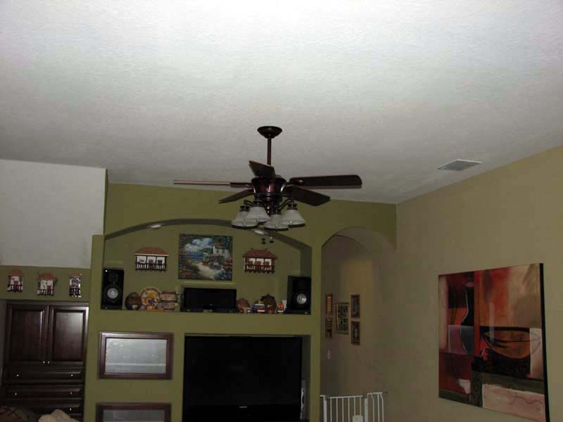

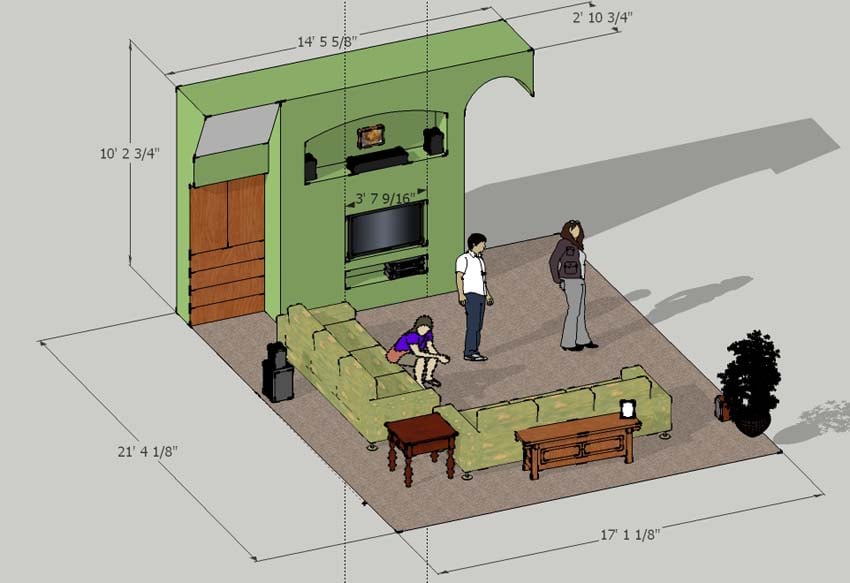

RoomI chose to perform this experiment in the Family Room system of the Audioholics Showcase home. This room is quite typical of what I’ve seen in many homes. It has 10ft ceilings and is open to the rest of the house which makes it quite challenging to get good sound in, let alone respectable bass response. For the past three years, I was using the venerable Axiom EP500 subwoofer located towards the left front of the room behind one of the couches. For a single subwoofer installation, I found this to be the best location for performance and aesthetics as the couch and blinds did a great job hiding this beast.
Considering the room dynamics, I was mostly pleased with the results. What really impressed me was the ability of the EP500 to shake the entire room which if you factor in the kitchen is about 10,000 ft^3 of listening space. Bass was well extended and tactile. In fact for the left couch where the sub was placed behind, it was a bit too tactile which unfortunately lend itself to being localized for the listeners that got stuck sitting there, usually my mother-in-law. Another thing I wasn’t t pleased with was the rather drastic change in quality of bass from sitting in the sweet spot to the mother-in-law position. Even the sweet spot at times gave away the subwoofer location in the sense that I could tell I was listening to a satellite subwoofer system and not a large pair of bass capable speakers. With a sub as tactile as the EP500, getting too close to it can often give its location away just from its sheer output and resultant pressure waves it produces.
I suppose I am spoiled as I am so used to listening to multi subwoofer home theater systems. This was the only system of the three in the Audioholics Showcase home that hasn’t assimilated that design philosophy mostly because of aesthetics.
I had to figure out a way to remedy this while also keeping the WAF high. After all this is a family room and not a dedicated home theater room. The ideal solution would have course been two EP500 optimally located within the listening space. Luckily I had the foresight when building this home to pre-wire all the good possible locations with RCA terminations and power for the eventual integration of multiple subwoofers. At the time I told the wife those were auxiliary video ports for kids gaming systems or flat panel TV hook ups. It’s doubtful that she bought that, but it was enough to not raise too many questions and years later, here we are with the ability to run a multi-subwoofer system. As time progressed I slowly convinced my wife of the benefit of multiple subwoofers and how it would eliminate that boomy effect she experienced in this system but not the other two. In addition, I told her how her mom would especially appreciate this when she sits in her favorite seat to watch movies with us. I got a provisional green light to go forward but with one caveat – each sub must be significantly smaller than the original sub and also be a better blend with the room décor. Well that pretty much ruled out a second EP500 and most of my other favorite subs. So the search was on to find a small compact yet potent sub with a custom real wood finish that would “blend” into the room. While there were many good options out there from the likes of JL Audio, and Velodyne, I came back to Axiom because of their ability to do custom real wood finishes. I chose two EP400’s in a semi gloss cherry Bordeaux veneer with gray grills. I also decided to hold onto my black EP500 to do a face off comparison to ensure I made the right decision.

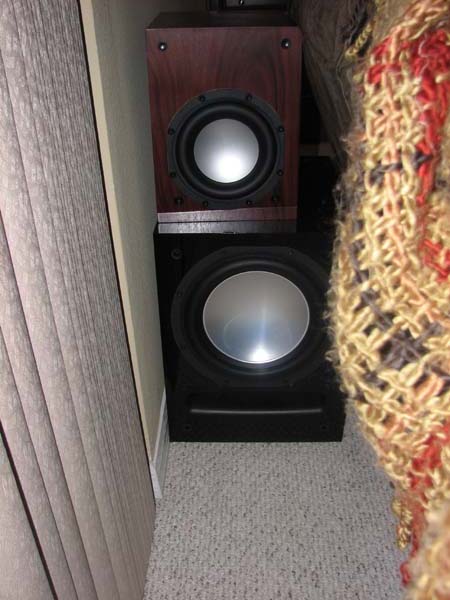

Living RoomI left my EP500 towards the left front corner behind my couch as it has been for the past 3 years. I placed one EP400 on top of it and the other EP400 diagonally located towards the back right of the room. Luckily the distance between both EP400s was relatively equal to the primary listening area making it much easier to integrate them and not have to worry about bass cancellations due to mismanaged time alignment between the two subs. I checked the phase and found they integrated best with both subs set to 0 degrees (default). I always recommend using symmetry when placing your subwoofers relative to the primary listening area.  If for some reason you can’t, then it’s usually best to average the distance between the two subs for the electrical delay in your processor and tweak from their using variable phase or EQ to better hone in your response. The electronics include the new Yamaha RX-Z7 A/V receiver, Denon DVD-2930CI DVD player, Emotiva MPS-1 7CH power amplifier, APC H15 power conditioners and a 57” Samsung DLP RPTV. All HDMI and toslink cables are Sonicwave from Impact Acoustics and all speaker cables (10awg) and interconnects are from Blue Jeans Cable.

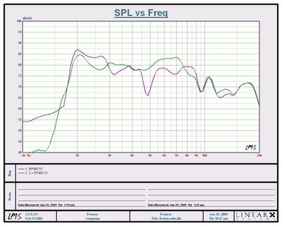

When setting up subwoofers in a home theater system, I always measure the response to ensure I am at least in the ballpark for great bass. I run sweeps using LMS or my Sencore SP495C Audio Analyzer, adjusting placement, crossover settings, phase and electrical distance until I measure the most linear response at my two primary listening positions. I tweak as needed to improve the other seats but usually if I get at least the two money seats right, the others aren’t so bad, especially with the multi subwoofer advantage.
After level matching the EP500 and two EP400s, I was ready to do a direct comparison between them integrated into my family room theater.

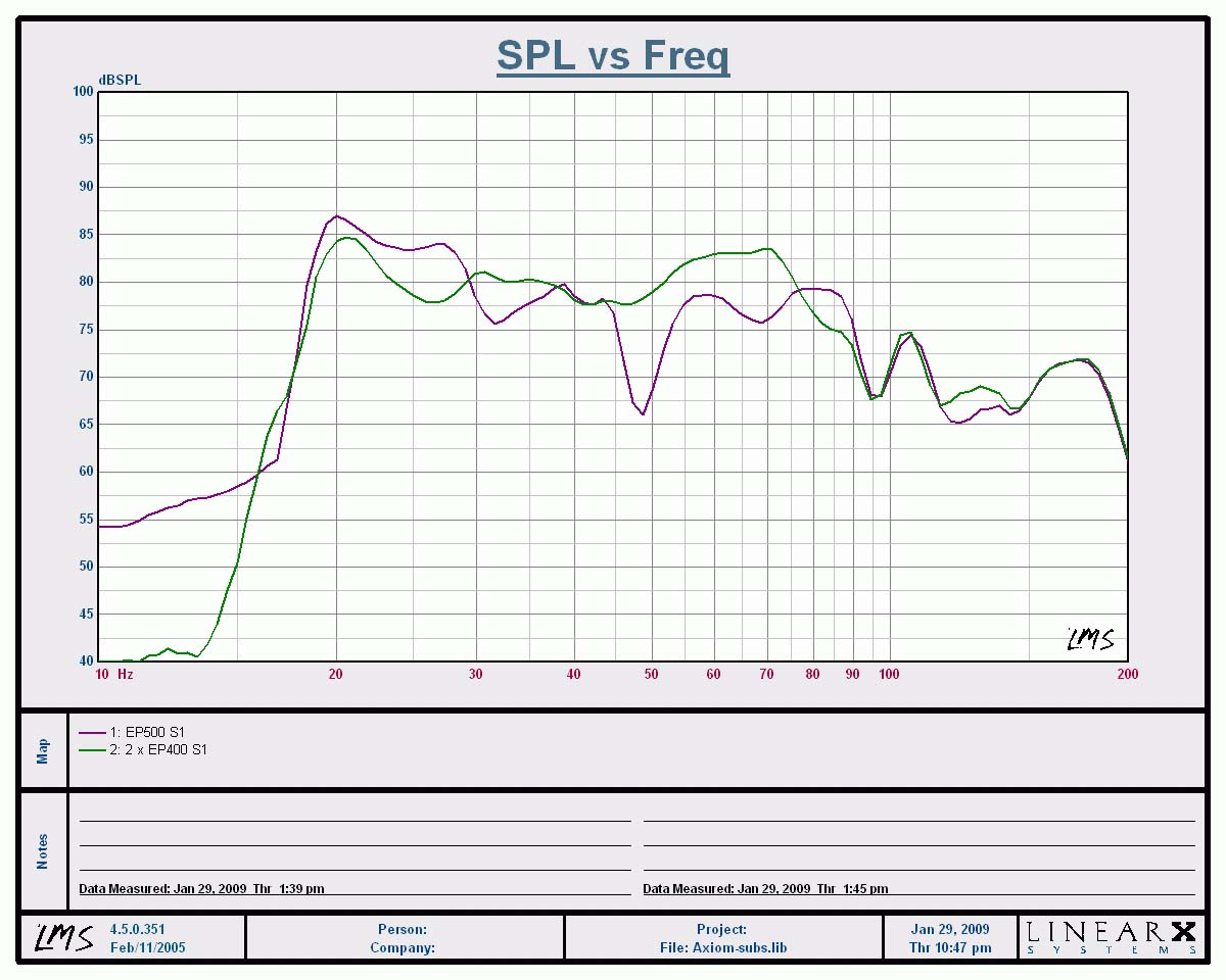

EP400vs500S1
EP500 vs 2 x EP400s at Primary Listening Seat
The purple trace represents the single EP500 while the green trace represents two EP400s. As you can see the dual EP400 response is much more linear across the entire frequency range. Gone is the 10dB suckout centered around 48Hz. This is a fairly narrow suckout with a Q roughly 4.8 so it’s possibly audible and really only fixable with multiple subs rather than EQ’ing. On the downside, some output was lost in the 25-30Hz region going from the EP500 to the 400s but the response was much flatter as well. Looking at the overall response of the EP400s you will notice an in-room bass response of 20Hz to 90Hz +-3dB. Not bad considering no electronic room correction was used to optimize the response.

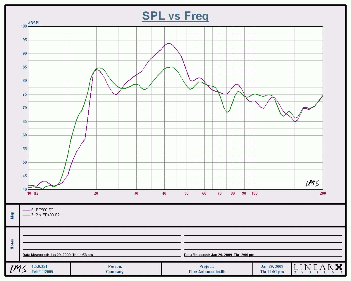

EP400vs500S2
EP500 vs. 2 x EP400s at Secondary Listening Seat
This is the mother-in-law seat we discussed earlier. As you can see in the purple trace, the bass response of a single EP500 at this listening position suffers a huge 12dB low Q (1.7) peak centered around 42Hz. This is clearly audible at that seat and makes the bass sound very boomy and muddy. While this could be tamed a bit with EQ, I’d risk adversely affecting the other seats since it’s a rather drastic problem needing a lot of cutting to resolve. The best solution of course it adding a second subwoofer as can be seen in the green trace via the dual EP400 subs. This response is much better and certainly far easier to optimize via EQ than the purple trace is.
Because I wanted to directly compare the audible sonic differences between the single EP500 and dual EP400s on the fly, I did not create a customized EQ response for both. As a result, my listening tests were conducted at the two listening positions measured above with no further changes.

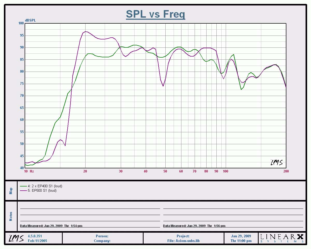

EP400vs500 Loud
EP500 vs. 2 x EP400s at Primary Listening Seat LOUD
I was curious to see how the response between these subs changed at high SPL levels so I turned it up to near house shaking levels in my room. It’s rare we ever listen to higher sustained levels except perhaps during big party events which most of our guests are usually a bit too buzzed to take notice of the bass response. You can see the limiting the EP400 is doing below 28Hz to keep things clean and distortion free. To look at it another way, the bass response is only shelved down 4dB below 28Hz at these high output levels to match the rest of the bass spectrum. This is a very smooth and linear response.
