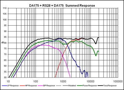

- Specifications
- 32Hz (vented) or 50Hz (sealed) - 20KHz
- Anechoic sensitivity 84dB/2.83V

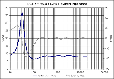

- 6 Ohm load nominal
- Crossover 1500Hz
- Max 50Hz SPL, 103dB Excursion limited
- Max 100Hz SPL, 112dB Power limited
