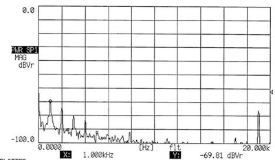

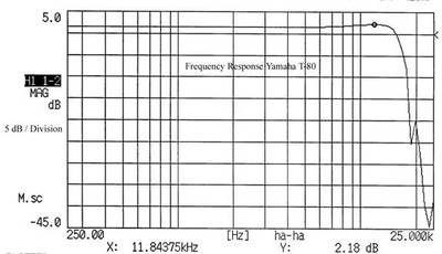

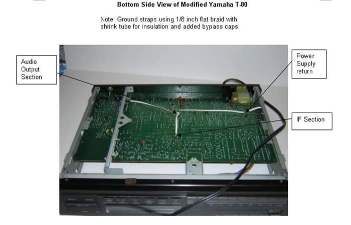

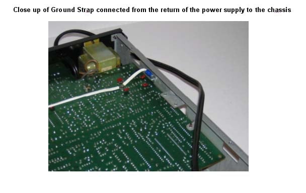

After all the electrolytic capacitors were replaced I did add some 0.1uf film bypass caps in the power supply and added some 0.01uf ceramic bypass caps in the RF section. To do this; simply solder the bypass caps directly across the electrolytic capacitors. Most consumer units of this era did NOT have these in their units to start with. Once this was completed I went back to my original supply pins on the output op amp and found a 9 db reduction in ripple and approximately 18 db reduction in broadband noise.
A few words of caution to the DIY folks on electrolytic capacitor replacement: The first instinct is to increase the capacitance for better filtering. The problem with this is that surrounding design may NOT be able to handle the surge currents of larger capacitors and cause premature failure of rectifier diodes, pass transistors, and force a transformer into saturation. I would also like to note that on the + 12 volt rail I found the ripple was down to 1 mV p-p and the –12 volt rail was less than that after doing the electrolytic capacitor replacement.

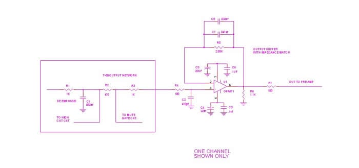

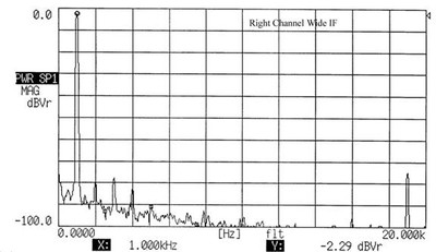

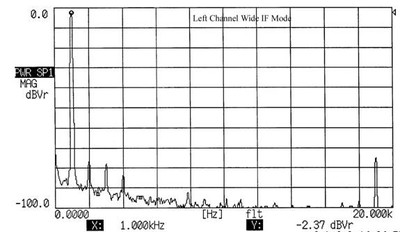

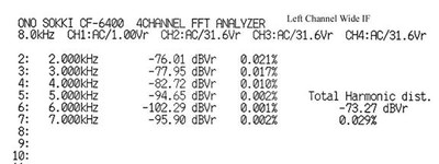

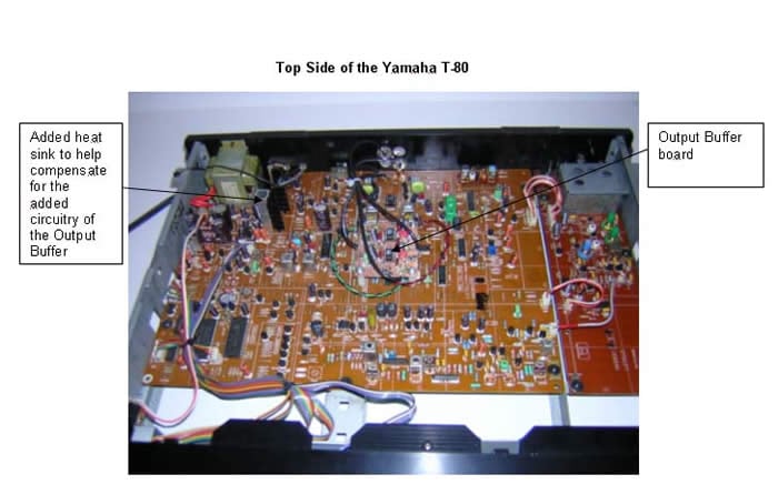

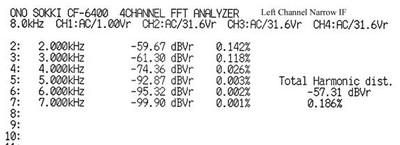

My next step is to replace a good portion of the carbon film resistors in the unit. The carbon film resistor is typically the dominant source of thermal noise in audio circuits. Metal film resistors have much lower thermal noise. I proceeded to replace all of the carbon film resistors in the audio output circuit, multiplex circuit, IF filter section, and the bias resistors for the pass transistors in the power supply. To ensure accuracy I measured each resistor just to be sure I was reading the color code correctly and replaced each resistor with the equivalent value metal film resistor. The reduction of thermal noise is very audible to most folks and as the spec’s will show a real difference in the S/N ratio. In addition I replaced the JRC 2041 dual op amp with an OP275. An OPA2134 will work just fine in this application too.

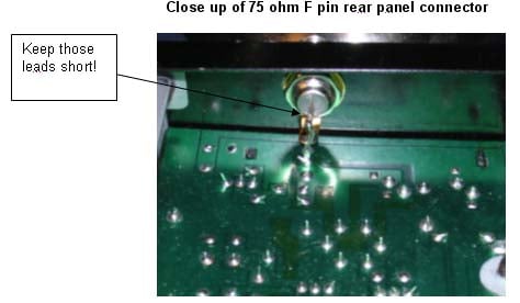

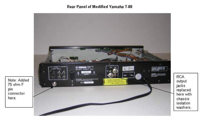

Now that I have completed the basic restoration and noise reduction of the T-80 tuner it’s time to start on setting up a decent antenna. An outdoor rotating antenna would be the optimum choice here, but my present living circumstances are not going to allow that. I am not a DX guy as my major goal is to get decent reception from the many Boston area radio stations. A friend of mine who had come to visit recommended using the attic, which has enough space to put in a 4 element Yagi. I presently live about 15 miles up the coast from Boston so mounting a small Yagi from Winegard (Pro 6000), http://www.winegard.com/offair/pdf/pr-6000.pdf seemed like an acceptable alternative to the standard FM dipole. I spent a few evenings on antenna placement and found the following. Just about anywhere in the attic with antenna pointed toward Boston gave me about the same results. Even with an extra 37 feet of RG 6 added I found no real difference monitoring the signal quality meter and the multipath meter. I got the RG6 I am using at Home Depot. I also did a search through the Belden Master Catalog and found that RG6 typically has an insertion loss of 2.5db for every 100 ft. at 100 MHz. I am presently using about 32 ft. so that gives me just under 1db of loss from the antenna. The only spot where I had problems was near the chimney. The antenna itself was very inexpensive. The cost from Lashen Electronics in New Jersey was about 47.00, which included the mast and Balun to convert the 300 ohm antenna to 75 ohms. The antenna is extremely light so body building is not required for placement. The shipping cost came to about 35.00 due to UPS claiming it was an oversize package. UPS also managed to nearly destroy the cardboard packaging but the antenna itself was not damaged.
The final result confirms the age old RF truism: “There ain’t nothing like a good directional antenna to boost signal quality and reduce multipath.” Multipath distortion has that real grinding quality to it that all of us could do without. Lowering multipath should be of primary concern when placing an antenna. Fortunately the Yamaha T-80 has a multipath meter to monitor this when you placing the antenna.
