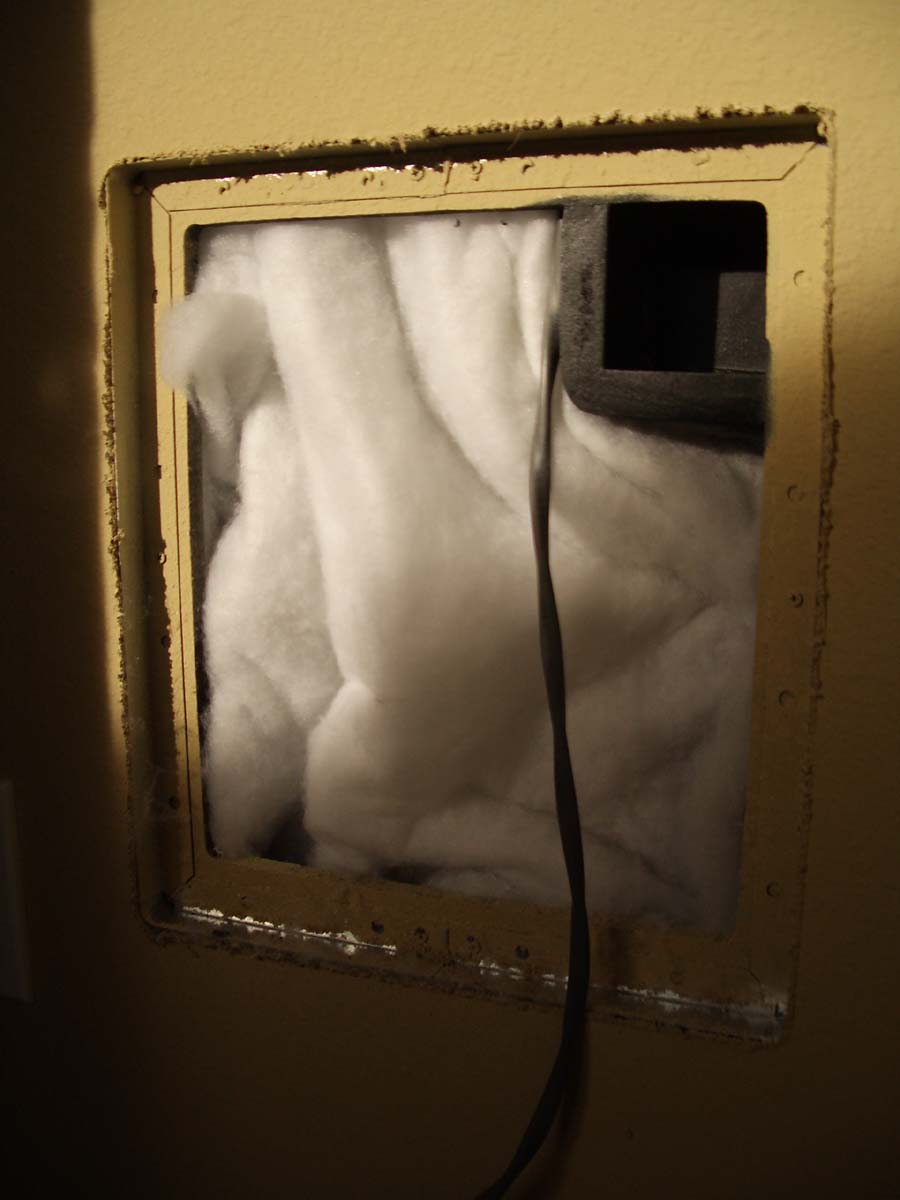

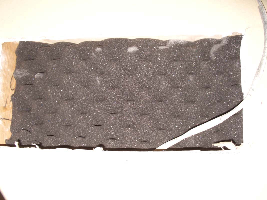

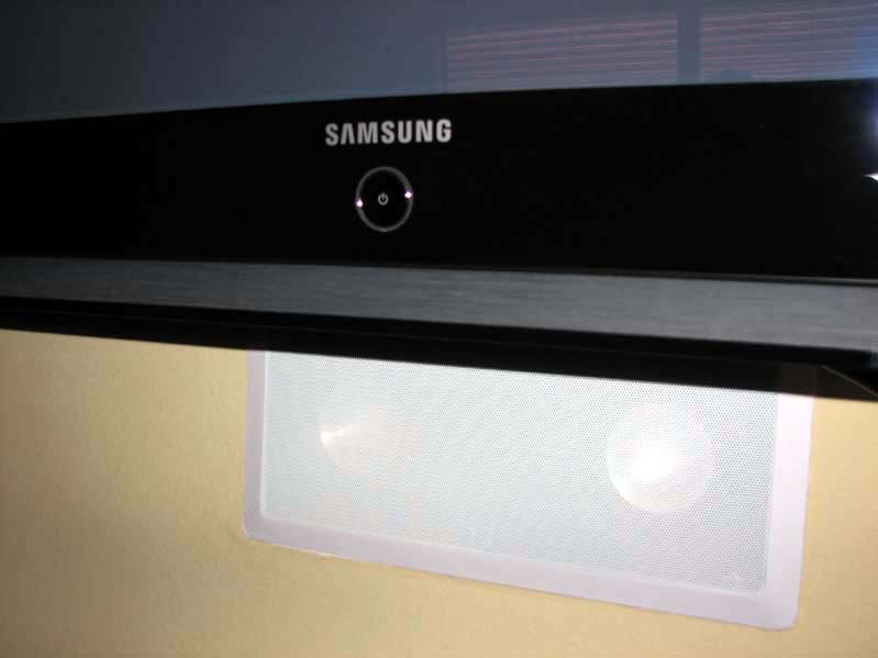

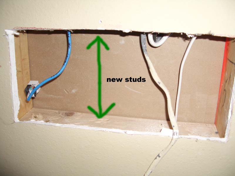

OK, so you’ve picked the speakers, marked off their locations on the walls, and cut out the drywall using the supplied template from the manufacturer as a guideline. DON’T follow their next step of simply connecting the speaker and popping it into the wall. Instead consider creating a pseudo back box like I did using 2x4s and some insulation. Since you are installing the speakers between two studs (usually 14” on center), you can use those as the sidewalls. All you need to do now is cut two pieces of 2x4s to wedge between the studs and serve as the top and bottom of the back box. I went one step further and secured them with wood screws and some clear caulking to ensure they wouldn’t rattle or come loose over time.
Editorial Note: Make sure you pre-drill holes in the studs for the speaker wire else you won't get very far when you crank up your system to enjoy some tunes.
You now have a sealed enclosure for your in-wall speaker. If you want to get even fancier, you can tack on ¼” plywood to serve as the back of the cabinet bay but it’s not an absolute necessity. The drywall will work reasonably well, especially if you stuff the cavity with some Dacron or standard insulation.

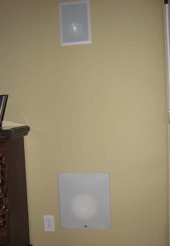

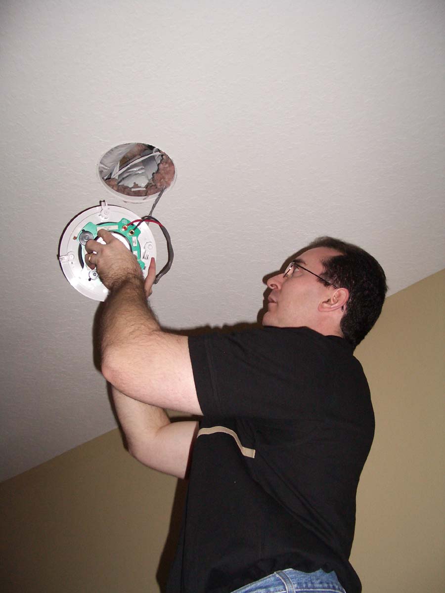

in-ceiling installUsing the manufacturers supplied template as a guideline, cut out a circle in the proper ceiling locations where you intended to place the surround speakers. If you are doing 7.1, I highly recommend utilizing in-wall speakers for the side channels and in-ceiling speakers for the back channels. I have found this to be an incredibly good combination that provides excellent envelopment while at the same time remaining quite musical to take advantage of Dolby Prologic IIx Music Mode.
My ceiling spaces were heavily insulated making a back box somewhat less of a necessity, especially since the sound doesn’t really bleed over to an adjacent room. But, for better acoustical control and sound isolation, I strongly encourage you to inquire about a manufacturers back box (usually in the form of an insulated metal can). In order to eliminate any possibility of baffle to ceiling vibrations, I recommend lining the diameter of the speaker frame which connects to the ceiling with caulking prior to screwing it into the ceiling. Be especially careful to not get any caulking on the cone of the driver.

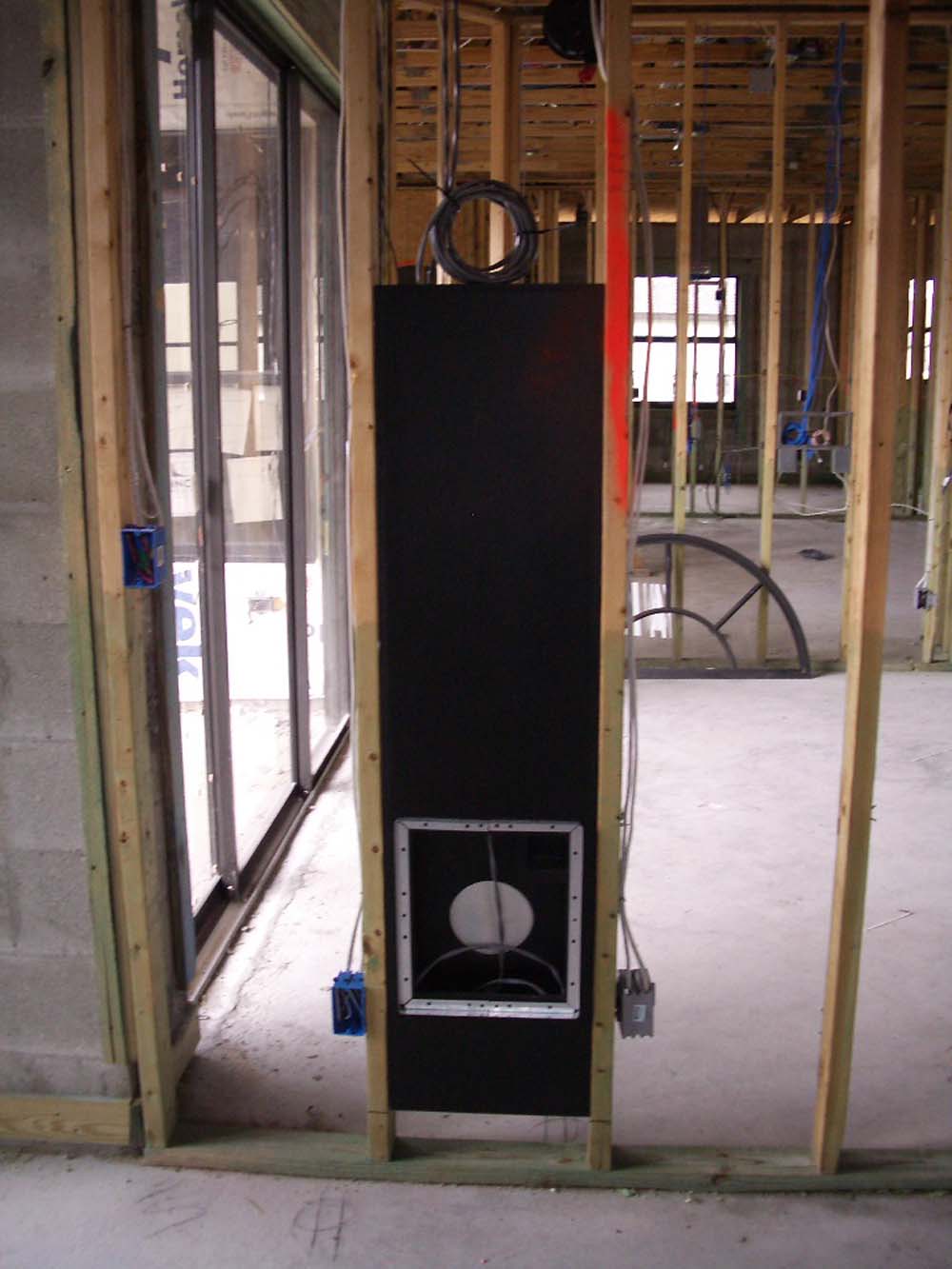

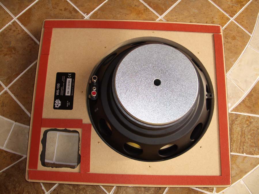

I got lucky here as I had access to the Audioholics Showcase home before drywall was put up so I installed a pair of RBH Sound SI-10 enclosures between my stud bays. Using an epoxy glue, I lined the sidewalls of the RBH enclosures and the adjacent stud bays I was mounting them in. I then used wood screws on the inside walls of the RBH enclosure and drilled them into the stud bays every foot or so. Once the screws were in place and the glue dried, these cabinets became a permanent fixture to my home.
SI-10 SI-10 stuffing SI-10 Driver
RBH Sound Signature SI-10 In-wall Subwoofer
If you are installing a free air in-wall subwoofer, I again encourage you to find out if the manufacturer offers a retrofit back box you can install after the drywall is already up. Otherwise, follow the guidelines I laid out when installing the Front LCR speakers and you should be good to go. An enclosed space (even if its not the optimal box volume) is usually a better option than operating a subwoofer driver in free space as it increasing power handling, provides better noise isolation into adjacent rooms and also provides much improved mid bass output which is critical in achieving a good subwoofer to satellite speaker blend for seamless integration.
