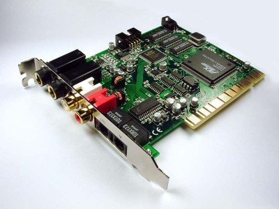

Well sound cards manage to take the SPDIF out of the CD ROM drive and process it correctly so I go searching for something appropriate to my needs. My needs are pretty simple as I am only interested in the digital section, and really have no need for an analog section, besides, I can’t think of only one worse place to do sensitive analog than in a computer, and that would be a radar transmitter. The market, however, has a different opinion. I consulted with folks who are more in the know than I am on this subject as was told to stay away from the consumer issue stuff as they had a tendency to convert the sample rate and sometimes the bit rate, and besides I am also not interested in, at this time, in all that analog for a 5.1 or 7.1 system.
So it’s on to researching the pro audio sound cards, which is a dizzying process, as they have more capabilities than I can possibly use at this time, and deal with issues that I have no plans on encountering. Yes folks, the recording world has much different needs than this old fart who just wants some decent playback. After hours of combing through web sites that give insufficient data I finally get some answers from the folks at Marion Digital Audio. I bought their Marc 2 sound card as it appeared to have a decent digital section, with actually more capabilities than I really can use at the moment, and their rep got me some info that was not on their web site. The card uses the CS8427, as probably many do, which is a digital transceiver. The jitter attenuation is respectable but not great, and the RCA SPDIF inputs and outputs are transformer coupled to isolate the ground connections. I consider the transformer coupling of high importance as computers are not noted for having the “cleanest” of grounds. There is also a connection on the card for the “SPDIF” out of the CD ROM drive. The card also has optical SPDIF inputs and outputs, and analog inputs and outputs.
Sound Card
Marion Marc 2 Sound Card
I get the card and plug it in to the PCI slot, and proceed to load the software. I naturally get it wrong the first time and come up with the German language version. I manage to get it right the second time and I pop in a CD. Lo and behold, no error light flashing on and off, and the DAC is locked at 44.1 kHz.
This is looking good, and it’s sounding good too. In a quick A/B comparison I think there’s a very small difference between the computer drive and the CD transport, but testing like this is at best difficult as the similarities far outweigh the differences one might perceive initially.

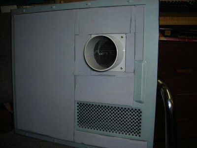

Quieting down the acoustic noise of the computer is another challenge, and one that I am still working on. My “new” computer with Dual Core CPU runs pretty cool if one can believe the monitoring software, also the large copper heat sink with heat pipes and a low noise fan will help here also.

I purchased low noise fans for the rear of the computer case, also shown in the photo above and the front of the case. I also purchased gaskets that go between the fan and the case to reduce vibration. In addition I installed some “acoustic foam” with its own adhesive backing on the inside of the both of the side panels, top panel and bottom panel. All of this does help, and I do need to get a noise reducing hard drive enclosure, but even though the acoustic noise has been reduced I still consider this the only drawback to implementing this system. They do advertise such things as very low noise computers, but they also come with an interesting price tag.
Noise Foam Side Panel
Noise Reducing Acoustic Foam on the interior of a Side Panel
