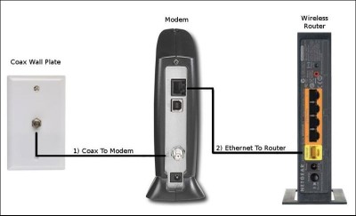

1 & 2) Connect the modem and router
The key to successfully setting up a network is to hook up and power on devices in the proper order. First, connect the coax cable (or phone cable for DSL modems) from the wall to the modem. Second, connect an Ethernet cable from the modem to the “WAN” jack on the router. This jack might also be labeled “Internet” and/or be colored differently than the other Ethernet plugins on the router.
Steps 1 & 2
Editorial Note: Remember that if you have a wireless gateway (i.e. a modem with built-in wireless) then you do not need a separate router. In fact, you should not try to use a separate router combined with a gateway without advanced knowledge of home networks, particularly the functions of DHCP. If you have a gateway, simply connect the coax or phone line to it and power it on, wait a few minutes, and skip to step 5.

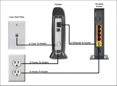

3 & 4) Power on modem then router
Connect the power cable from the wall to the modem. The modem will take a few minutes to fully start up. On the front of the modem should be a light labeled “online”, ensure that it is solid before proceeding. If you can’t find that light, just wait a few minutes for the modem to start and connect to the Internet. Next, connect the power cable for the router. Again, wait a minute or two for it to start up completely. Some routers have an “Internet” light that will turn solid once it’s started. As always, you can consult the product manuals to find out what the various lights mean.

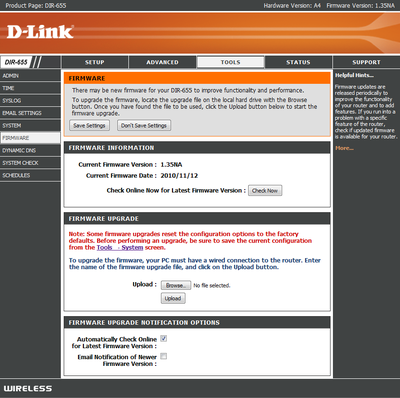

6) Update firmware
Updating the firmware on a router can fix major and minor flaws, as well as add new features. It should always been done when setting up a router. Additionally, If you ever experience weird issues in the future, you should check to see if the firmware is the most current version. Good manufacturers continue to update the firmware for their routers for a long time after the router is no longer in production.
D-Link DIR-655 Firmware Upgrade Screen
The firmware setting is buried in a slightly different spot in the menu of each router, so you will just have to poke around a bit. It’s often under an “advanced”, “admin”, or “tools” tab. After locating the firmware section, you will need to determine if it already has the most recent version installed. Also, don’t assume that just because it’s a new router it has the newest firmware.
Some routers will have an “automatic” option that will check for, download, and install new firmware. For those not so lucky, you will need to download the newest firmware from the manufacturers’ support site and save the file somewhere on your computer (here are links to the support sites for some major manufacturers: Linksys, Netgear, Belkin, D-Link). I normally save files to the “Desktop” to make them easy to find. Once you have downloaded the proper firmware, use the “Browse” button in the router setup page to find and select the file. Once the firmware update process starts, do not do anything! Let it run its course. The router will likely take a few minutes to reboot. If you interrupt this process you can ruin the router. Once the firmware is updated, you may have to log back into the router.
If you are having trouble with the firmware upgrade process, don’t sweat it too much. You can just move on to the next step. However, if you ever start to experience unexplained issues in the future, it’s very possible that outdated firmware is the culprit.

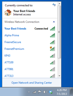

7) Set wireless name/SSID
Every wireless network has a unique, customizable name, also called an SSID. When your computer shows you a list of all of the available networks, you’re seeing the SSID (name) of each network. In the image below, you can see a list of available networks as displayed on Windows 7. You need to decide on a network name that is different than any other networks in your area, but remember that this information is public. This is not a password. Avoid using a last name or any other information that could identify you, like your address. Try something generic, like a sports team or hobby. Avoid using any special characters, and stick to letters or numbers. Also avoid making it unnecessarily long. A good SSID would be something like “Vikings Fan” or “North Dakota Rocks” (got to represent my home state). In the image below, the name of my wireless network is “Your Best Friends”.
Network List
If you are setting up a dual band router, you will see an SSID option for each network. Do not use the exact same name. I typically keep the first part of the SSID the same and then add “5g” at the end of the SSID for the 5 GHz network, and “2g” or “2.4g” at the end of the 2.4 GHz network. For example, the two networks might be “Vikings 2g” and “Vikings 5g”. Once you have decided on a name, save the network settings. Your router might take a few moments to update.

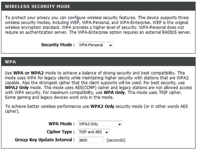

8) Set wireless security
Next, we need to set up security on your network for two reasons. First, to keep unwanted guests from logging on and using up your bandwidth. Second, to keep people from eavesdropping on your network activity and stealing important data. Just like there are different wireless protocols (remember 802.11g, 802.11n, and 802.11ac?), there are different security options. WEP used to be used most often, but it is easily hacked and should be avoided. The next best option is WPA, which is far more secure than WEP. However, WPA2 is the newest and preferred security option. It might also be called “WPA2 – AES” in your router setup screen. Simply select it as the security type. While you're poking around the security settings we recommend disabling WPS. It allows you to connect equipment to the network without actually knowing the password, a cool feature designed for convenience. You click the WPS button on the router, then the WPS button on the device you want to connect, and presto, it's connected to the network. Super convenient, right? Yes, it is, but unfortunately it has well document security flaws as well.
Next, you need to choose a password. It can be between 8 and 63 characters. You can use a combination of uppercase and lowercase letters, numbers, and special characters. While a longer, more complex (or random) password is better for security than a short, simple password, it can also be more difficult to remember. It can also be a pain to enter in. I would recommend at least using one uppercase letter and one number in your password. Avoid using easily guessable phrases, and swapping out letters for numbers, for example, “3” in place of “E” is not very effective. No matter what you choose as a password, write it on a scrap of paper and tape it to the router. If the password is so easy you are positive you can remember it in 6 months, it’s likely a low quality password.
Editorial Note: Some old devices will not work with WPA or WPA2. If you have an old device that won’t connect after setting up your router with WPA2 security, try changing the security to WEP, or simply turn off all security and then try to connect the problem device again. If it connects, then we know the connection problem was related to WPA or WPA2 security. I would recommend upgrading the wireless card in that device or hard-wiring it to the network. I would NOT recommend compromising the security of the entire network just for one outdated device.
