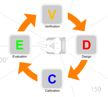

The Process Circle - Evaluation, Verification, Design, Calibration
Once the preliminaries were out of the way, the TurboCal course jumped into the iterative process. This process has always been part of the HAA, but the TurboCal course clarified it much better. This section can be summed up as "Evaluation-Verification-Design-Calibration". It is important to understand this process as a circle because once the calibration has been completed, the evaluation has to be done again and the circle continues until you are satisfied with the results.
Just because a custom home theater installer has this sort of business doesn’t necessarily mean that they understand how to listen to a system and properly evaluate its qualities. Evaluation is a very important first step and learning the Sonic Goals is paramount. Clarity, Focus, Envelopment, Dynamics, Consistency and Response are the Sonic Goals. I will touch on these concepts shortly.
