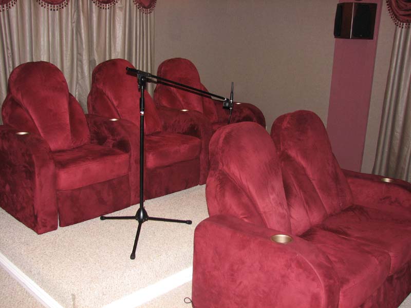

If you’ve got a multi row theater room, you’re probably wondering what the best method of calibration would be. Setting channel trims and delay settings properly are paramount to ensuring good sound quality, but at what seated position should they be set too?
In my situation, I have a two row theater and I am a firm believer in following the THX mantra of making “all seats good seats” instead of calibrating to one money seat like so many often do.

Mic CalibrationFirst, I recommend calibrating your system somewhere at the midpoint between both rows. Next, using an analog SPL meter (set to slow response, c-weighted) check the SPL of each speaker at the primary front row position and the primary back row position. Now it’s time for the compromise.
Editorial Note on Microphone Position
Make sure your mic is pointing straight up and is not being obstructed by the sofa backseat. If needed, recline your sofa to avoid it being in close proximity of the microphone.
Remember the goal is to have a center channel that’s a bit hot in the front row, while the surrounds aren’t overpowering in the back row. Thus, I suggest boosting the center channel about +1dB hot at the front row while knocking the side surround channels down .5-1dB and the back channels about -2dB all relative to the front channels.
Now measure the back row primary seated position. Depending on the distance between your two rows, you should observe the center channel to be about 1-1.5dB too low, the side surrounds around 1dB low, and the surround back channels about 1 -2 dB hot. Make sure none of the four surround speakers measure higher than +1.5dB relative to the front channels and the center channel is no less than 1.5dB lower than the front channels. Tweak the adjustments as needed to attain this goal.
Important Note: Try to keep the distance between both rows so that the target response is to be within +-1.5dB for the center and surround speakers relative to the front main speakers for both rows.
Set the channel delays based on that midpoint distance between the two rows previously discussed. Now do some listening tests of 2CH and multi channel sources in both seating areas to determine if you like the end result or if you need to tweak a bit further.

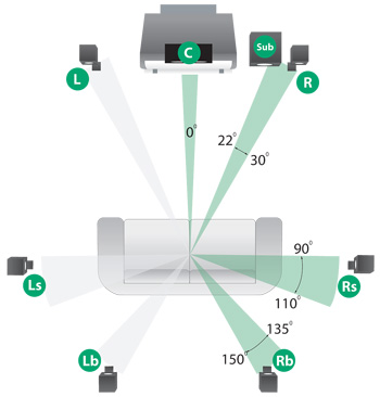

Speaker PlacementThis article assumes you have optimal speaker placement already worked out in a similar configuration as this diagram. Before one can engage in proper home theater calibration, it’s important to choose the right speakers for your room as well as the optimal location. Check out the related links at the end of this article for more relevant information on this topic. If you pick your equipment carefully and set it up and calibrate it properly, you will be on the right path to building a home theater that will rival most of the local Cineplex’s so you and your company can equally enjoy that great movie theater experience in the comforts of your own home.
