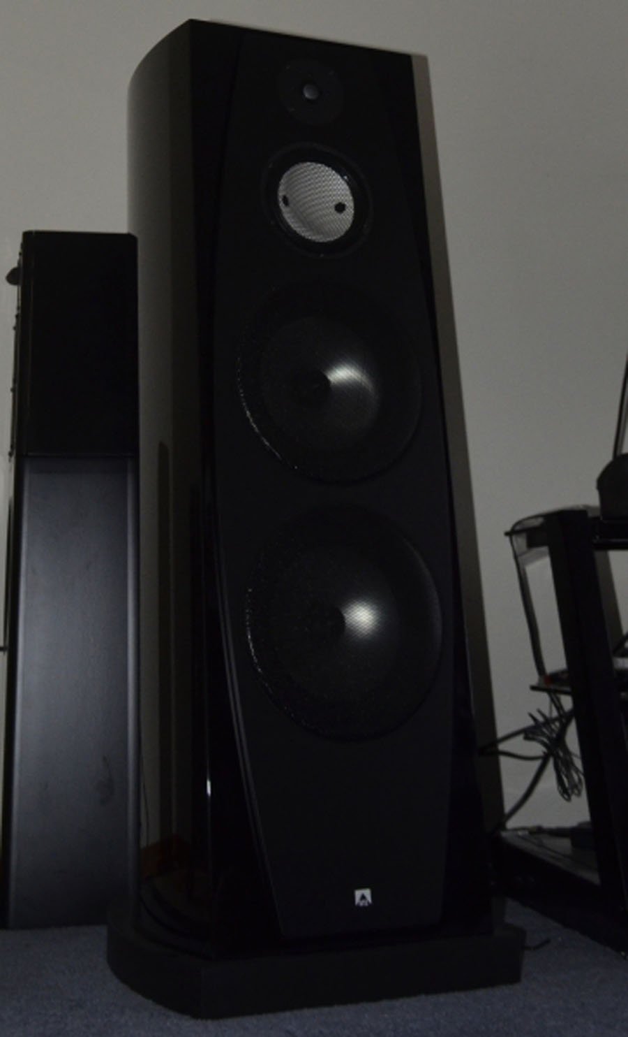

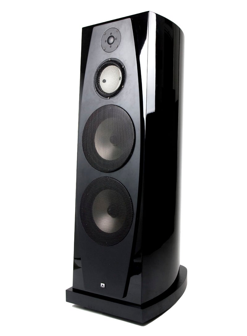

When the Divine towers first arrived, my initial reaction was “Oh boy, what have I gotten myself into?” As a somewhat pricy speaker, I knew these were going to be pretty big and heavy, but I underestimated just how high XTZ was aiming. Shipped via freight in boxes that closely resemble an elevator in size, simply carrying these to my listening room was an exercise in, well, getting exercise. The next step was getting the towers out of their boxes, and that too, was quite the task with my ten foot ceilings requiring all sorts of contortion and angling precision to slide the boxes out. But with some much-needed help, I pulled it off and got things set up. An array of floor and carpet spikes were included to adjust the angle, intended for the end-user aim the tweeter at the listening position.
The Divine  towers have a show room finish befitting a pair of $20-30k speakers.
If you saw the Divine Towers on the showroom floor of a typical audio store, you would not be remiss to assume that they retail in the 20 to 30 thousand dollar range. That's because they hit every box on the checklist when it comes to a visually high-end design, from elegant curves, a rock-solid cabinet, fine European drivers, a quality finish, to an ambitious smorgasbord of rear panel options for fine tuning adjustment, tri-wiring, active tri-amping, and port tuning. If you're looking for a stop-gap speaker, this is not it – you could spend a year playing with this toy and still not have tried “everything” it has to offer.

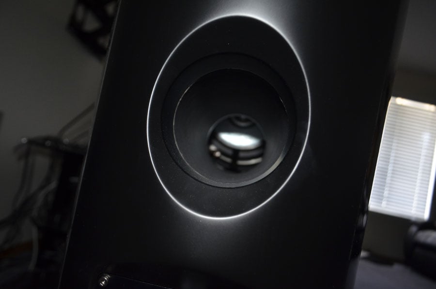

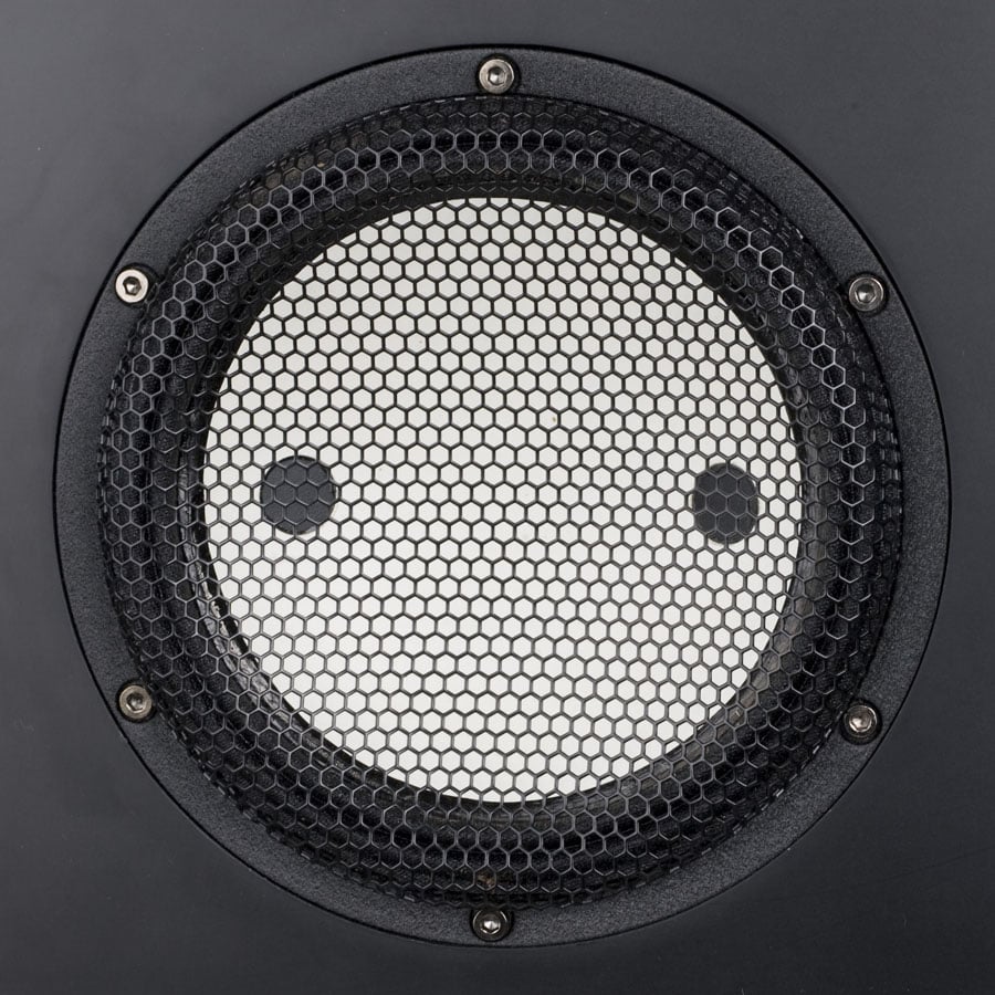

XTZDivinemidrange001.jpgUndoubtedly the centerpiece of the Divine tower is the Accuton C173-T6-90 mid-range driver. A highly efficient ceramic cone unit with a double roll surround and an elite vented neodymium motor design, it is very much among the end-all be-alls of pure mid-ranges. This is a driver alone that retails for 25 percent of the cost of the entire speaker. The tradeoff is that the tweeter and woofers are more reasonably priced units that strive to complement rather than try to compensate for the mid-range unit. In theory, this is clever design and the question then becomes whether XTZ put it all together well enough. Even if they didn't, a dedicated and knowledgeable individual could attempt an active crossover, for instance a DEQX by accessing the drivers directly – XTZ makes that option available too.

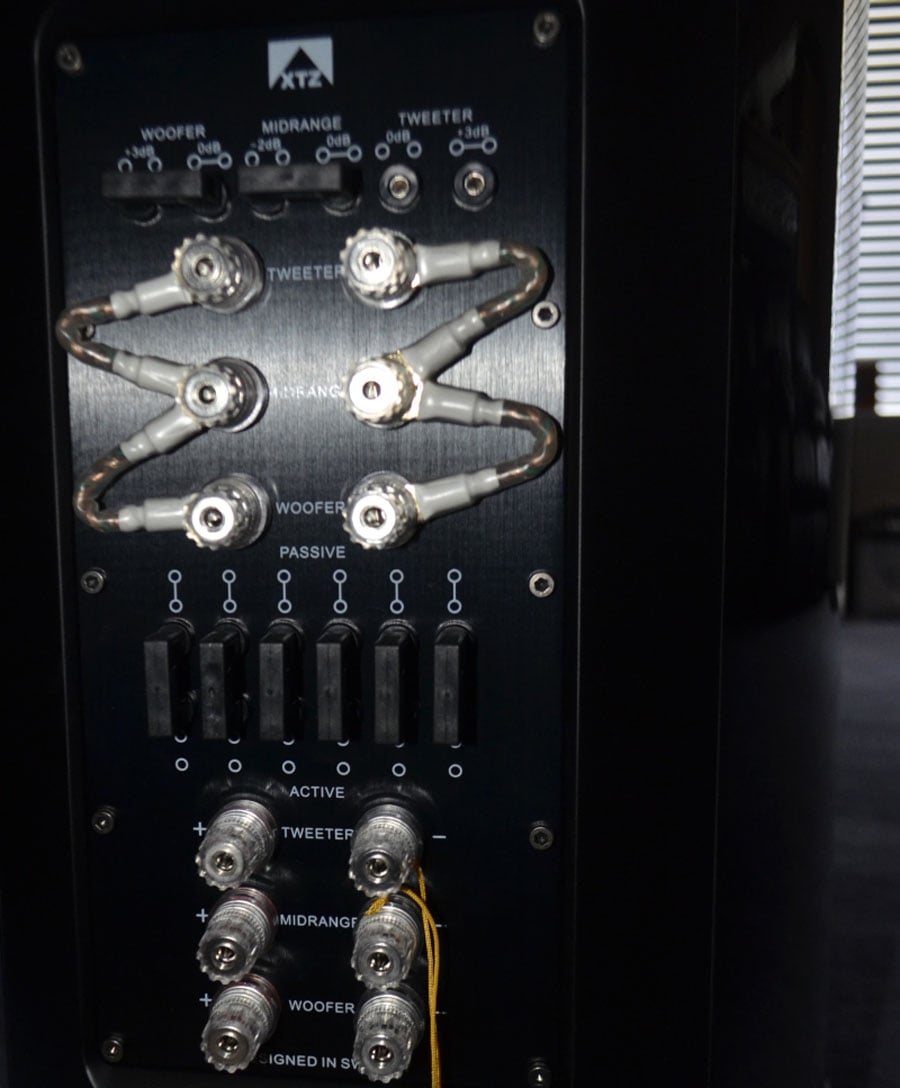

Upon finally hearing the Divine towers, my immediate reaction was that the speakers were strident in their default setting. However - I decided to try out the fine tuning adjustments and took a look at the instruction manual, which I felt could have been easier to follow. I discovered that the default setting (the way the speaker arrived) apparently has the tweeter level elevated by a whole +3 dB, and after some preliminary listening I removed the tweeter jumper, which was ultimately the setting I found to be most comfortable to listen to in my environment although I might have preferred if these adjustments had been a little more fine. The final setting I arrived at had the midrange and woofer jumpers inserted, but the tweeter jumper removed.
Rear Panel with tweeter jumper removed

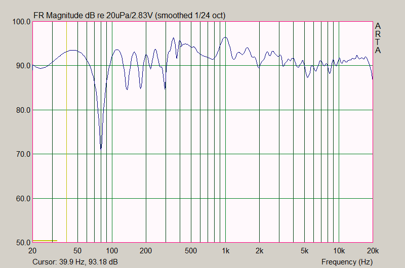

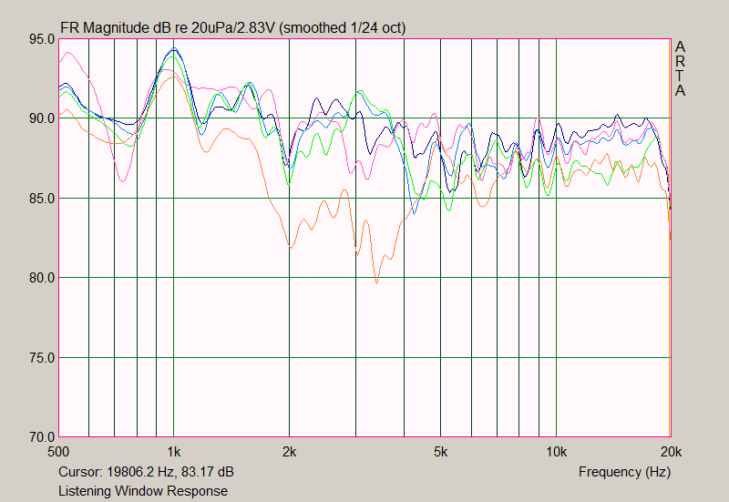

XTZ Divine Frequency Response  (in-room @1 meter)
Give or take, sensitivity of the Divine Towers sits just around 92dB/2.83v at 1 meter. On-axis frequency response from the speaker shows roughly a +/-3db variation with a general dip in the mid-treble that helped keep the speakers well free of excessive sibilants. Response below about 400 Hz contains some boundary artifacts – it was very tough for me to remove the room from the equation when measuring such absolutely massive speakers. Based on this measurement, one could expect an overall soothing, yet forward presentation. I do feel that implementing an outbound crossover could get the response flatter and the driver integration tighter than the default passive design, but you would need to find someone capable of setting it up as doing so is truly a science.
Listening window response
(in-room @ 1 meter)
The listening window response shows the general response in the forward direction at angles correlating to typical seating positions. You can identify the crossover region in the bottom curve (15 degrees vertical above the speaker) as the dip in response in the upper midrange. Give or take, the horizontal response is mostly symmetrical, as the loudspeaker layout is symmetrical. The majority of the response stays within a roughly +/- 3 dB window.

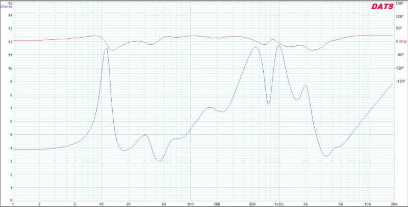

XTZ Impedance
XTZ Divine Tower Impedance vs Frequency
The XTZ Divines are a true 4 ohm load which is usually to be expected of any speaker with a dual woofer configuration, particularly a 3-way configuration. The electrical phase angle is never a problem so most amplifiers will be comfortable driving these babies – but do have the current on-tap for when it's needed. With their medium-high efficiency I got them pretty loud with my Crown Amp.

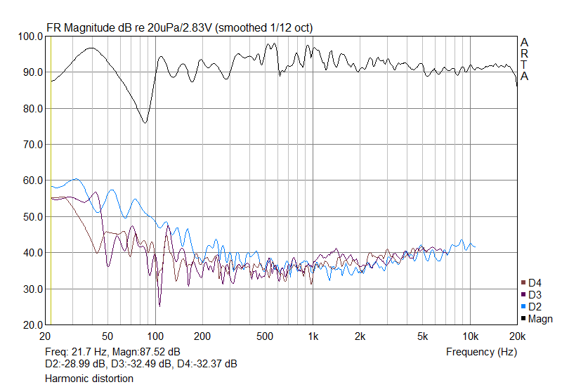

XTZ Divine Tower Harmonic Distortion @ 89db @ 2m
This is absurdly low. We are talking class-leading performance here. In fact, I don't even think these results are entirely accurate, as I suspect what was recorded was just the distortion in my amplifier as well as background noise. XTZ can pat themselves on the back for a well-engineered speaker in terms of non-linear distortion.

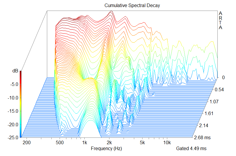

XTZ Divine Tower Cumulative Spectral Decay
CSD, or Cumulative Spectral Decay, is a three-dimensional plot derived from the loudspeaker’s impulse response which can highlight issues. There's some minor ringing in the waterfall plot, but it's very low in level. My guess is that it's from the cone breakup mode of the aluminum woofers and could only be avoided with a more aggressive crossover. This is something an active crossover could make “look nicer” but I'm not sure if there's any audible consequence to it – not any I observed, at least.
