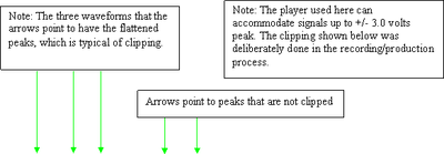

We know that if we overdrive an amplifier the amplifier will limit the signal and we typically see a flattened peak at the output. This is called clipping, and thus results in gross distortion. When we try to drive a CD player past the 0db full-scale point, two things can happen. The CD player will go into clipping just like an amplifier or some players (due to their digital filter/converter structure) can have a little more headroom above 0db full scale. If we drive them a little harder they will go into clipping also. CD players differ in one major respect from amplifiers. At 0 db full scale the player is at its lowest distortion; anything above that whether it is clipped or not results in gross distortion. The author knows of no CD player that can exceed 0 db full scale without gross distortion. If that's the case why are we seeing this happen on a great majority of recently released CD's?

This oscilloscope photo was taken from a recent Jennifer Lopez Pop CD release . The author has found this to be typical of many new pop music releases:
